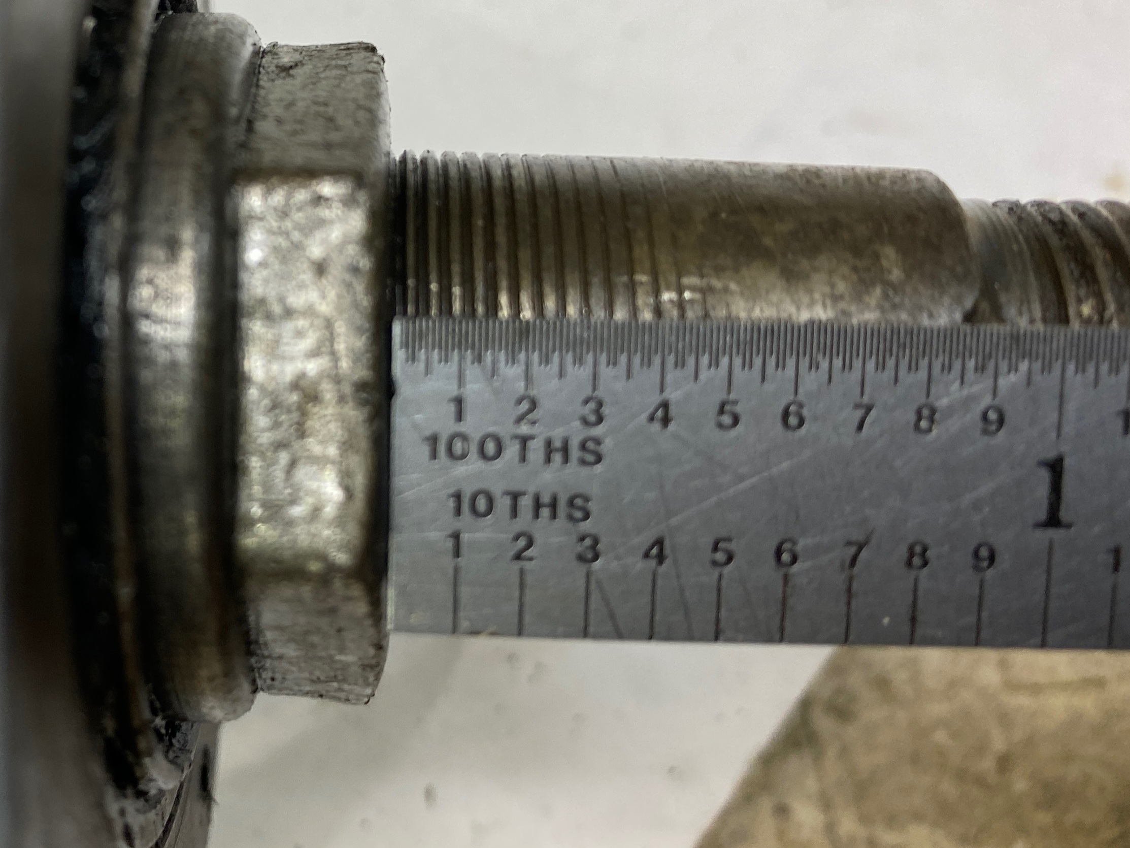

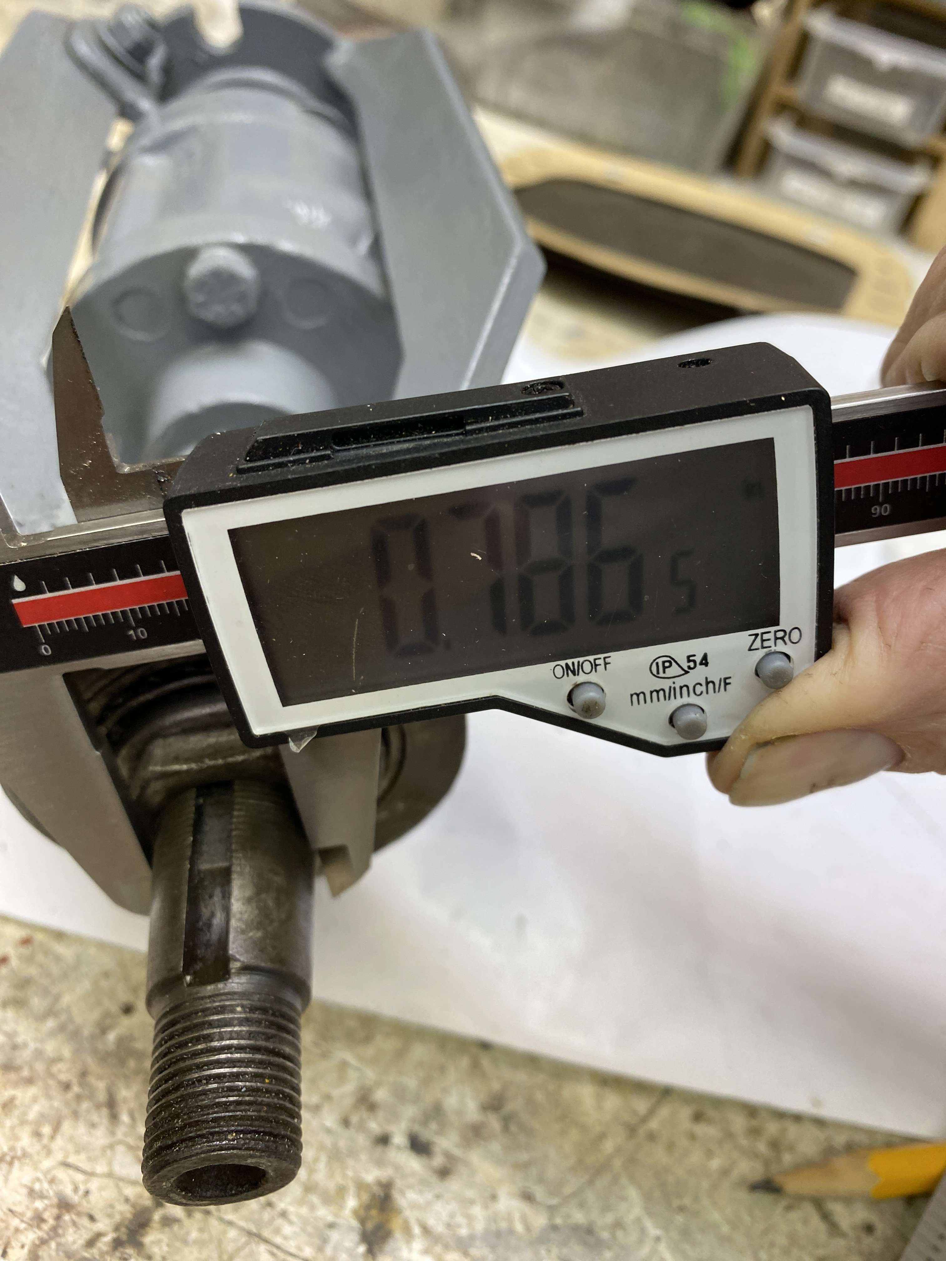

Need a nut to set the tapered roller bearing free play/preload on my Ferguson TO30 steering column. I have an order for other items ready to go at McMaster and would prefer to add it to that order rather than pay another $10-15 for shipping elsewhere. The photos show the diameter measures 0.7865, almost exactly 20mm. The other photo shows 14 threads in 0.48", about 29tpi, or 1.15mm. Could this be a M20-1.0 thread?

A look at the TO30 parts book shows 13/16"-28TPI nuts were used. This might not be exactly like yours but 13/16- 28 looks like it might be the answer. Do you have a thread pitch gauge to correctly check the thread pitch? I have seen many counted wrong when trying to count number to length, without a gauge.
