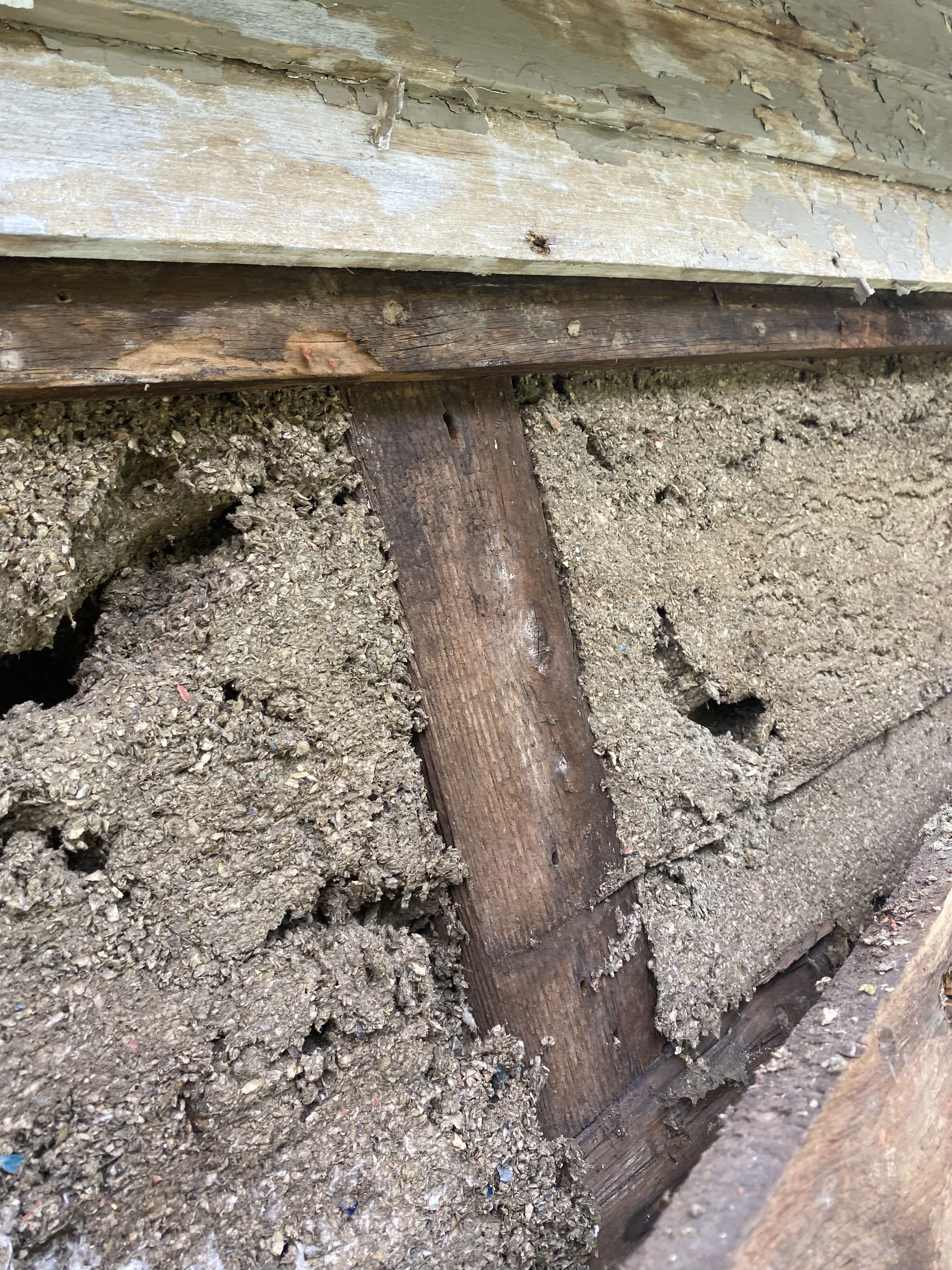

I had some exterior boards off my 160 year old house last year. I found that the mice like the blown in cellulose just fine.
