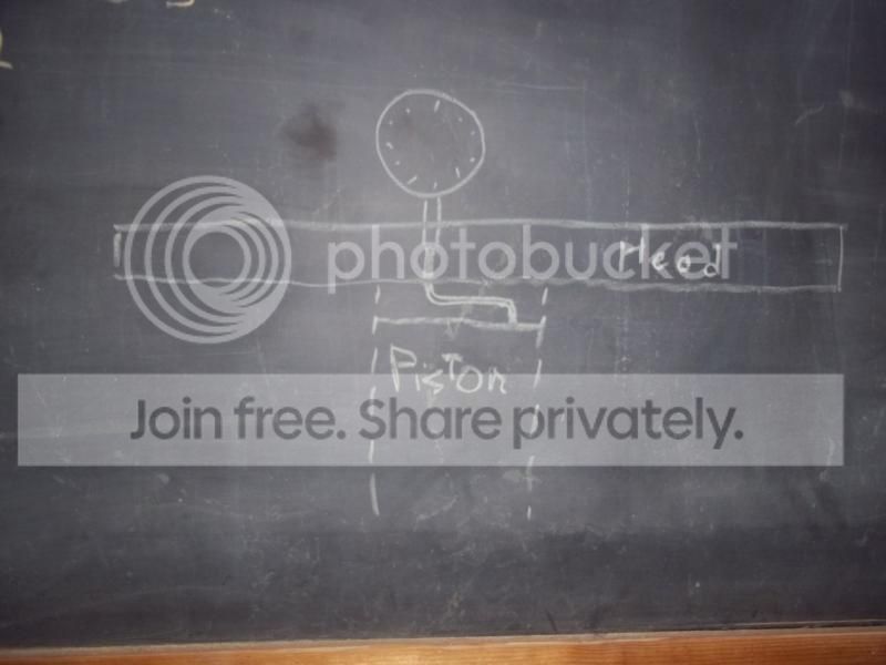

I'm building a home brew electronic ignition. And in doing so I will lose the point opening reference for setting timing. That leads me to need to create a timming mark at TDC. With the spark plug hole not above the piston I cannot use a piston staop. Ideas ?

Thinking about this again this morning and having read the other posts - which would work btw -
I guess since I already have the tool, I would bend a heavy wire and do it as shown in the photo.
The tip on the dial indicator is removeable with a standard thread so it wouldn't be hard to add the probe and make it work.
This way would allow you to chisel a timing mark on your front pulley as I explained above and time the engine accurately in the future.
I'm not saying this is the only way but it's likely how I would go about it.
It is a nice thought, but it is much tighter in there than the illustration looks & I have not even been able to get much of a "feel" on a wire thru the plug hole & onto top of piston. Seriously doubt success, but you may have better luck than I did with that.
