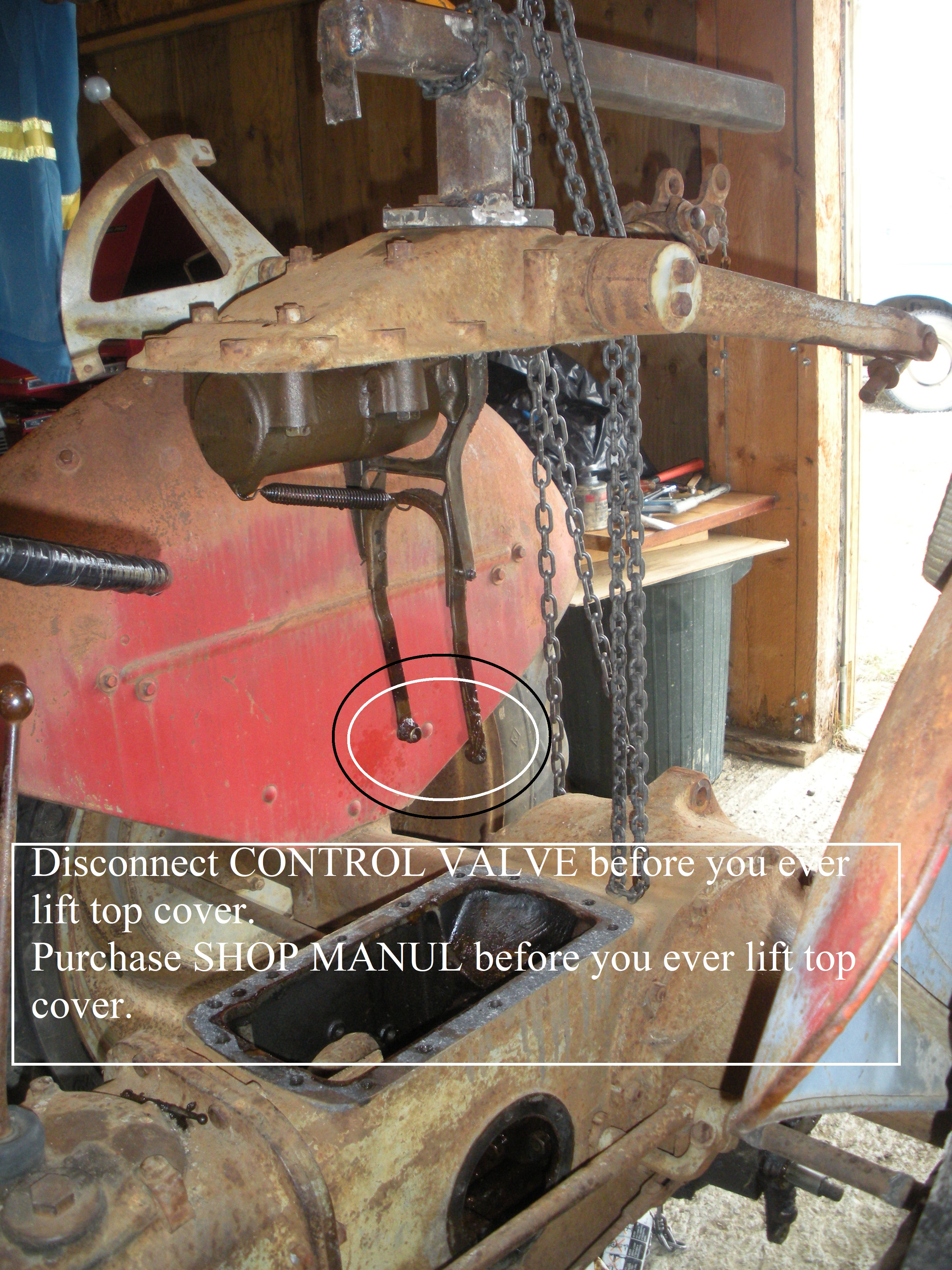

On my 2N,after removing HYDRAULIC cover,then draining all oil from the common Diff, Transs, Hyd, compartment,I added five gallons of Varsol,Inserted a 1/4" steel line into the Transmission, (Inserted tube until it was at bottom of Transmission)added 2 lbs of air pressure. Aerated the Varsol for 30 Minutes,and drained.Cleaned compartment.Then pulled Right side Axel housing,and diff assembly,then cleaned.Previous owner syndrome can give you grief.

Why would you want to use water? Oil and water don't go together. N's used a common sump for both hydraulic oil and the transmission system. Pull side inspection covers and observe condition of oil. The oil should be a clear, honey-like color and consistency. If system is contaminated with water it will be a murky-brownish/whitish color. Draining old oil and inspecting is now in order. Pulling the pump and rebuilding is an option. It is not a difficult task, but very time consuming. A total system rebuild kit will run over $500. Draining oil first is done via the three drain plugs - SEE YOUR MANUALS. Always start with the rear diffy case NPT Plug. Next move towards the front of engine with pump drain followed by sump drain. The latter two use a large 1-1/16" HEX HEAD plug and have cork gaskets that must be cleaned off amd new replaced at installation. The ENGINE CRANKCASE drain plug is on the bottom of the oil pan furthest to front so don't mix it up. Flushing the system with Mineral Spirits is best but some use Diesel Fuel or a 50/50 Mix of Acetone and ATF. Wash out several times and flush real good. Use a wet vac to suck out old fluid. Trans/hyd oil filler port is on the top shifter cover. Refill with new SAE 80 or ATF Oil. Capacity is 20 Quarts (5 Gallons) but don't pour it all in at once. After rebuild, go slow with 2-3 gallons and test for any leaks. Overfilling will cause a mess.
