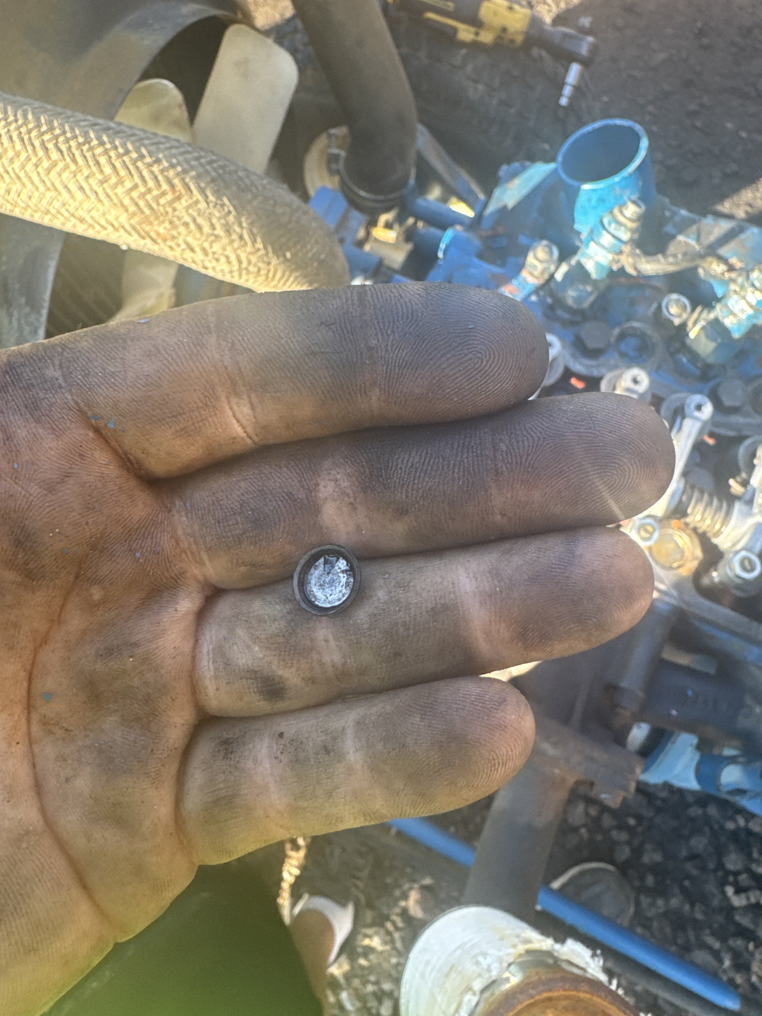

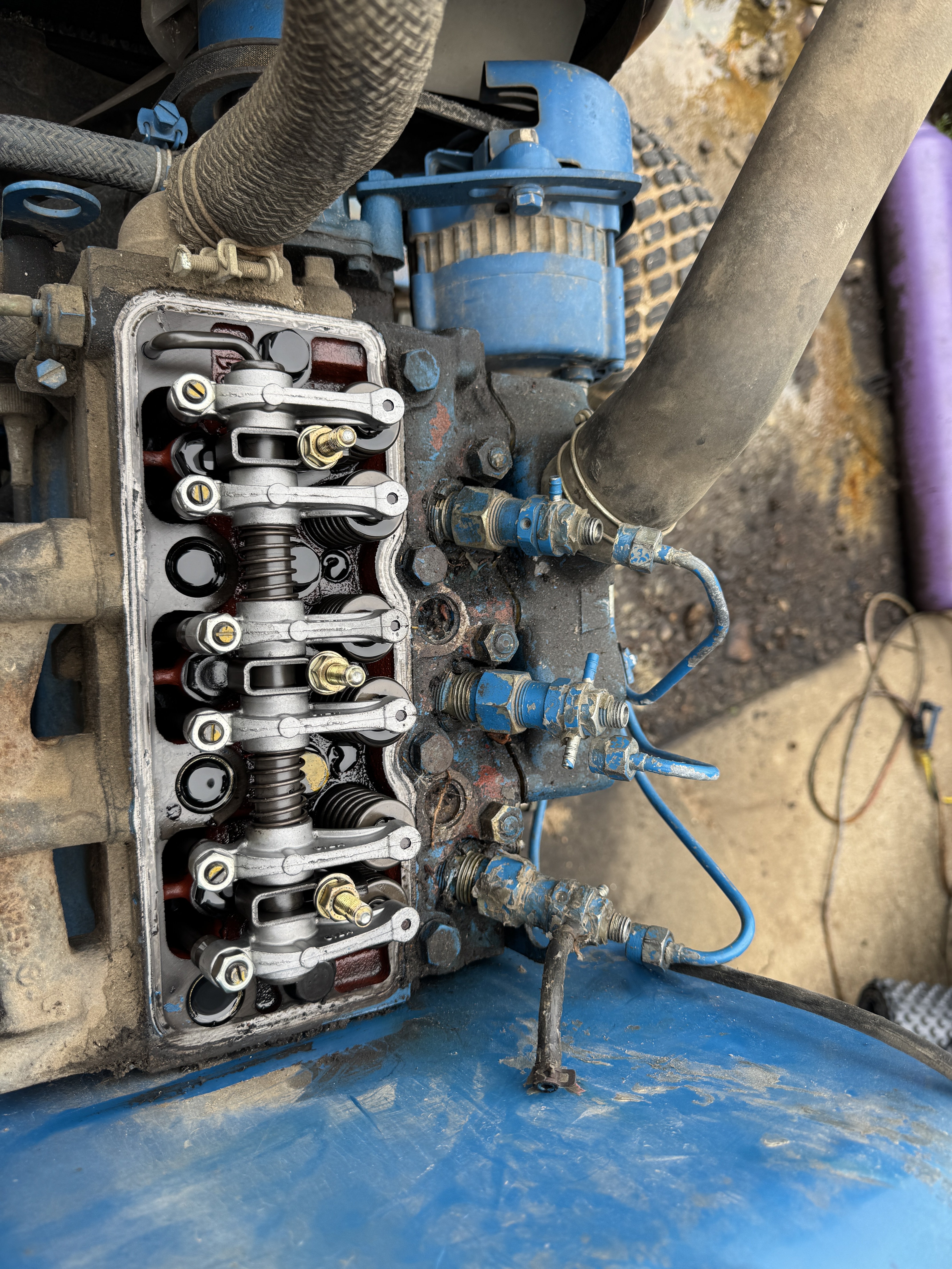

When I was taking off the rocker arm assembly and the head. This piece fell out. Where does it go? All help is very much appreciated.

Hello aarcher7, welcome to YT! My vote is a valve cap #17 as shown in the diagram linked by Andy, goes on top of valve under rocker arm. Should be 5 others one on top of each valve. Just FYI, that link will allow you to view all the parts diagrams for that tractor. May be less obvious if viewed on a phone, click Table of Contents to take you to the “FunctionAl Group” index.
Hey, I’ve been looking for a great diagram like that. I have the book but it’s not all that wonderful but it’s definitely the cap so number 17.
I appreciate you guys very very much. I am not a master mechanic, but just know enough to get by sometimes, you have been absolutely wonderful!
