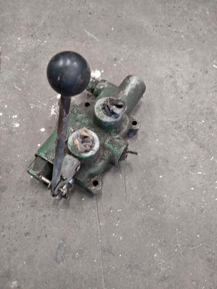

Additional Hydraulics Question
None of the tractors have rear remotes or FEL's and I'd like to attach the red 3 point hitch fork lift attachment (as can be seen in one of the photos below). I have read so many conflicting ways of doing this, it's made my head spin :-).
Can anyone please give me a simple explanation as to how to do this, if indeed it's possible? The forklift has a single cylinder, one hydraulic hose only and I recently purchased a valve with a lever that might be useful but I have little experience with hydraulics to know if is or not :-)
