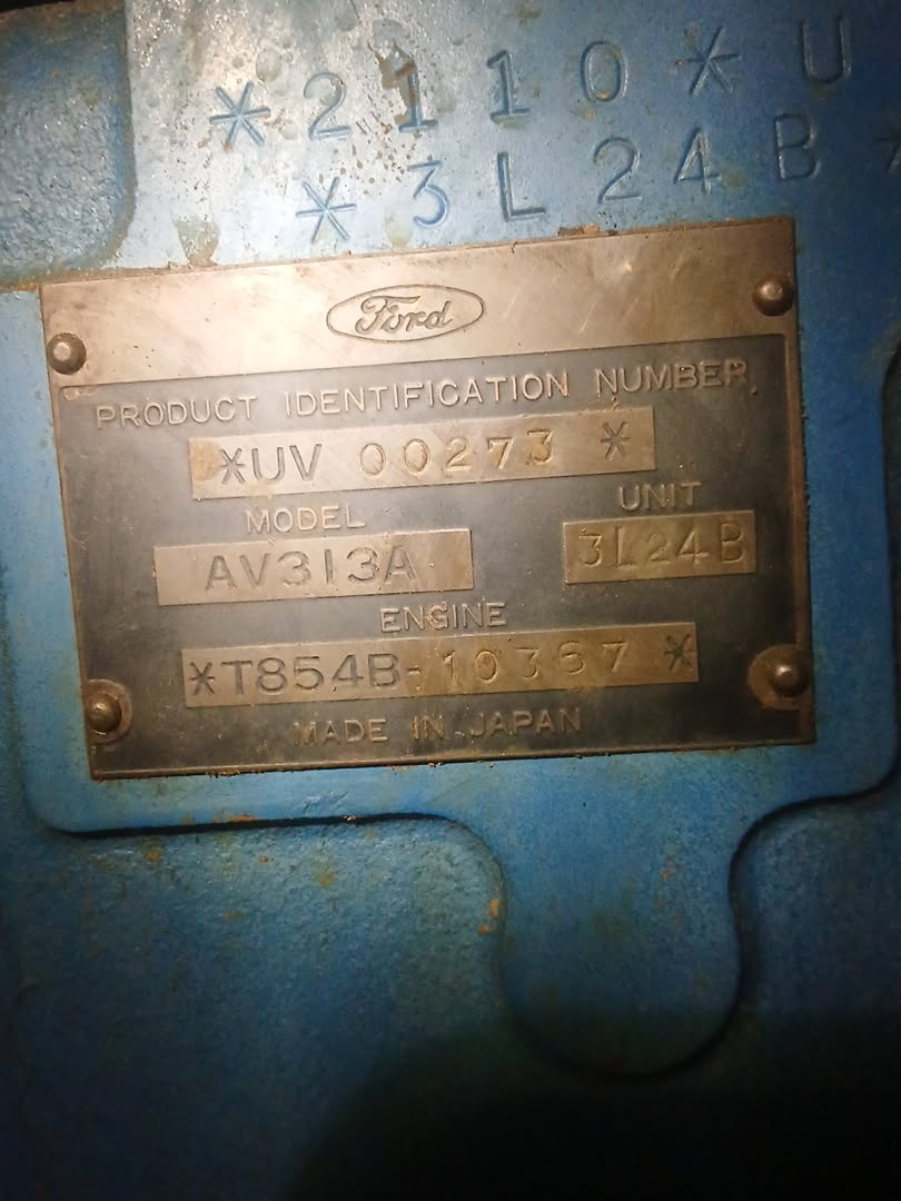

I'm having trouble finding the correct radiator for my Ford 2110 tractor. It has a 90 degree lower coolant intake. Any suggestions is appreciated especially a manufactures part number.
There is 3 versions of the 2110, 4 cyl gas or diesel, 3 cyl in gas or diesel or 4 cyl diesel that was made in Japan. From description is sounds like you have a 53-64 unit so radiator for 600/601-800/801 fits it.
It's a 4 cylinder diesel made in Japan. I believe it's a 1985 model year.

Original part number for your radiator is SBA310100500. It is no longer available new. A search on tractor-part.com shows that Cook Tractor in Clinton MO, which is a tractor salvage yard, has a used one in stock.
