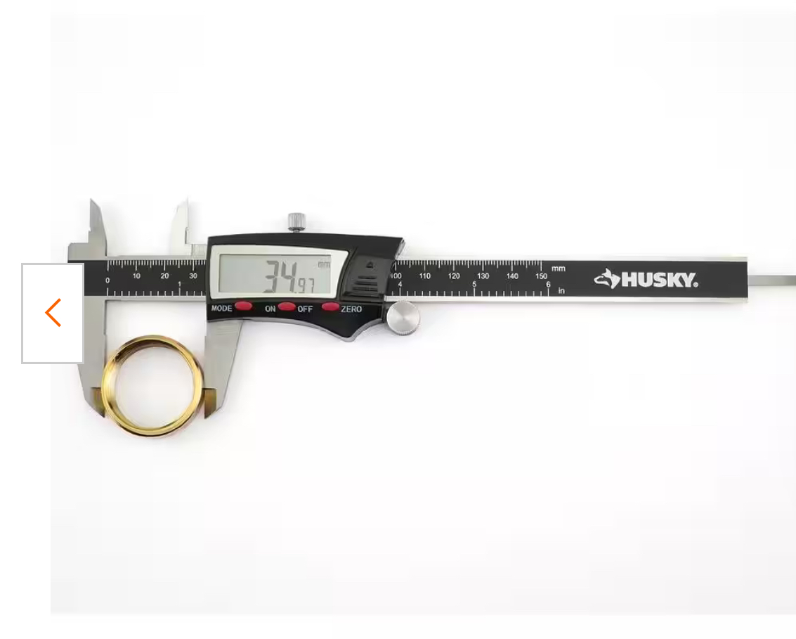

These are the caliper that I used

You need a micrometer not a caliper. You alsi dropped a digit - crank is 2.248/2.249

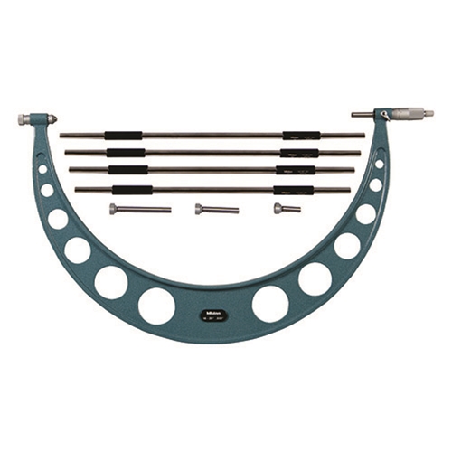

A Micrometer ...not calipers....
