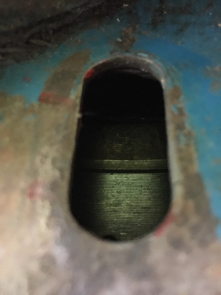

Finally getting back at it. I located the spot where you can see the timing marks, but I'm not seeing any pointer ;0
If it ever quits raining I'm going over there and try to get it to TDC and see where the distributor is pointed. I'd like to get this thing
running
I chased timing on my 3000 over and over, and though it would start, it would snuff out on any kind of load. It turned out to be a gummed up carbuerator and it was running extremely lean. I got a cheap carb off Amazon, and it solved the problem, though you have to set the float level on those cheapies, or it'll just pour gas all over the ground. Once I got it started, I put a die grinder brush through the timing hole to clean off the flywheel, then set timing. That's when I realized I had a bigger problem than the timing. If you have to use starting fluid to start it, and use the choke to keep it running, then you need to clean out/rebuild/replace that carb.
Got some oil in there and cranked for a bit to get everything oiled up. Not starting but I'll mess with the timing when I have more time.
For anyone else facing this, I did manage to find a pointer. Very hard to see but it's an arrow at the top of the picture. Right above the view window.
