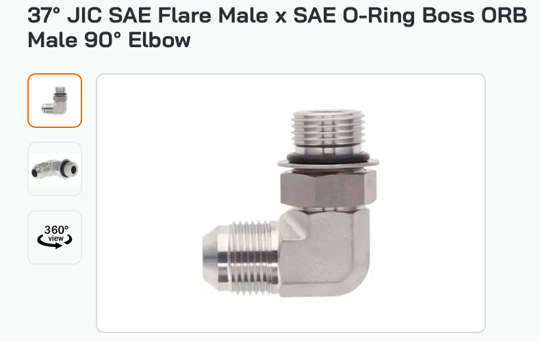

1979 Ford 4600. Has hydraulic hoses (part E4NNB968CC) that go from the control under the cab to the quick connects. About 20" long. One end has a banjo connection, other is standard hyd.
Does anyone know where i can find these. Thanks
These come in different sizes and lengths, replace the banjo fittings with these and have a hose made with a jic fittings to fit this adapter
Some of my Tisco valves had hoses with jic 90 swivels on one end to screw into the valve
