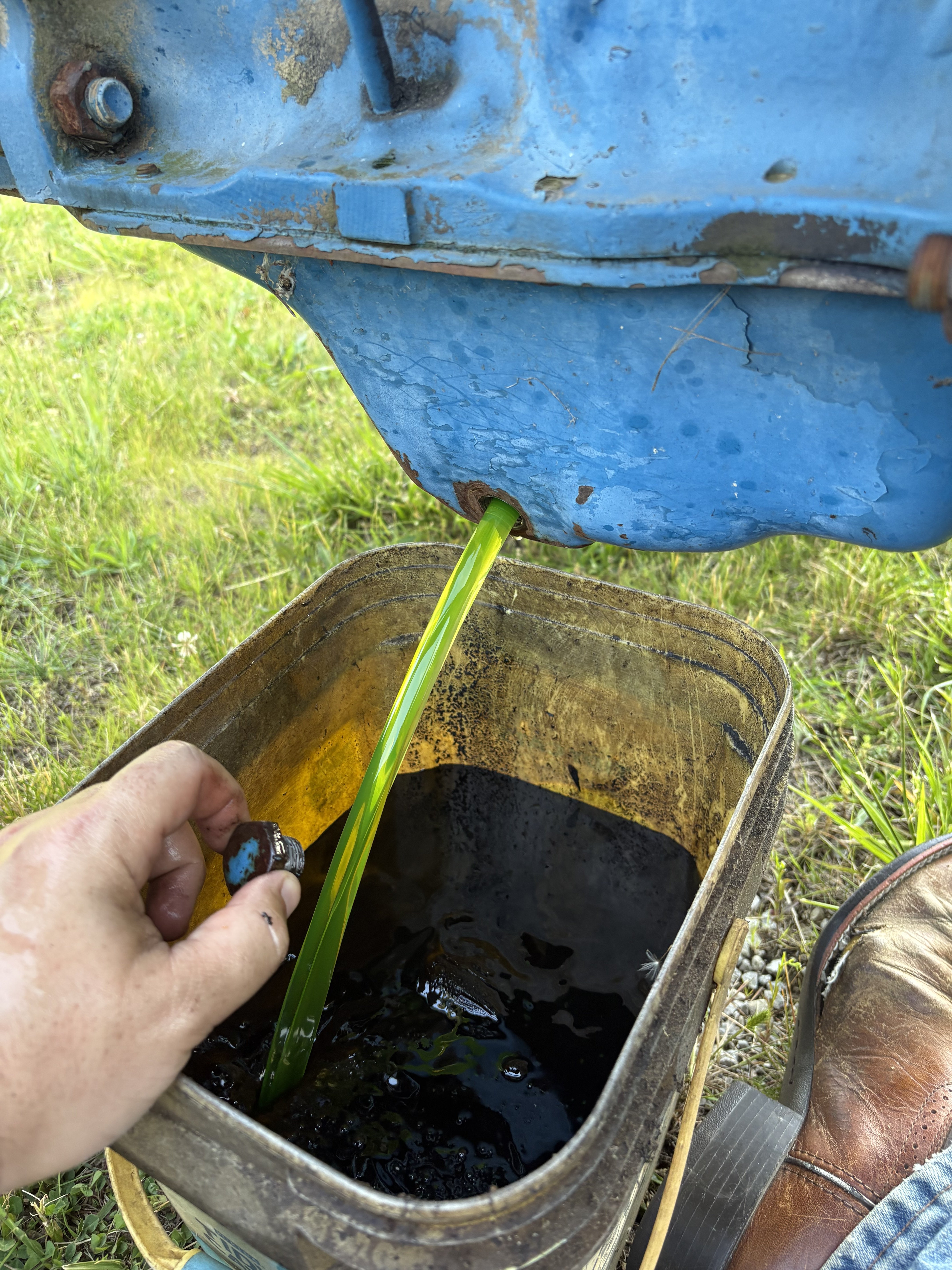

I have a Ford 4600 SU that belonged to my dad. It seems like it has several problems, and I’m not even remotely mechanical. Trying to get a sense of whether I should junk it or fix it. It sat for nearly 5 years, but was parked running and ready to use for winter with the blade on. That was the last thing my dad did before his final illness, and the tractor has not been started since.
Engine is seized, and when I drained the oil pan, what appeared to be all of the antifreeze came out first. I have been told that suggests either a cracked block or blown head gasket. One of the rear rims will also need replacement if the tractor is ever got running again. Because I haven’t gotten it running yet, no idea if the hydraulic lift works at all.
I’d like to have it running and usable, but the list of problems is a little overwhelming, especially without any mechanical knowledge.
I’d love to hear whether this is a worthwhile project or if I should just let it go.
Its a tough choice. At minimum, you will need to pull the head and replace a head gasket $600, while looking at everything for cracks. As the most likely source.
OR... could be cracked block, pin holed cyl, cracked head, all which then become a $7000 fix.
Otherwise you have a "parts" tractor to sell to someone for $500 to 800 bucks.

I'm going to say NO... as you can put pressure on the cooling system and see that it leaks down, but you can NOT tell where the leak IS in 99.99999999999999% of the cases. If it should have an external crack, then yes, you can see or hear the leak. I wonder if he did not have antifreeze in the engine and it froze and crack the block somewhere???
You drained the oil and all of the antifreeze came out with it???
Is the engine still seized? it might be hydrolocked if the antifreeze is in the cylinder. Was it antifreeze? Shouldn't have frozen if it was. If it truly drained the coolant system into the oil pan I'd bet against a head gasket as the head sits high and usually an engine that isn't running wouldn't leak much into the cylinder through the head gasket.

I drained the oil and there was a good stream of antifreeze that came out the oil pan before the oil did. Radiator has no coolant innit anymore, makes me think it was the full radiator contents in the oil pan
I actually had the presence of mind to grab a picture of what came out

My first question is was the exhaust pipe covered, if setting out for 5 year with the exhaust pipe uncovered you could have a cylinder full of water, that will mess up a engine quick
Two ways to know what you have, pull the injectors and use a bore scope to look in the cylinders, the other is pull the head
With antifreeze coming out I don’t think it froze and cracked the block, but if water got in a cylinder it could freeze and cracked the block that cylinder

It was sitting out. Flapper on top of the exhaust was not fully closed. Dad parked it ready to scrape snow, went to the hospital the next day, and went from hospital to physical rehab facility to skilled nursing to passing all within about 7 months.

I've gone the repair seized engine twice now. While it's worth it in the long run if done 'in frame', the cost and time are significant. If the rest of the chassis is in good shape, and it doesn't NEED a clutch job, I'd take it to some small tractor place and let them do the in frame rebuild. Or, have the engine redone all the way. If the rest of the tractor is real rough, just sell it and let someone else try.

Can you post a couple photos of the tractor, it’s overall condition (tires, wheels, sheet metal, fenders, ect) can determine what the total cost would be to get the tractor back into usable condition. With coolant in the oil pan and the engine locked up your most likely looking at boring and sleeping the block, last one I had that done to was $200 per cylinder. Machine work, parts, labor can easily put engine repair cost in the $3/4000 range, bad rear tires or rims or overall rough condition can surpass the tractors basic value. As for sentimental value there’s no measurement for that, just understand personal sentimental value has no marketable value
