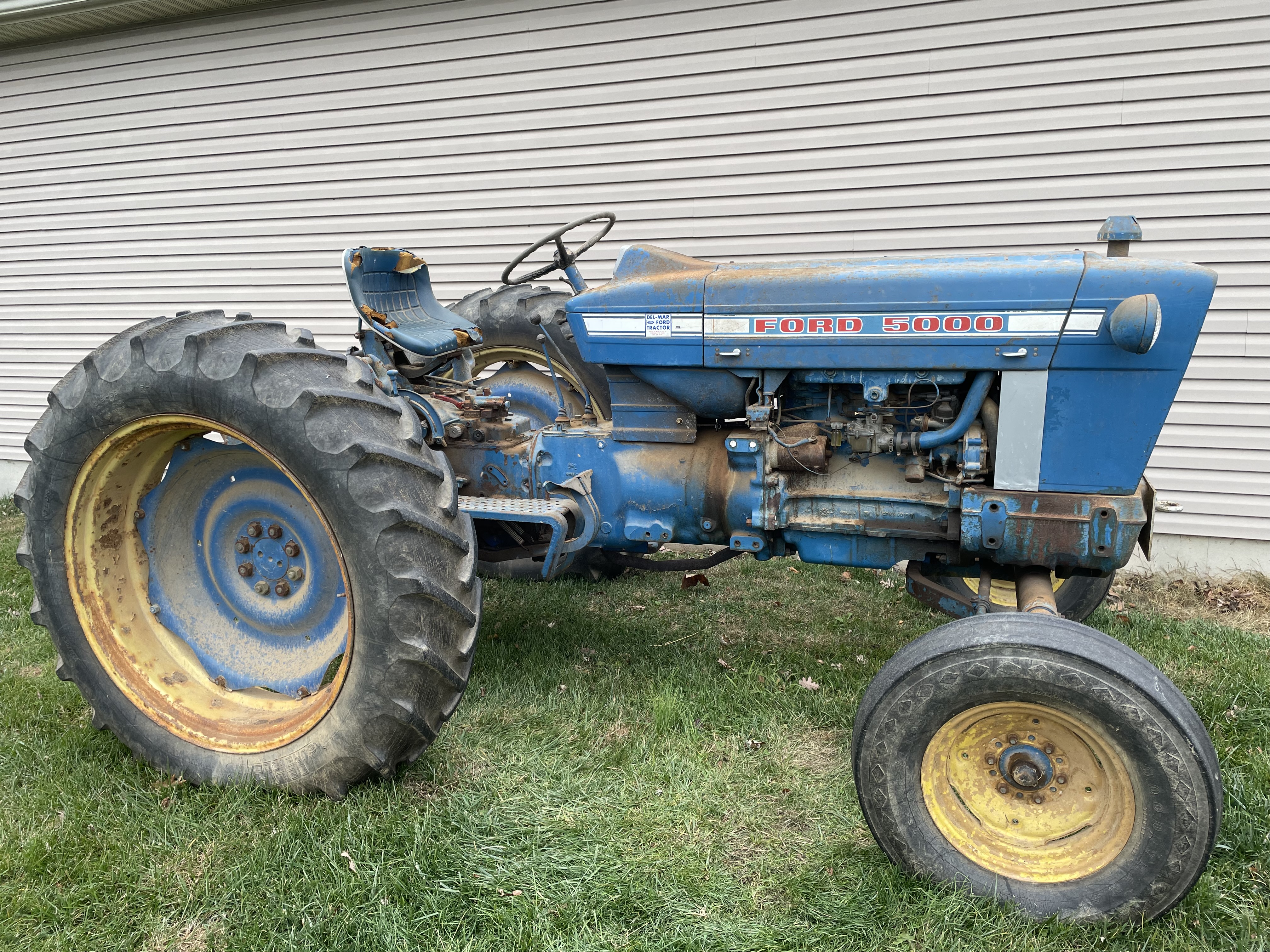

Struggling with our gas 1969 Ford 5000 to get it started. It ran when was parked about 2 years ago. It turns over and sputters a little but will not run. I went through the carb completely and have set everything to factory spec as a starting point. I do know the fuel pump is working fine. I checked for spark and seem to have that at the plugs, it looks weaker on the front two (closest to radiator) cylinders but my test may just not have had a great ground. Im going to try a new set and see if that helps, Autolite 405.
Any suggestions on other things to try or other common failure modes? I am not much of a Ford guy, this was my dad's tractor and hasn't seen much use the last few years, would it have points that need to be cleaned or is this electronic ignition? My super H likes a good point cleaning after it has set for awhile.

It has points. But if you have good spark, no need to clean them.
Does it have fresh gas? 2 year old gas would make any engine hard to start.
Gas is definitely not the best, I did add 2 gallons of fresh which means I have 3 gallons of sour now. lol.
I'll double check the points as precautionary, thanks for advising on that.
Since it has been sitting that long check the air inlet while your verfying the points condition. Birds and varmints can build nest blocking up the air inlet.
Went ahead and checked and dressed up the points, they were actually pretty clean to start. Going back through a spark check on the plugs revealed weak spark on #2 and nothing on #1. #1 wire has a break internally, a continuity check revealed high resistance.

First I replaced the plugs and wires, to my surprise I still didn't have spark. I went ahead and replaced the points and condenser and now have spark. Not sure what happened, its possible I damaged the points or moved something when attempting to clean them up. The dust cover was so old and brittle it shattered into a million pieces and will need to be replaced, but at least there is spark again at the plugs.
I recall years ago this tractor to be a hard starter, dad had a little access port in the rubber intake and would often give it a quick shot of starter fluid to help it get going. It was a mowing tactor and I don't think ever used in the winter. In his spirit I gave it a quick shot of starter fluid and was able to get it to run for about 10 seconds or so. I couldn't get the choke/throttle combo tweaked just right and it quickly died out. At this point the battery is too weak to effectively turn it over, I'll let it charge awhile and report back, hopefully I can get it going on its own power.
I didn't measure the fuel pressure but it is pumping fuel at the carb when the tractor turns over. Is the hard/reluctant starting a common trait of these Ford larger gas engines? My Farmall H and John Deere 2cylinders fire right off after a crank or so and they have 6v systems.

Just put the freshly charged battery in and bumped the starter, fired right up!
I’ll have to do my part this winter to keep it running once in awhile, I’d rather not repeat this process any sooner than needed.
