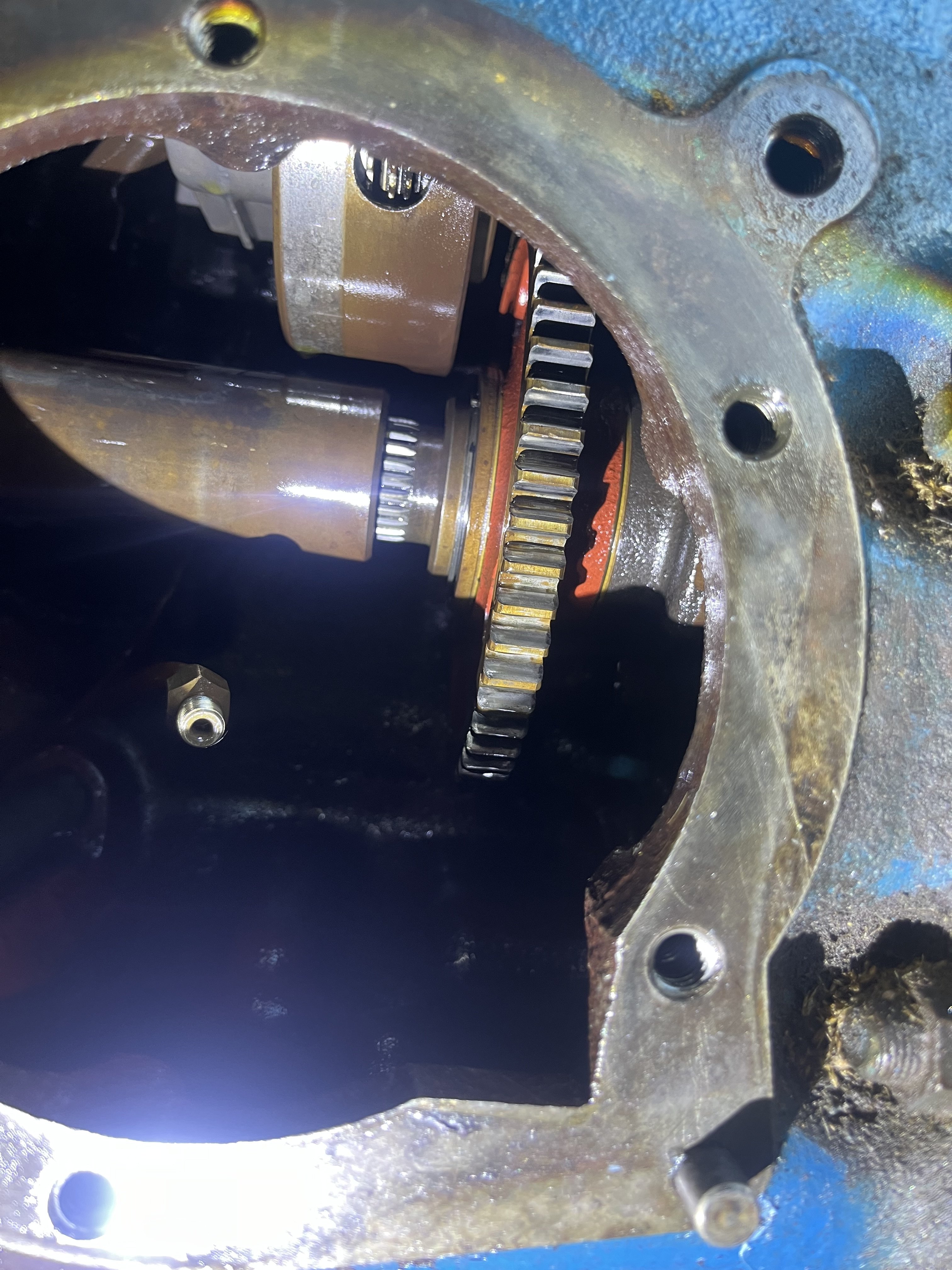

Destroked 450, Thanks for the note. I wanted to test it again this morning. The problem still exists. I replaced the intake filter attached to the pump, but did not change the return filter. I read that could cause both the PTO and 3-point hitch to stop working. I drained the fluid and got the old return filter off and waiting for new one to arrive this week. I hope this solves the problem. If it was worn splines I would assume I would have seen no improvement after using the Seafoam Trans Tune. I think the splines all look good. Can you tell from the picture? I also found no metal shavings in the bottom of the reservoir.
The splines I’m talking about are in the drive hub bolted to the flywheel

To tell if the splines are worn, take a prybar and try to turn the big gear seen in the opening. If it spins freely, your splines are stripped. If it turns hard and the engine rotates at the same time, they are fine.

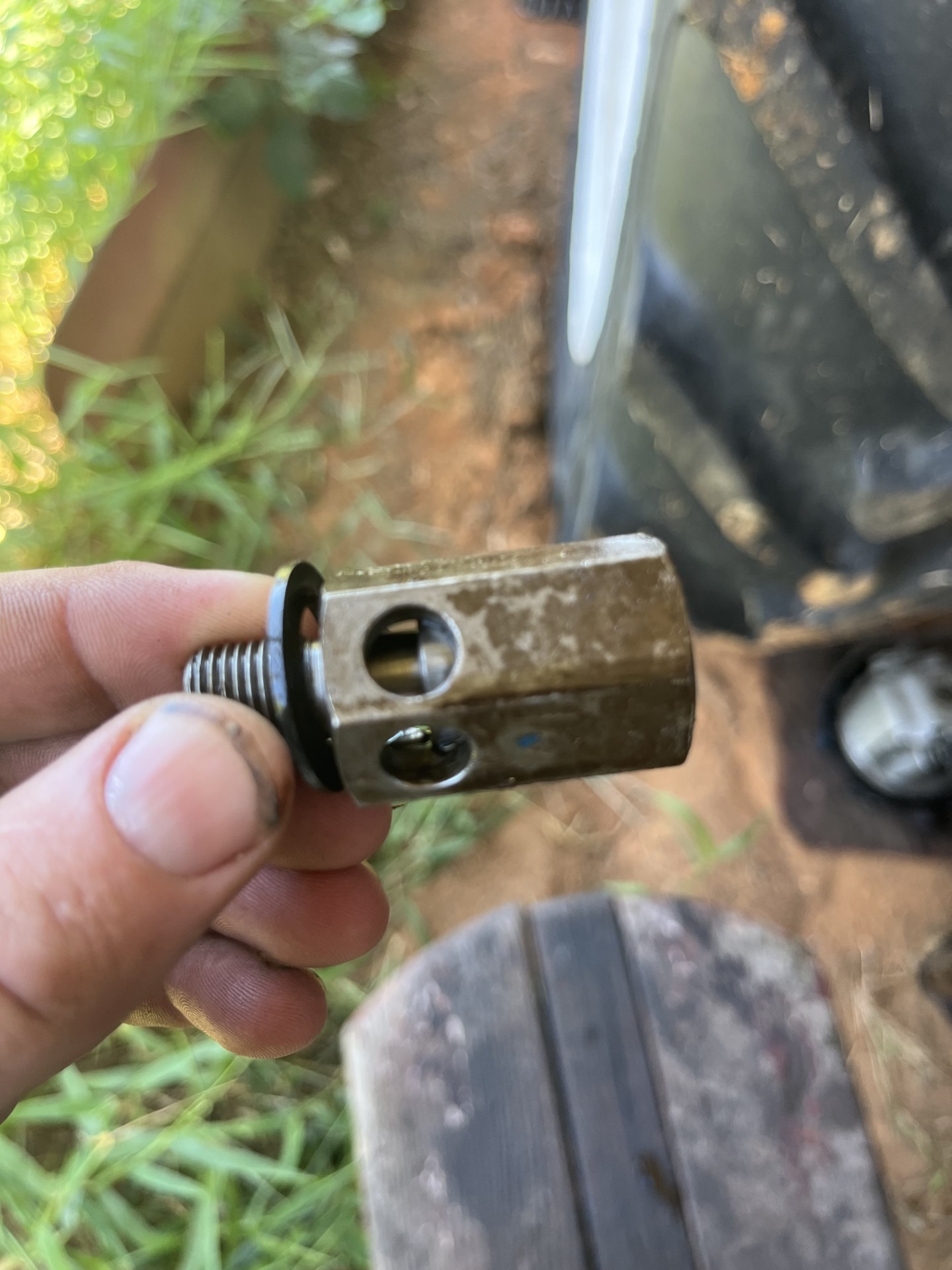

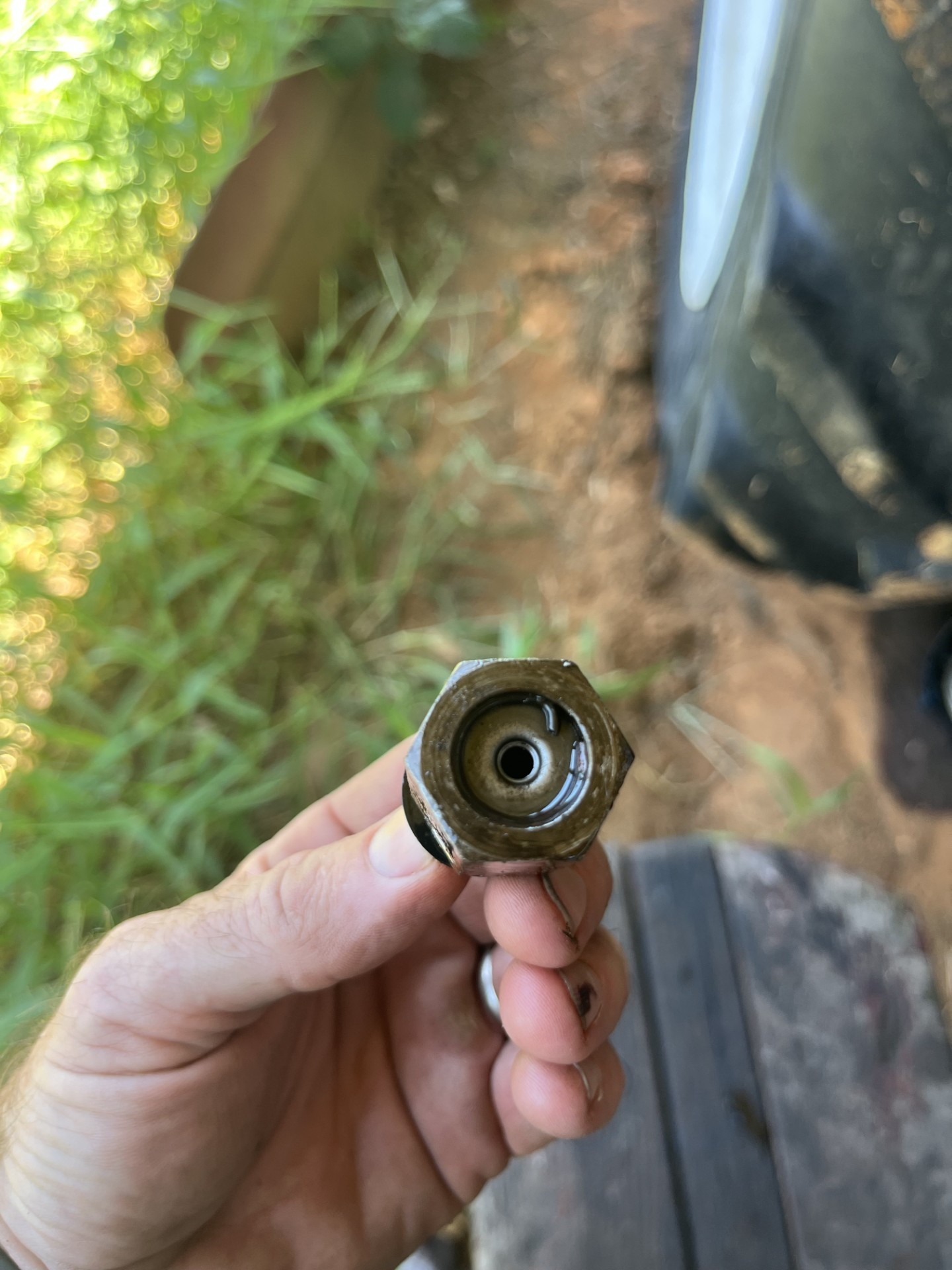

Appreciate the tips on the bypass valve. I looked closer at it today and it is missing the screw that is in bottom of it. Also, the holes on the sides appear much larger than on a new bypass valve. I will be ordering and installing a new one. From the pictures below can you tell if this was the correct bypass valve and with the screw missing was it stuck in the open or closed position? I assume not having the screw in the bottom would cause problems.

I did your prybar test today and the big gear would not turn. I was putting good force on the 18" or so prybar that it was flexing. I will be installing the hydraulic return filter, and the new bypass valve this weekend. I will let you know the results.

That's good news, it means your PTO driveline splines are holding, for now. Notice I didn't say they were "good". You could have 90% of the splines worn out, and it would still hold until one day they don't. Fortunately, this is not a big problem on a 5000.

View attachment 122438The return filter is circled in yellow in my picture. The bypass on it is simply a spring (just above the filter) that allows it to move up, and the oil can then flow out the bottom, bypassing the filter. What you're holding looks like a relief valve.

You're holding what looks like a relief valve. The bypass on the return line filter (circled in yellow in my picture) is simply a spring that allows the filter to move up, so oil can flow out the bottom, bypassing the filter.

No screw at the bottom, the compressed spring (#52) may look like threads.
