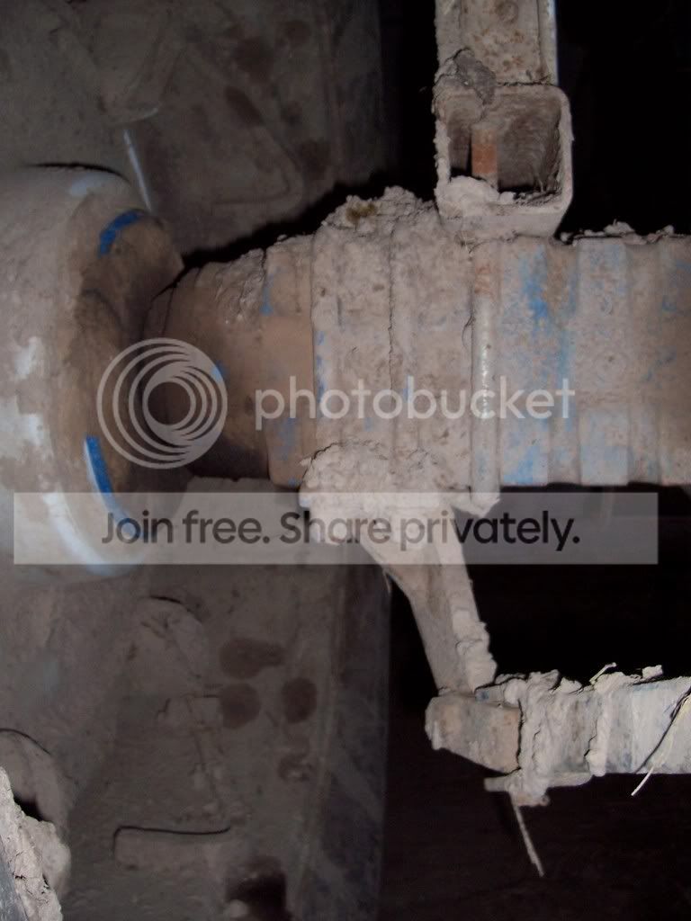

Rod - do you have any photos of the 10 series stabilizers? I have had thoughts of fabbing a set for my 4600 & 5600 but never saw any that I really liked or thought were worth the effort.
I have a set on my 7000... (don't think any mods were required... been a long time though) I'll try to remember to take a pic later today. While I don't dislike the original sway bars quite as much as Rod, he's right about the square ones being the way to go.
I was going to say I did't have any pics... but I do have a couple in this album, although they're not good. I think if you keep clicking on the picture it'll show you the rest in the album.
These are Sparex's version, mounted on a 7710. It seems to me they were about a hundred bucks and some change when I got them a few years ago. Probably a bit dearer now...
Rod
pics...
OK... an attempt at attaching pics from photobucket... 2 of my 7000 (manure and mud included) and 1 of a 6610 II at a dealer's lot... Hope this works. No mods to attach the square ones to the 7000 - they use 2 square U-bolts over the axle and a bolt through the lift arm where the sway chain used to anchor.
That 6610 has the turnbuckle variety.

Awesome. Thanks to you both. Where would I buy a set of the square ones? I like that set-up better than the turnbuckles for t he same reasons as you, mine seems to be covered in mud and manure more often than not. I was thinking of making my own, but if they are still in the $100ish range, it might not be worth it. I'm sure if they bolt right to the 7000, they'd bolt right to my 5600. Thaks again gents.
