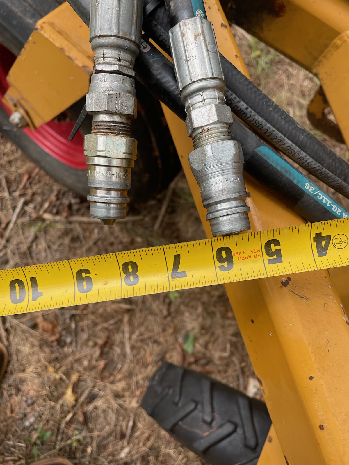

You have a cylinder with no hoses? What about a valve and outlets? Do you have a picture to provide a bit more detail on what you have. Hard to make any suggestions without more info.I have a remote cylinder on my 5000 with no hoses. Can someone direct me to a link where I can get just the hoses and possibly the bracket for the rear? I could go to the hydraulic hose shop but I'm not sure about length TPI Etc. I really need these ASAP thanks

Okay I found a hoses but I need to be for sure which coupler I need to fit this. Thank youI have a remote cylinder on my 5000 with no hoses. Can someone direct me to a link where I can get just the hoses and possibly the bracket for the rear? I could go to the hydraulic hose shop but I'm not sure about length TPI Etc. I really need these ASAP thanks
Yes I have the single spool valves and everything it just looks like no one ever ran hoses.You have a cylinder with no hoses? What about a valve and outlets? Do you have a picture to provide a bit more detail on what you have. Hard to make any suggestions without more info.

Most likely ISO 5675 agricultural couplers - AKA "Pioneer style" couplers.Okay I found a hoses but I need to be for sure which coupler I need to fit this. Thank you

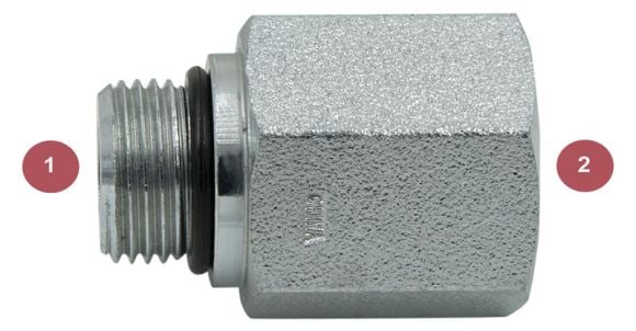

Looks lije ORB. You need one of these in the appropriate size:Hopefully someone can help I know bolt and nut threads but I'm not sure what's going on here. I ordered the hoses through Yesterday's Tractors and female fittings they sent me male fittings that doesn't fit the end of the hose. I'm guessing the end of the hose is 1/2 NPT?
I don't have a clue what the threads are in the male fitting but it's important because I need to get a female fitting and the right thread to fit this hose. Thank you
If the hose is 1/2" NPT the 6405-08-08 adapter is what you need. Or buy a tip with NPT threads.Looks like 1/2" male pipe thread on the hose. And the part number for the coupler says 3/4"-16 thread 1/2" ORB.
You need adaptors as shown. Or just buy the correct male couplers in 1/2" npt from any farm store, equipment dealer, napa, etc .
Exactly why I don't buy hydraulic fittings at NAPAThe 6405-08-08 adaptors are 11.99 at my local napa. A pioneer male couplers with 1/2npt female threads is 8.99.

A 1/2" NPT male fitting measures .84Do you think the half inch Pioneer Style female fitting will fit the fitting up above? It looks like it measures almost 7/8
