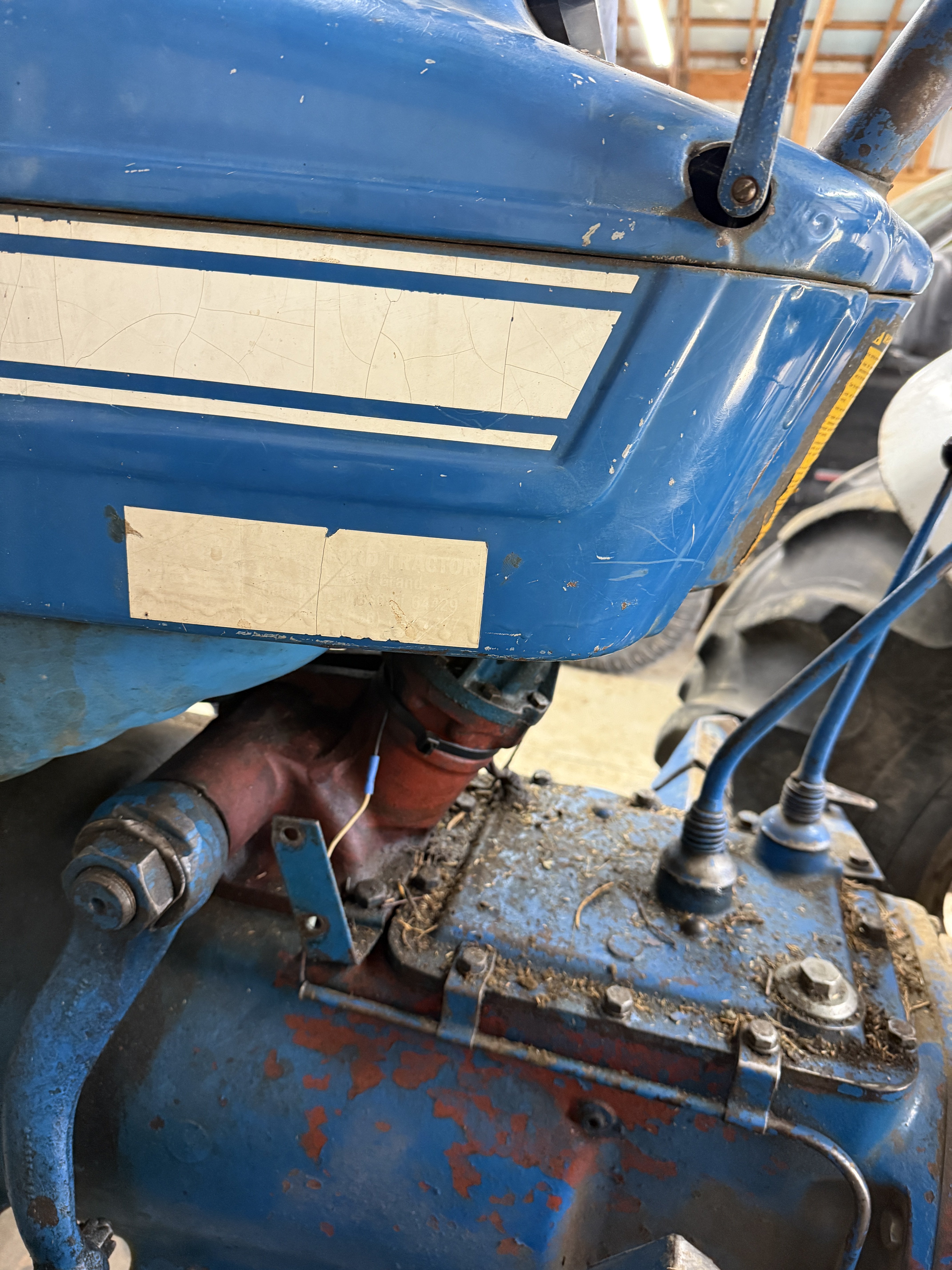

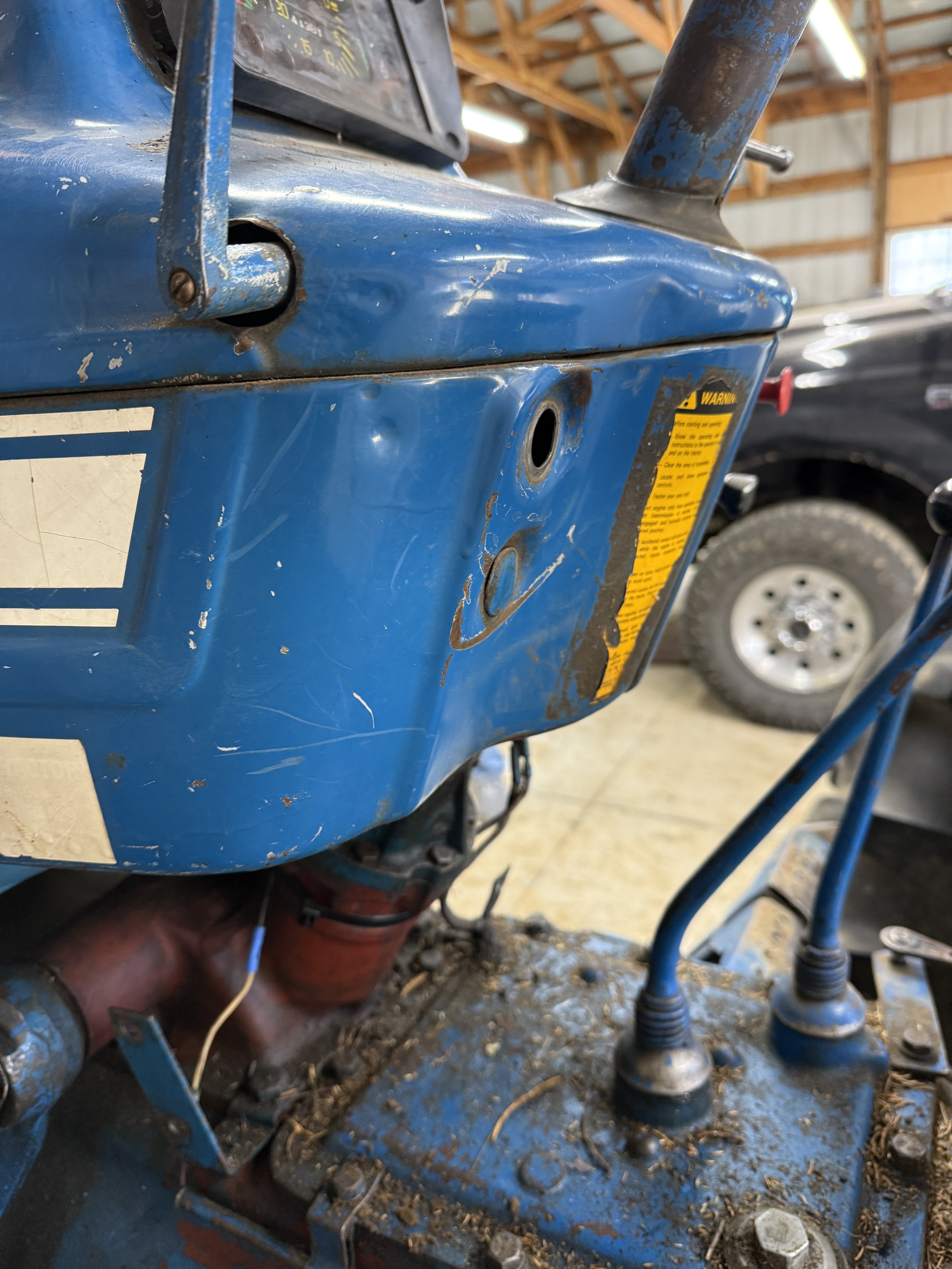

Need to repace ignition switch on Ford 5000 diesel. How do you get the cowl off to get to it? I took the switch out hoping wires were long enough to get to the terminals but no go.

You may need to fish the wires up and out from behind the dual power lever bracket in order to pull them down far enough to stick out the bottom of the cowling
Removing the cowling is a fairly difficult job
would it be easier to trace the wires back a way and splice a new longer wire in so it extends out of the cowl?
Vito
Yea we tried that first. The wiring would not go up and over whatever controls was back in there. If it did it would be long enough. And I couldn't pull them through because of the switch on the end.
Really seems the cowl needs to come off.
Seems it's time to start removing sheet metal and a bunch of other stuff.
Vito
I ended pulling the tac out, then pulled with key switch wires out and used a volt meter to see what’s what, then use the volt meter on the key switch position and see what tabs do what. Once the tractor run, snake them back under and attach to them to the key switch and then snake the key switch back into the hole put the nut back on
