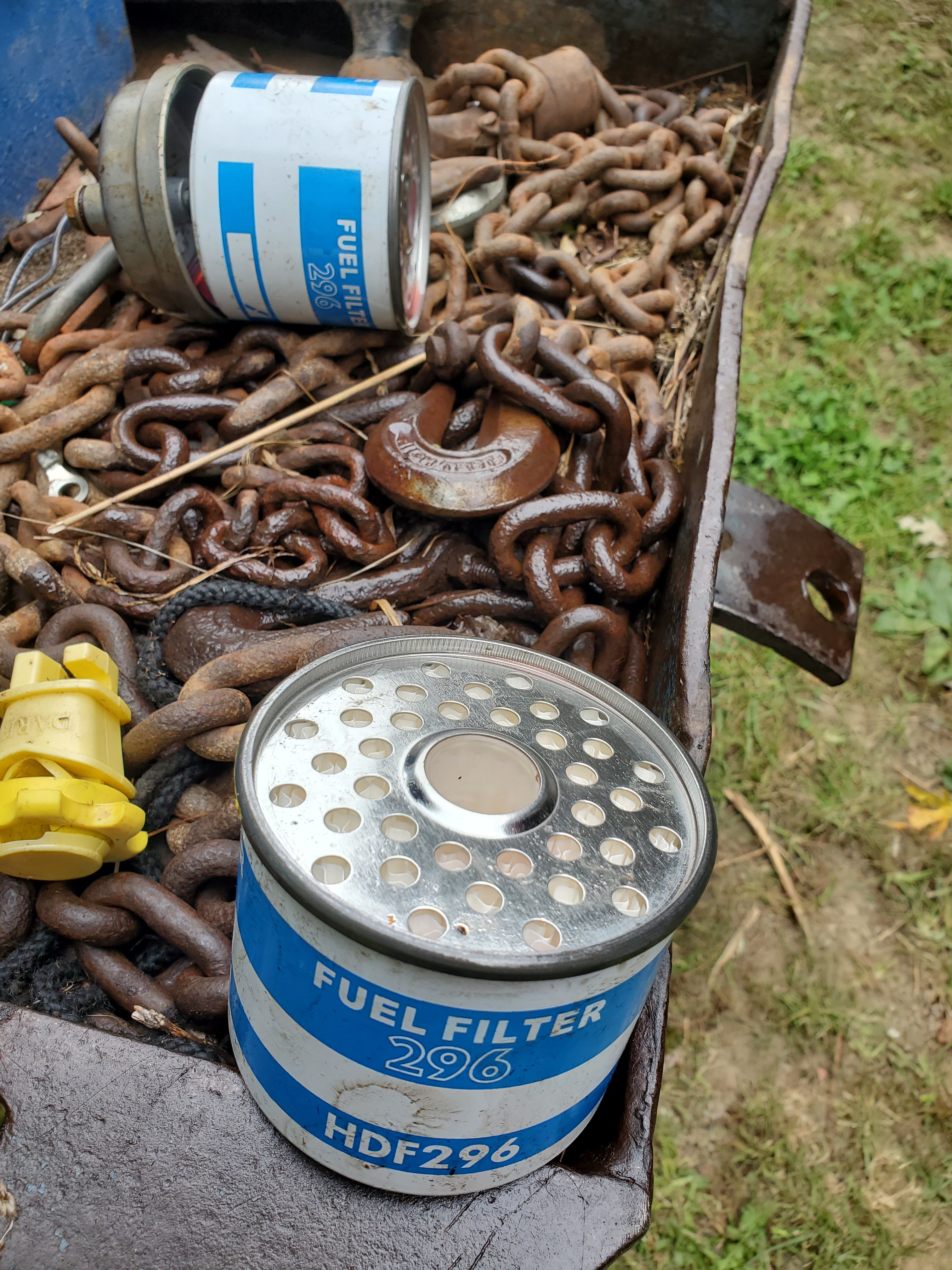

Ford 5000 diesel was loseing power, almost dying while tedding. Dual fuel filter system. Pulled the 1st and found it had a bunch of crud in it; 2nd filter had none. Installed 2 new same model filters. Now I'm finding I cannot get fuel from the 1st to the 2nd. 1st has fuel; 2nd bone dry. Any ideas?
What brand filters? If the WIX type check to see that the seal is not inside the rim and covering the fuel slots.

Which injection pump? Early inline has a feed pump on the side of the injection pump. Late models have the CAV DPA rotary pump that's GRAVITY fed, no hand primer like the early models have. Also sometimes the engine needs turned a bit so the hand primer will work, it WON'T work when the cam lever stops and holds up the lever inside the injection pump.
