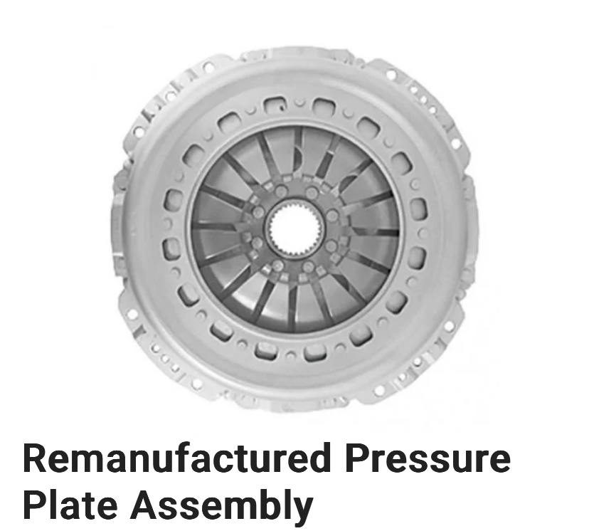

Yes the problem was the drive hub and the PTO shaft was both completely stripped. Now I am back to installing a new clutch. I can't remember which way the off set of the clutch hub goes. Twords the flywheel or the pressure plate? Or if it even matters.
The disc goes in with the offset towards the pressure plate
Make sure you have the correct style pressure plate, yours takes the diaphragm style
Where did you find a replacement pto input shaft
I have had this thing apart a couple of times today and the clutch won't release no matter what way the clutch plate is flipped even with all of the adjustment took up till the throw out bearing touches the pressure plate.
I have a pressure plate just like what you got pictured and the one that came out of it was the same looking. The only difference is the new clutch disc doesn't have springs in the center hub and the old one does.
F82013945NR-KIT is the new clutch kit I have.
FC563ACN-KIT is the clutch kit that I think it's supposed to have.
Can you post a photo of your tractor with the gear shift levers
Clutch kit F82013945NR-KIT is for your model equipped with the 8x8 synchronized transmission with mechanical shuttle shift
Clutch kit FC563ACN-KIT is for your model with the standard 8x2 non synchronized manual transmission
Installing the finger style pressure plate in the synchronized transmission pushes the throw out bearing hug back against the oil distributor housing in the front of those transmissions, this results in insufficient room for proper throw out bearing clearance and a slipping clutch in the near future
This is why you much run a diaphragm style pressure plate with the synchronized 8x8 or 16x8 transmissions used on the 3930/4630/5030 models
For the standard non synchronized 8x2 you need the finger style pressure plate to achieve the proper throw out bearing spacing
I have personal knowledge of this, the 5030 I replaced the transmission in had a diagram plate, the 3930 I got the transmission from had a new finger style plate so I put it in, a short time later I was splitting the tractor again because the clutch was slipping, after installing the correct diaphragm plate the tractor is still going
As for the clutch disc it doesn’t make any difference which one you install as long as it’s in correctly
It's a 8x8 trans. After taking these pictures I believe the new pressure plate is thinner. I'm going to take the new pressure plate out and set them side by side and measure things.

Well I have found out that the bulge in the clutch does infact face the flywheel., It will come in contact with the PTO shaft if turned twords the pressure plate.
I have also found that the clutch does release. If I put the trans in high fourth (8th) hear the engine turns with the clutch out and it releases when depressed. But in the low side gears it seams to be hung. The engine doesn't turn when in low side gears when rocking the rear tires and it doesn't free up with the clutch depressed.
So something is hanging in the transmission in the low side. But it drove fine in low before I split the clutch.
