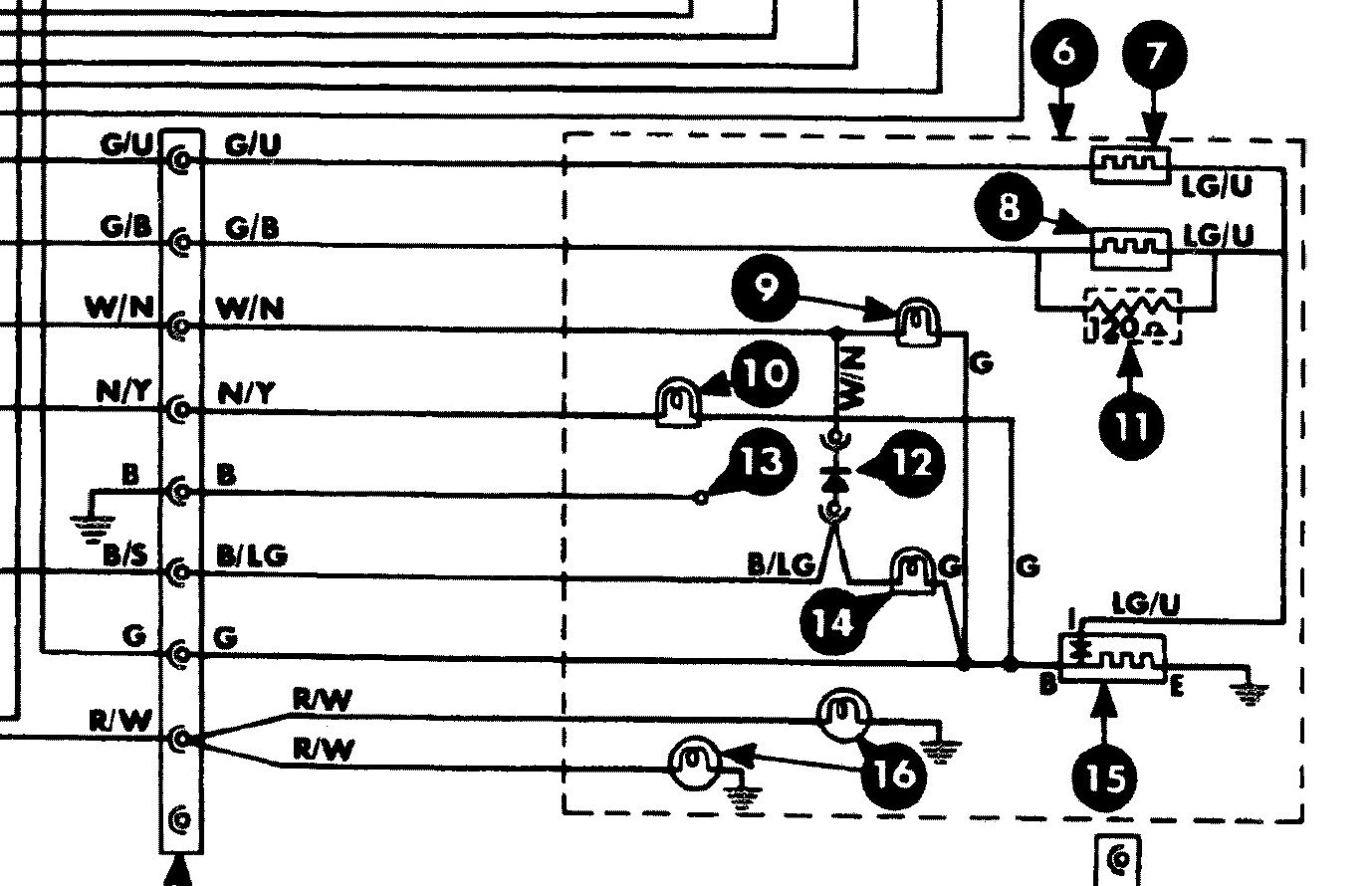

I'm looking for 5600 wiring diagrams. If anyone has anything that'd be great especially with a cab, thanks!
Wiring diagram for cab models is several foldout pages, my 10 series service manuals has the diagrams for the 3 cylinder model 600 series but not for the 5600 and larger models
possibly have anything that would help with the instrument cluster?
Instrument cluster is in the wiring diagram I sent you - reference #6.
Looks a bit different than what I see. Do you happen to have a picture of everything connected to the cluster? Also, do you know if someone repairs these clusters or am I better off buying a new one? The fuel gauge seems to be stuck in the middle.
