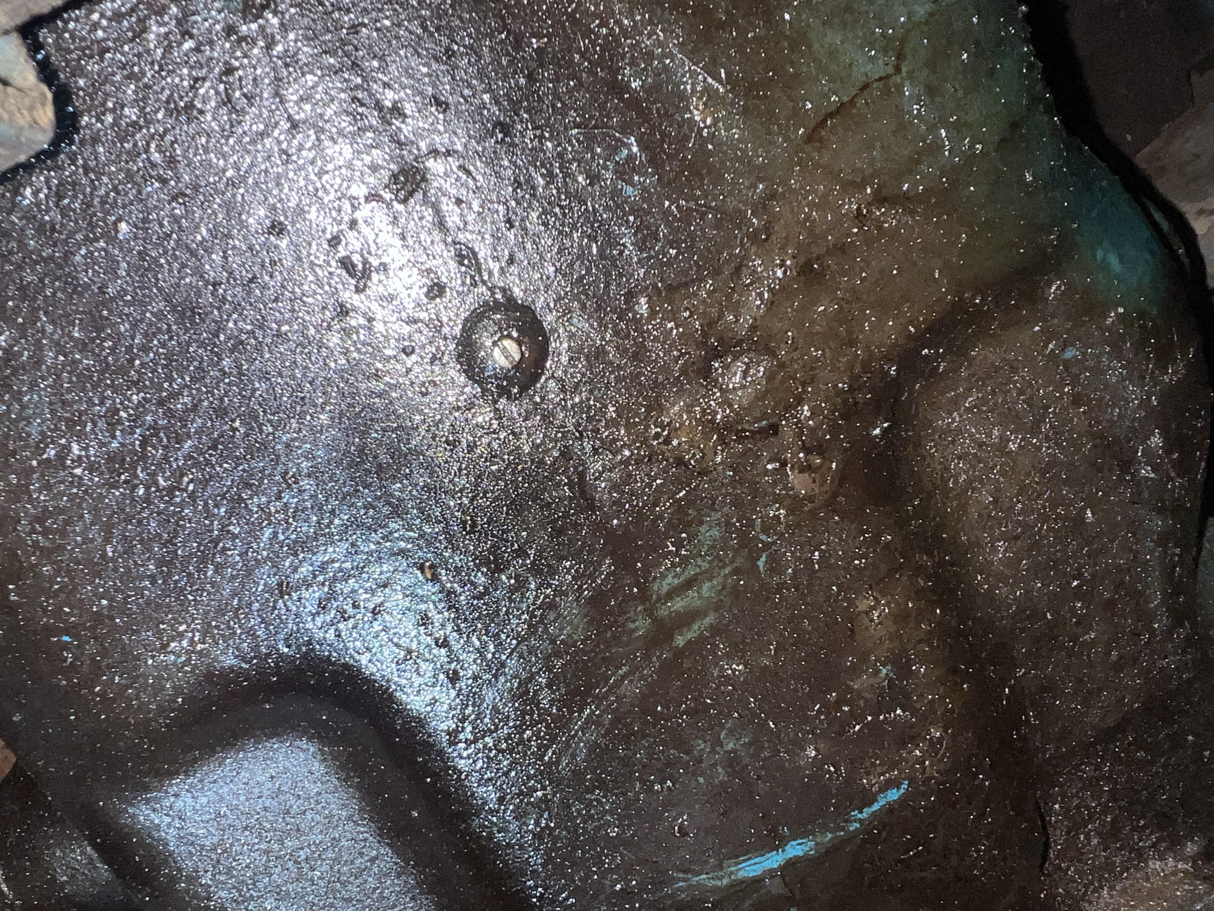

Is this supposed to be the cotter pin?

Keeping that hole open will keep the fluids from building up and making the clutch plates slip, so check it occasionally. Its not uncommon for most fords to drip a bit from that area, so ford had put a cotter pin in the hole to wiggle around and keep the drain open. Unless it keeps pouring out constantly, I would not worry about it.
