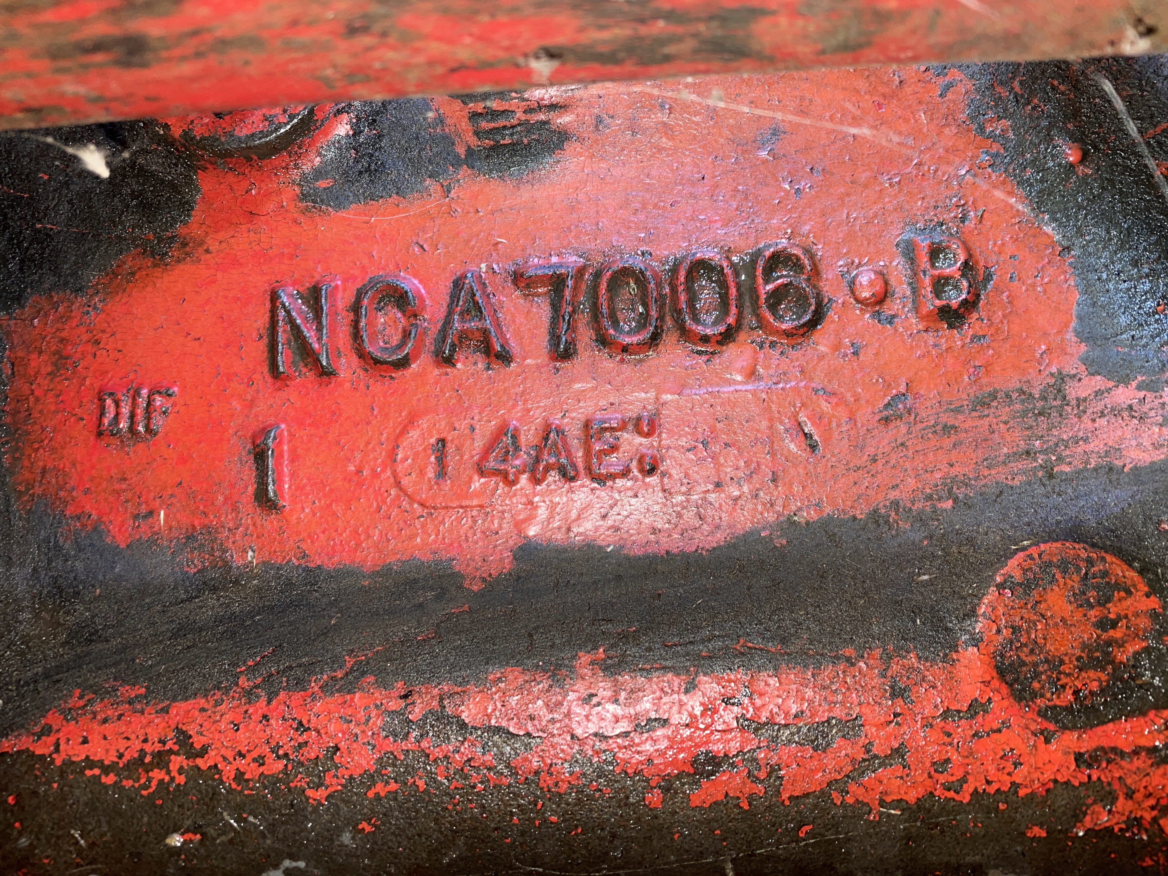

Thank you, I looked over the tractor some more today and located numbers:
NCA7006 B
1 4AE:
On the right side under the right foot rest step. I am curious which is the transmission number? Does this tractor has a certain brand or type of transmission or is it just a Ford 4-speed? I have heard some people mention a Select-O-Speed, Sherman, etc.

NCA7006B is the casting code for a Ford 4-speed transmission 1955-1957. The brand is Ford. The Select-O-Speed didn't come until later. A Sherman is an auxiliary transmission added to the 4-speed to give additional gearing choices such as overdrive, underdrive, combo, or shuttle (various choices, they aren't all the same).
