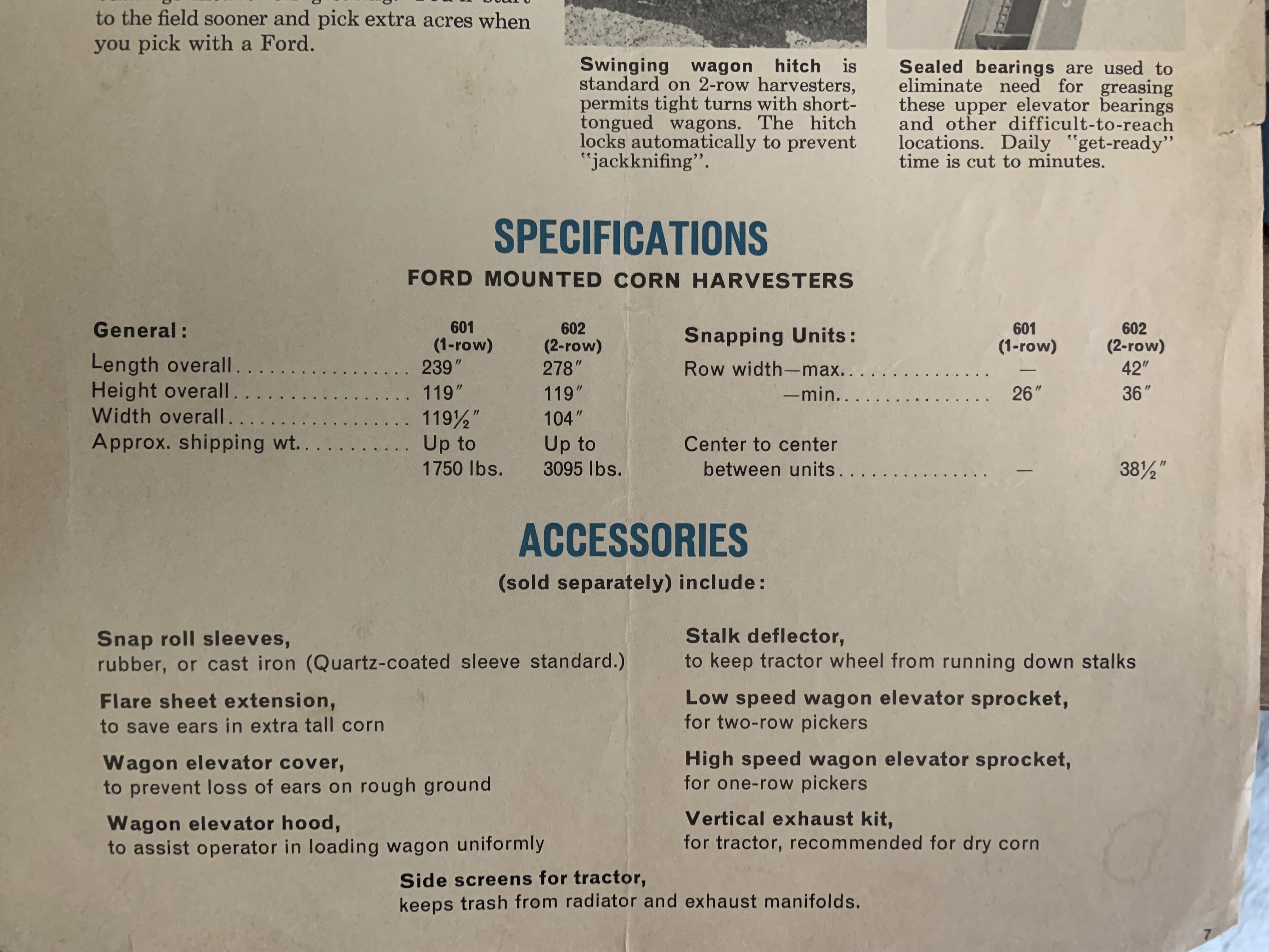

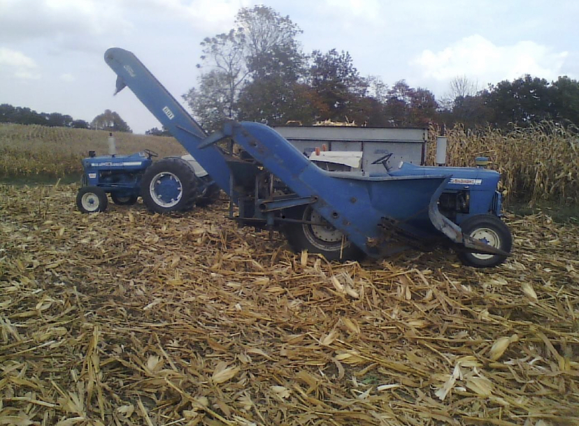

Last one I bought we mounted on my 4000SU that is same size as a 3000, when we drove up on the trailer the head hung over the right side a couple of feet, mounted on a tractor I can heighten the top link to get the elevator down to around 8 ft, normally it a little over 9 ft. We had it on a 16’ trailer but most of the elevator was hanging over the back
This is mounted on my 4000, you can see the nose cone is even with the front tire so layed out I’d say it would be twice as long as the tractor.
Edit: Just found my brochure
Edit: Just found my brochure View attachment 78836
