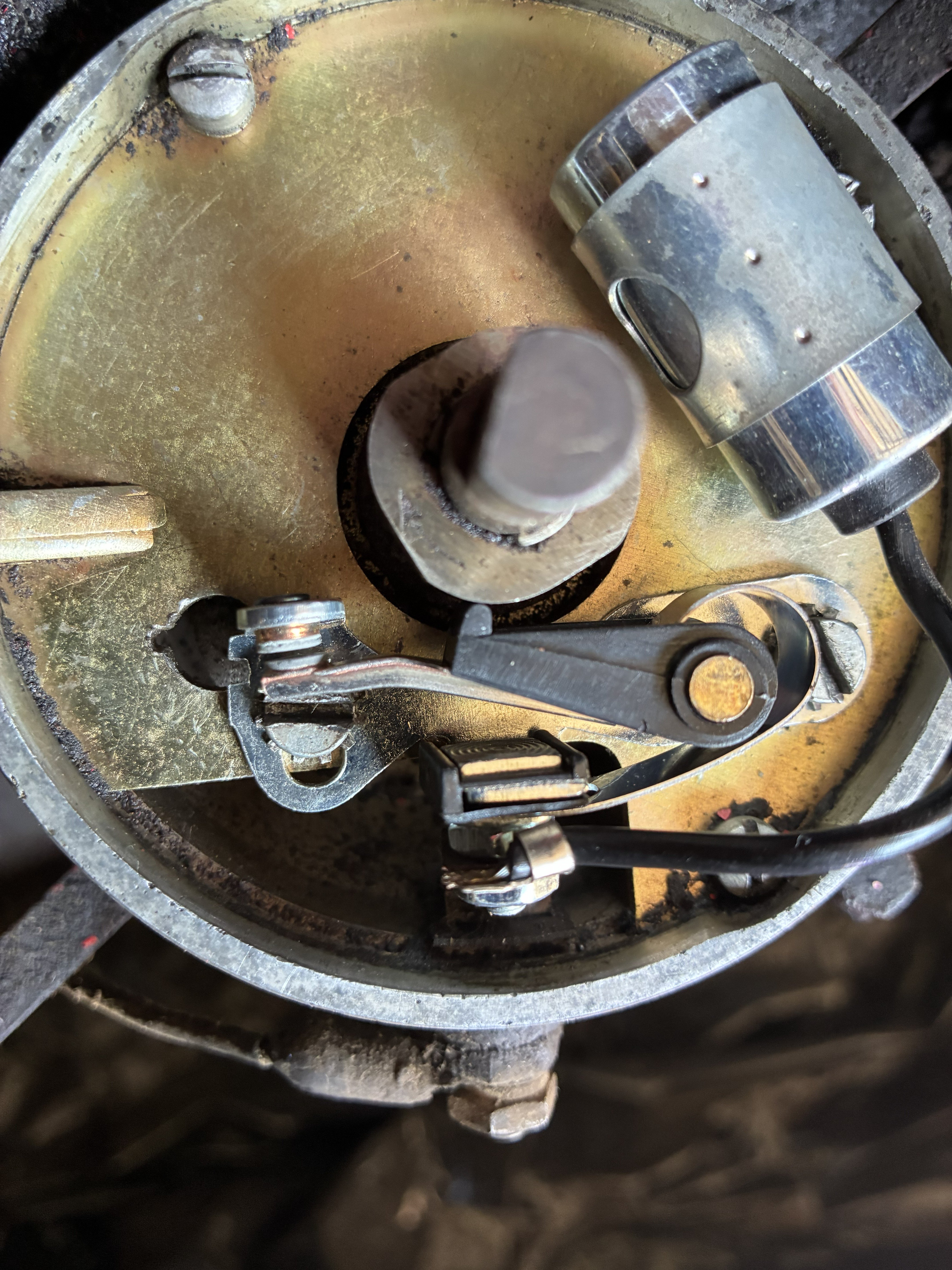

If the copper strap is not making contact with the points spring arm the light will stay on when the points are closed, as well as if one of the previously mentioned areas does not have a ground.
If any of those were touching metal the light should stay out on the distributor side terminal of the coil.
Is the item circled in red dots in contact with both the points mounting tab that's bent up ( to hold the points connector stud,) and the points spring? Red arrow points to the tab.
Tab and spring should not be touching...
I was wondering if the spring was touching the mounting screw on right as it appears spring is not installed all the way.! Had the same problem on a 420 crawler and the points spring was shorted out. moved it some and problem solved
The test light probe on the coil terminal that has the primary wire going to the distributor, staying steadily luminated while cranking with the key on indicates a lack of ground through the points. If any of those wires were grounded the test light would not luminate as the direct ground has less resistance than the test light bulb, that is what happens when the system is working correctly as the points open and close to cause the test light to blink on and off. Points open - test light luminated, points closed - test light will not be luminated.
Without cranking the engine, key on, with the points open the light (on the coil + terminal for positive ground) should be luminated. If you use a screwdriver and momentarily short between the movable arm of the points and the breaker plate (ground for the points) the light should go out.

Hi Jim, of course you are correct. Also, a closer look at what I thought was an extra item, sure looks like light reflecting off the far side of the springs slot. Oops!
Next trick to amaze your friends is to hook your spark tester to the coil wire. With the ignition switch on and the distributor cap off you can manually move the points and the coil will spark across the spark tester.
