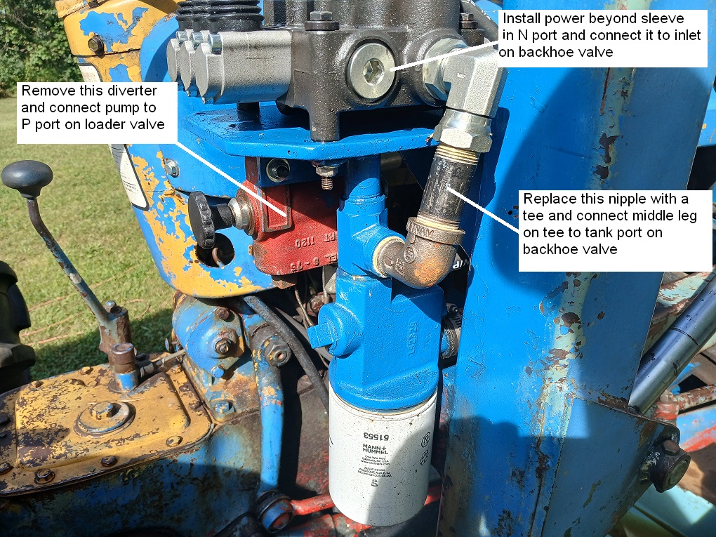

First let me compliment you on the neat plumbing.
Now here are my suggested changes to your plumbing. Its cheap and will make the loader valve the primary "fuse" in the hydraulic circuit and prevent any future accidental deadheading and damage to the pump.
Put quick connects on the hoses going to and returning from the backhoe. When the backhoe is removed simply connect the tractir side supply and return hoses together to maintain the power beyond loop. Should you fail to do that the inlet relief in the loader valve will unload the pump into the filter and prevent damage to the pump. Virtually GI proof.
Dan
Hey that's a great idea! I really like how you took the time to use the picture to point out where exactly everything needs to go. That's idea has been put next on the list, right after I get the grapple cylinder restrictions sorted out. Thank you Dan
You are more than welcome.
i will just add that if you run two hoses wirh quick couplers to the rear for the backhoe outlets and make them "permanent" you will have a general purpose power beyond rear outlet that you can use for other things. Lets say you had a senior moment and bought something silly like a 3pt log splitter you could plug it in just like the backhoe :devilish:
Dan
