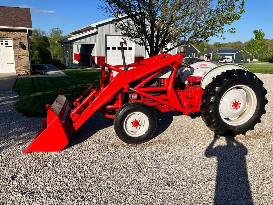

thanks, that what i was thinking.Welcome to the forum!! Nice looking Ford, but about twice what it would bring in my area!
so would around 3k be normalmore than "a little high"!
It's been cleaned and painted for curb appeal/sale value. Question is the condition of the mechanisms hiding under the paint. Loader tractors are hard on front ends, the condition of the spindles, axle bushing, and steering components should be determined. You should run it and work it (hard) and look for oil leaks/clutch slippage. An 841 does not have live PTO, which makes it less desirable for tasks like mowing/bush hogging. A compression test is a good idea. If there are no red flags, buy it for half the asking price.looking at a 1960 841 power master with loader (gas). Good power, hydraulics and power steering. Nice paint, seat. 2600 hrs I assume is turned over once. List price of $7.500 seems a little high. Any thoughts?View attachment 71795
will be using it mostly for the loader.What are you going to use it for? If that loader doesn't come off it can be a pain when doing simple work like mowing.
I am not very wise about the pto. Why is a live pto better for mowing and bush hogging.It's been cleaned and painted for curb appeal/sale value. Question is the condition of the mechanisms hiding under the paint. Loader tractors are hard on front ends, the condition of the spindles, axle bushing, and steering components should be determined. You should run it and work it (hard) and look for oil leaks/clutch slippage. An 841 does not have live PTO, which makes it less desirable for tasks like mowing/bush hogging. A compression test is a good idea. If there are no red flags, buy it for half the asking price.
Not a great loader tractor. A considerable amount of rear weight will help, but still not optimal. Without rear weight, any weight in the bucket will significantly reduce rear tire traction.will be using it mostly for the loader.
A live PTO will still drive the implement when the main clutch to depressed. Otherwise, every time you push in your clutch, power to the implement is stopped. Further, the momentum of any large mower blades will try to drive the tractor forward, even though you might need to stop.I am not very wise about the pto. Why is a live pto better for mowing and bush hogging.
MUCH too high for me.looking at a 1960 841 power master with loader (gas). Good power, hydraulics and power steering. Nice paint, seat. 2600 hrs I assume is turned over once. List price of $7.500 seems a little high. Any thoughts?View attachment 71795
Yup, without a lot of weight in the rear, you'll find yourself with the rear wheels off the ground. Been there done that.Not a great loader tractor. A considerable amount of rear weight will help, but still not optimal. Without rear weight, any weight in the bucket will significantly reduce rear tire traction.
