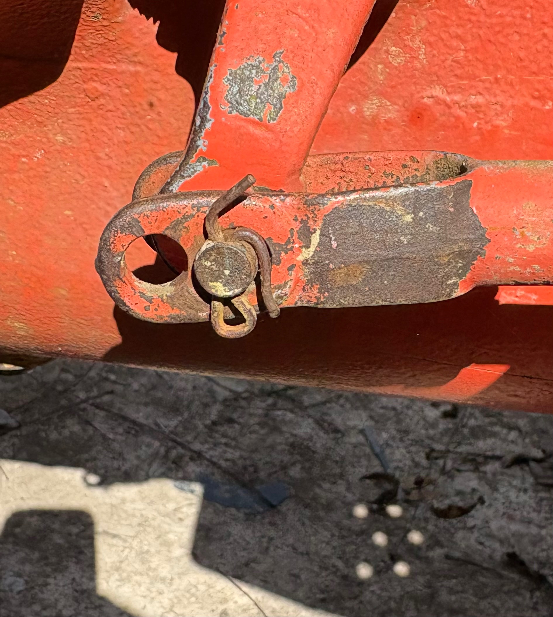

New to me Ford 850 - at least that's what the Engine block says. It is the 5-speed transmission, and when I ran a brush hog, it overran when clutching and pushed me a little - as expected.
So, doing an oil change yesterday, I noticed a few things, the cylinder head is blue - a replacement. More intriguing, the clutch rod clevis has two holes. Currently, I believe, set to the shorter of the two. Now this tractor must have done some woods work, its banged up on the bottom, and the footboards are both abused. It's possible the rod was bent and replaced with one from an 860. What's an easy way to tell a live power transmission from one that's not?

If the bush hog pushed the tractor forward when you pushed in the clutch, it is not live PTO. Non-live PTO is officially called transmission driven PTO, which means that it gets its power from the transmission counter shaft and will provide its rotational momentum back into the transmission drive line when you push in the clutch and apply the brakes. Live PTO is driven directly by the engine using a separate clutch that is not connected to the transmission drive line at all. So when you push in the clutch and apply the brakes, live PTO cannot push the tractor forward.

Easy to test. Move the pin to the other hole, and give it a try. If the pin is in the hole where the two stage clutch is operational the pedal is almost straight up and the transmission is disconnected when the pedal is pressed half way. Press to the floor board and both the transmission and the PTO are disengaged.

If it is a Ford 850, you will not have live PTO. A 860 will.
There was some misinformation about a week ago even by me. One of my senior days.
But if you have a live PTO and the fact that the clutch rod hooks to the clutch pedal on the opposite side (pivot point) from where your foot is the clutch rod has to hook at the shortest connection point. This raises the clutch pedal higher almost straight up IMG_6970.jpeg
If your transmission is marked with the 850 model number it is possible the transmission was rebuilt with 860 parts but very unlikely.

The model number and serial number are on the transmission bellhousing, not on the engine block.
Showcrop . . . this makes sense. In an earlier thread, someone asked about whether they had a live or dependant PTO - he was advised to check the clevis. Not all advice is good!
