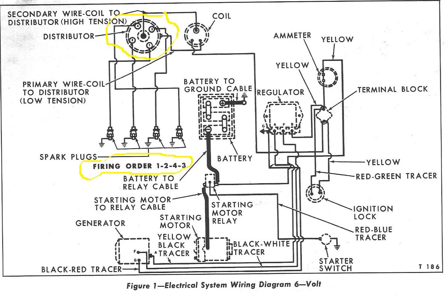

new member I hope I ask this correctly.
My 800 series 6 volt tractor has weak crank. no start. starter has been rebuilt battery checks ok. just get barely over first compression.have taken plugs out and it cranks as it should. cover spark plug holes with finger and stop cranking? am i looking for electical issue or do i need to open up motor? any suggestions. what is correct firing order when i put plugs back in? Thanks

As for firing order 1-2-4-3, #1 front of engine, #4 back of engine, distributor turns clockwise.
Hello Greg, welcome to YT! I was interrupted from completing my reply, during which time Andy was adding information about the firing order. I will just add that the number one plug wire should have a 1 on the distributor cap between its terminal and the center coil terminal. And as shown by his diagram due to the rotation of the distributor shaft the firing order progresses clockwise around the cap terminals.
