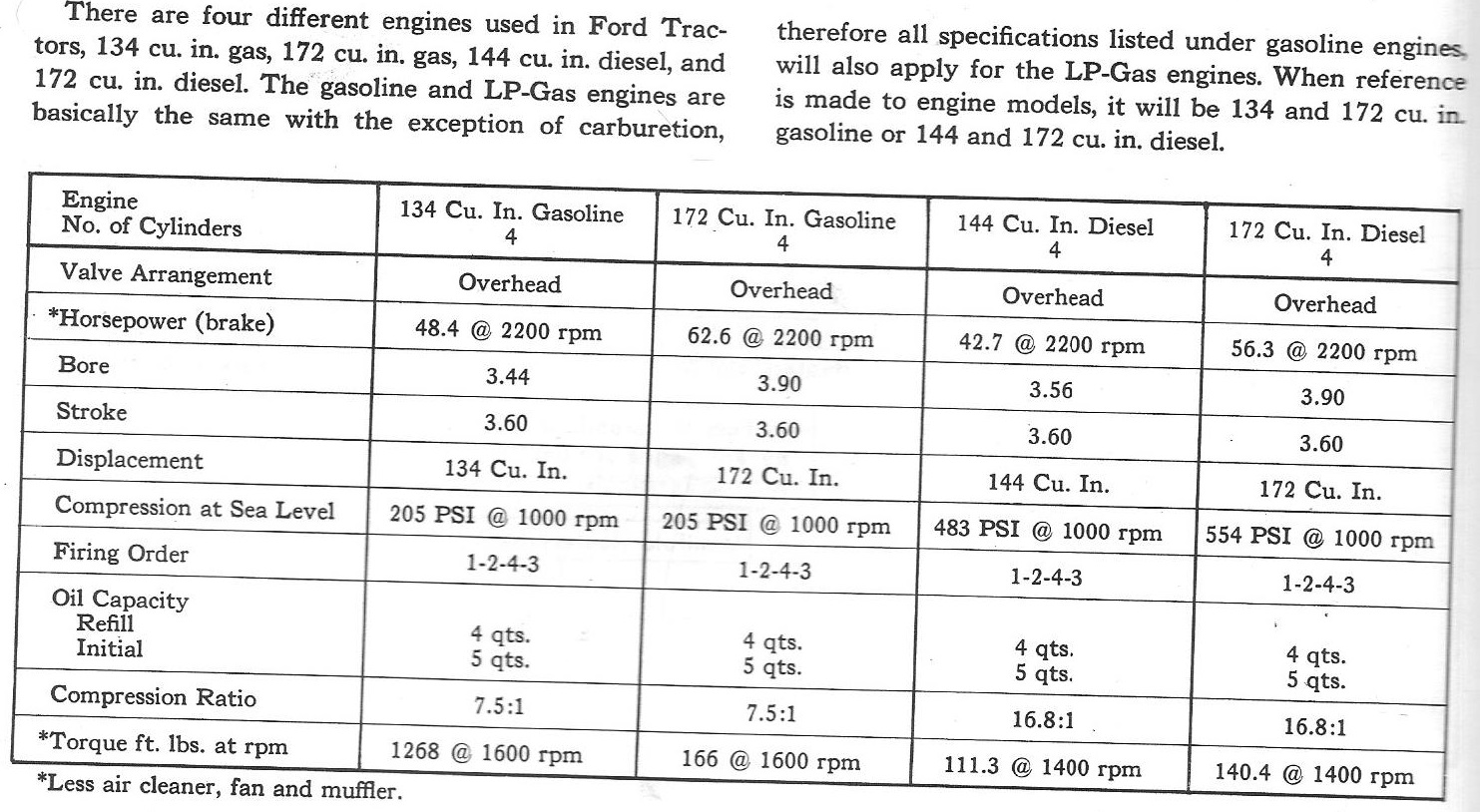

62 HP is brake HP which might be called engine HP, gross HP or raw HP. Below is a chart from the Ford Service Manual Engine Specifications. Notice the note at the bottom, "Less air cleaner, fan, and muffler". If you'd like the see the various practical HPs (belt, drawbar, PTO) look up the Nebraska test for the closest similar model that they tested.
