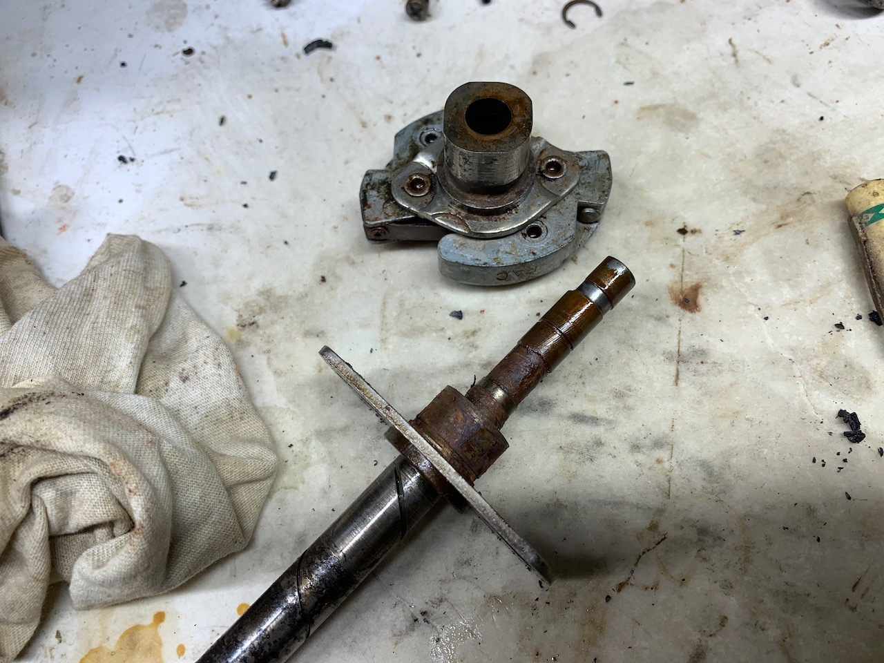

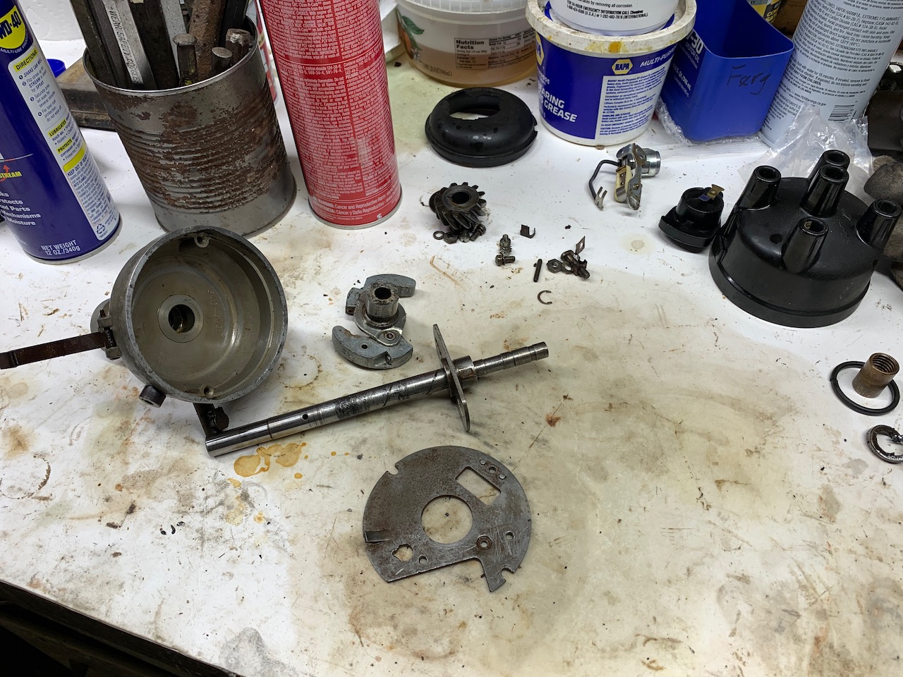

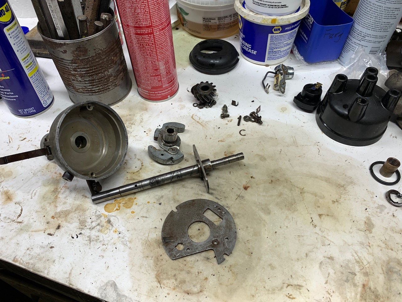

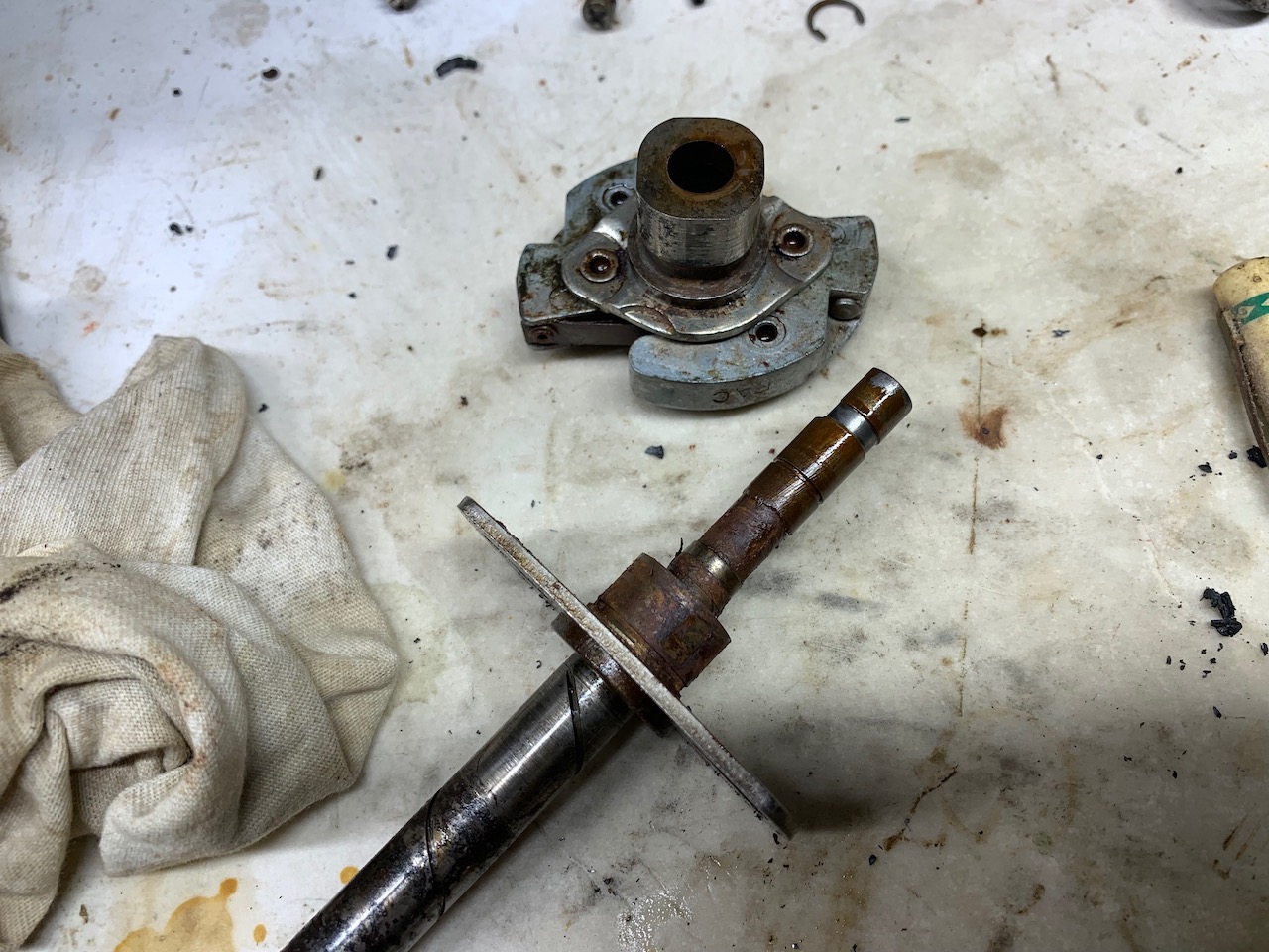

I looked at the timing and when set to 5 degrees BTDC it runs like crap. I have to advance the timing for it to run good. Not even close to the 5 degrees. I'm wondering if there is an issue with counter weights in the distributor. Can I access them to inspect? Are they replaceable?
To access the centrifugal advance, remove the plate on which the points are mounted. Two screws.
Pictures from a rebuild I did a while back. I don't have exactly the picture I'd like...
