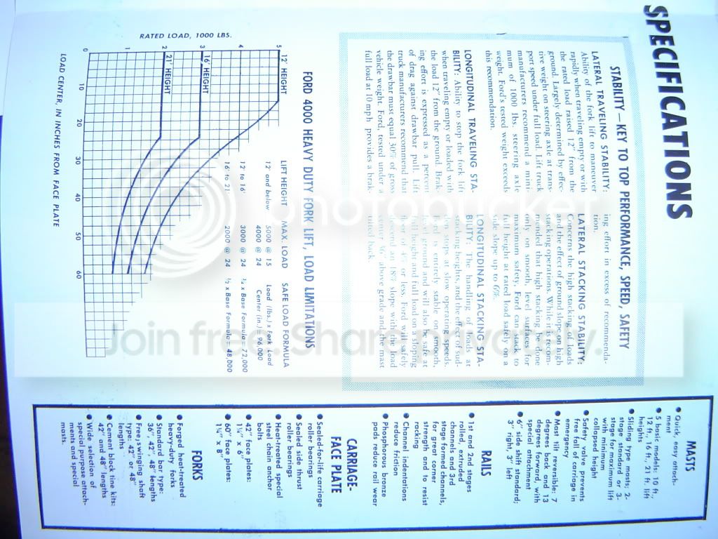

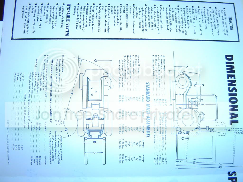

I snatched this from Larry Loy's photobucket page.
Is your fork lift like this one? It's based on the 1801 / 4140 HD Industrial tractor loader hoe. Very nice machines (I'm told - don't have one of them...:().
So, do I have a Ford 4000 Forklift, and 1801, or a 4140? When I look for tune up parts, oil filters, etc., what do I say? Where can I find Larry Loy's photobucket page. Thanks
40601s, that would be a 4000 model forklift. basically the same between the two. The engine in your's should be a paerent block vs. the older sleeved engine. Tune up stuff I would order for an 800, this will cause you less headaches. There were two different series of 4000's, prior to 65 and 65 and newer. Most would look at you funny if you said 1801 as well.

The machine of Larry's is a 4000 series industrial forklift. As others have said, it will be the same mechanical guts in the engine and transmission as the 801 series. The rear end will probably be the same as the 4140. But it's real hard to say for sure as ford used what what close to hand at times...
Just right mouse click the pic and get the properties. That's how I ferret out the home location of pictures. Often other pictures of interest in the same folder, etc. Larry has some excellent equipment and he knows (KNOWS!) a ton about them. I always pay attention when he writes stuff.
John you have a 4000 HD Industrial Forklift made April '62----the 4050--1S--the 1S stands for sherman forward and reversing tran.---most of the running gear is the same as any of the HD industrial made from '58 to early '65
