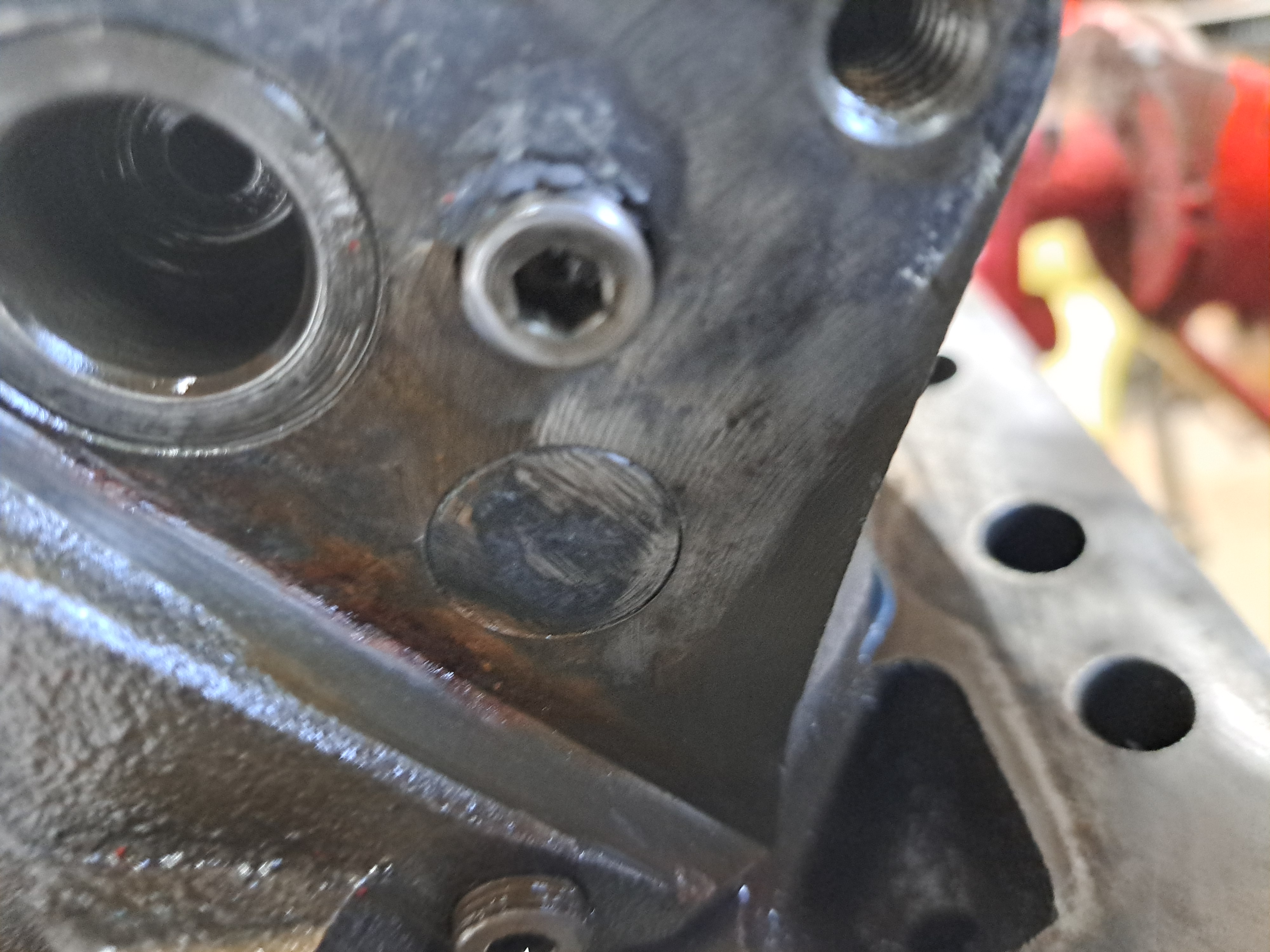

I must be dumb...want change o ring on loader value
not sure what plug needs to punched out.. small one i did try small one..wont move...thank all
That looks like my Power Steering control valve. If it is, then, that smooth round plug has an O ring behind it. The shop manual said to use a small Allan wrench through the hose connection, back side of plug, to pry it out.
