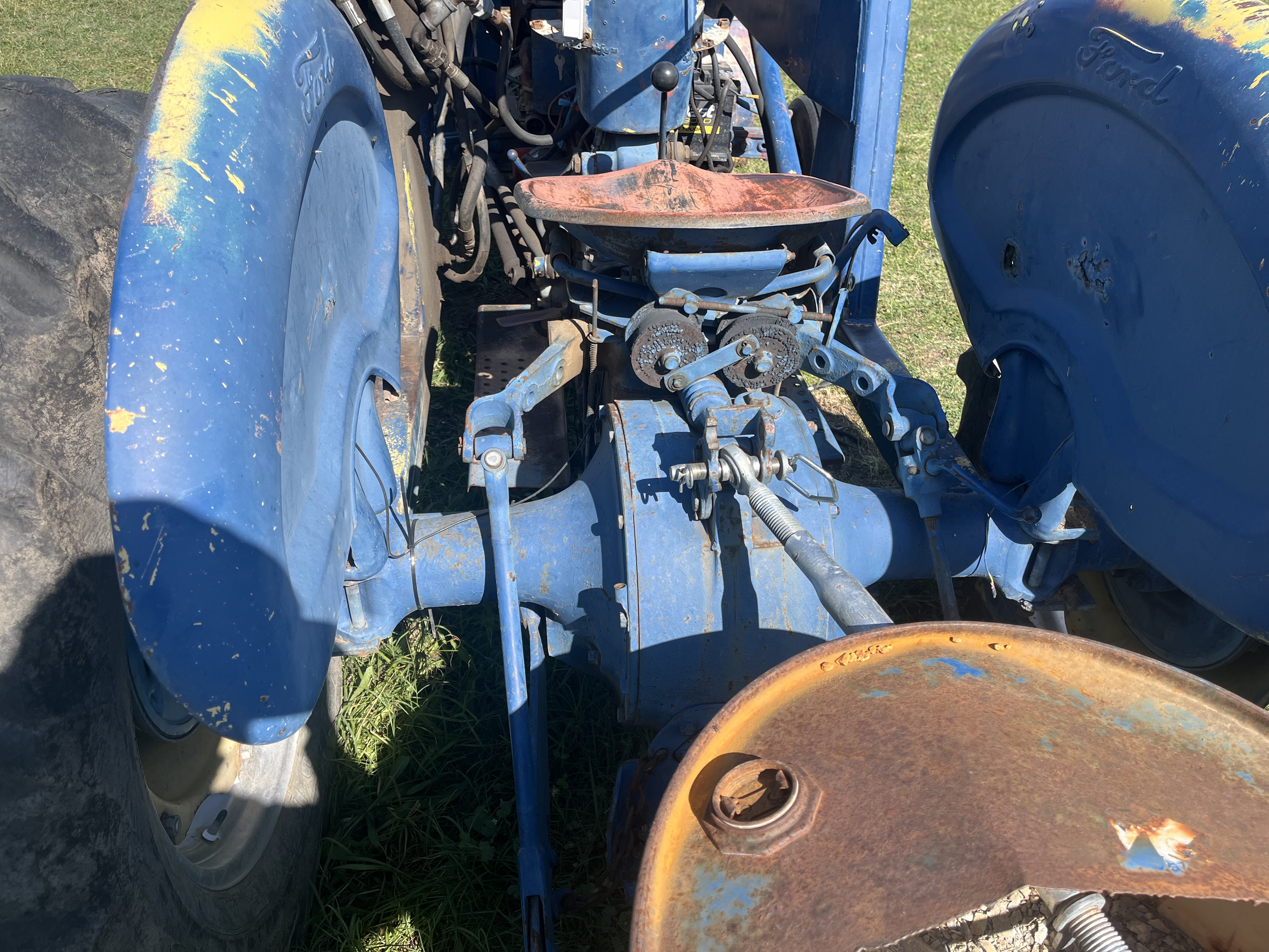

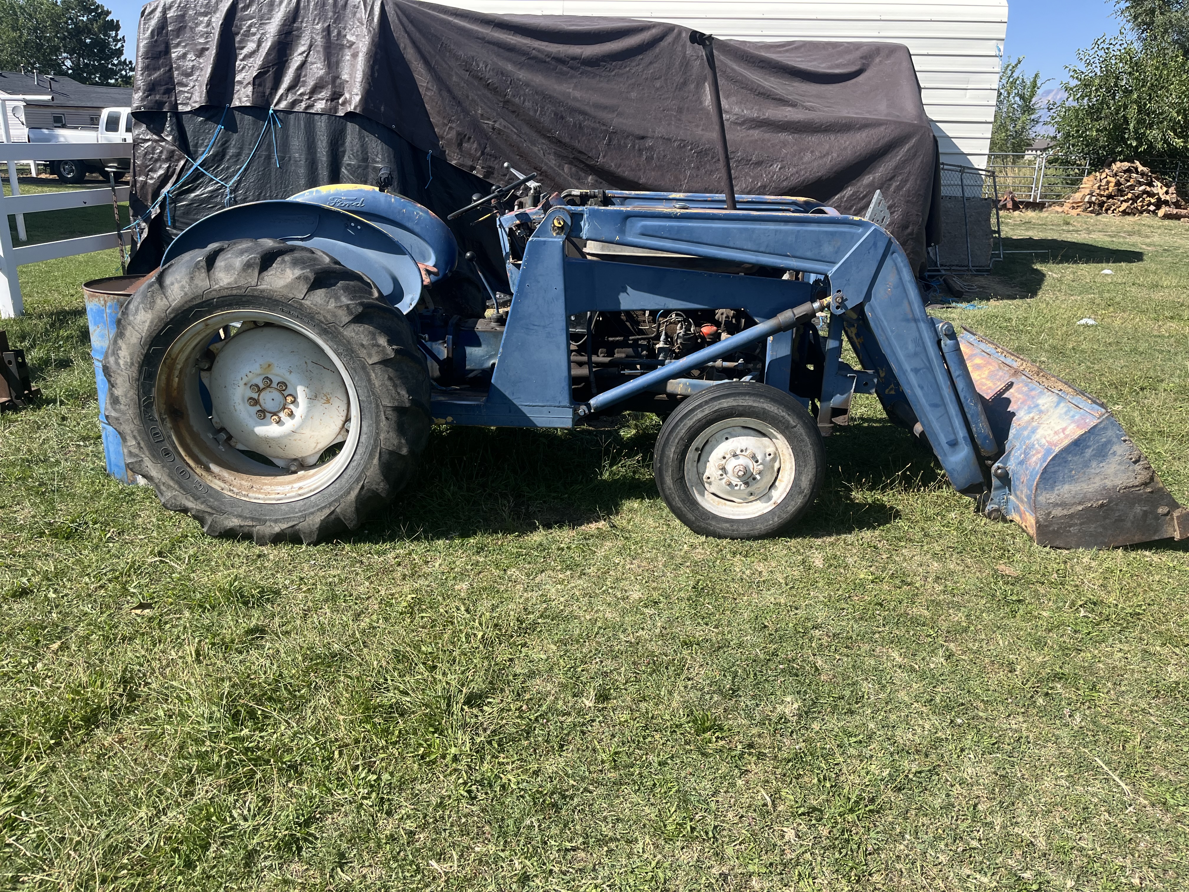

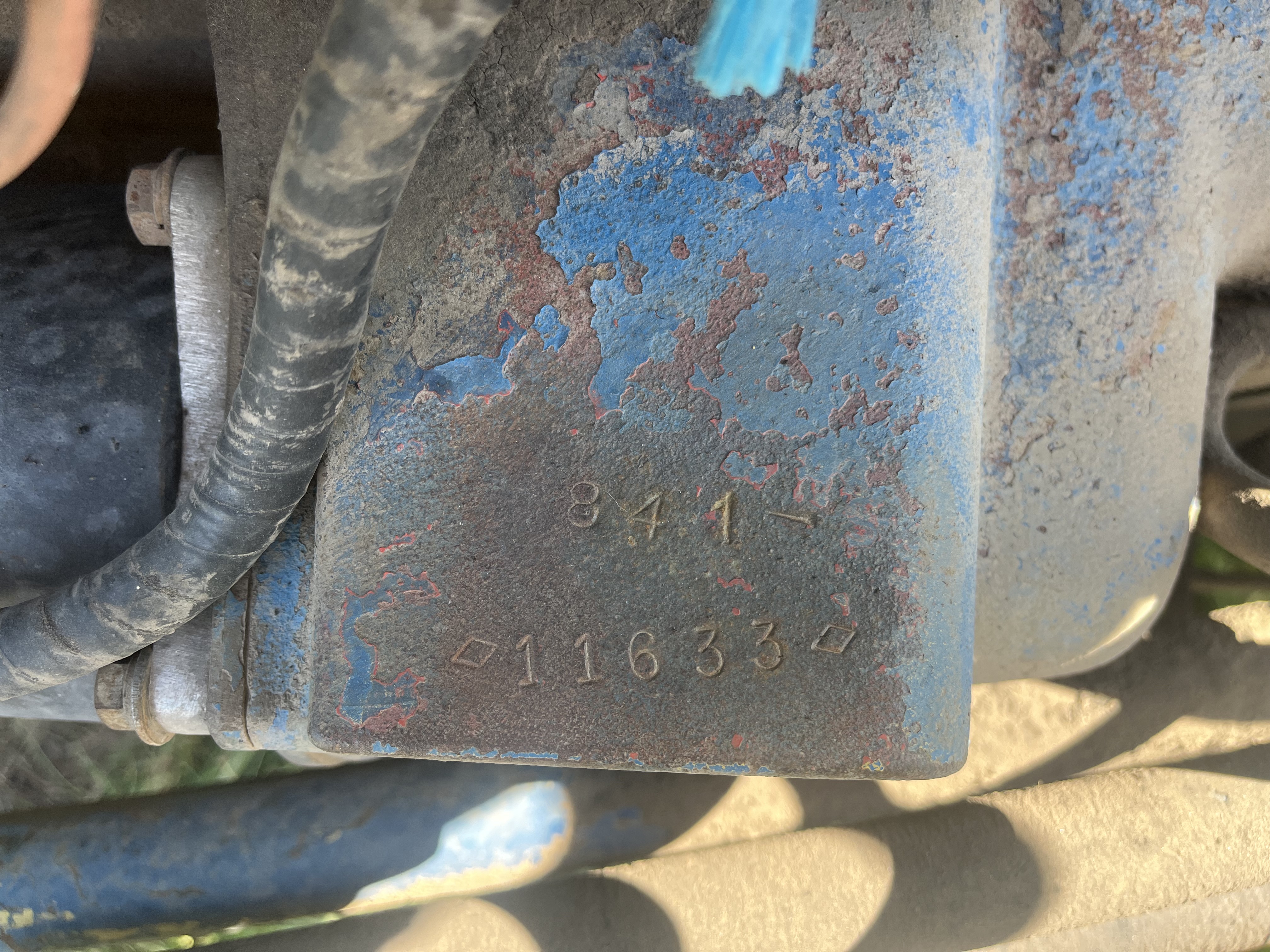

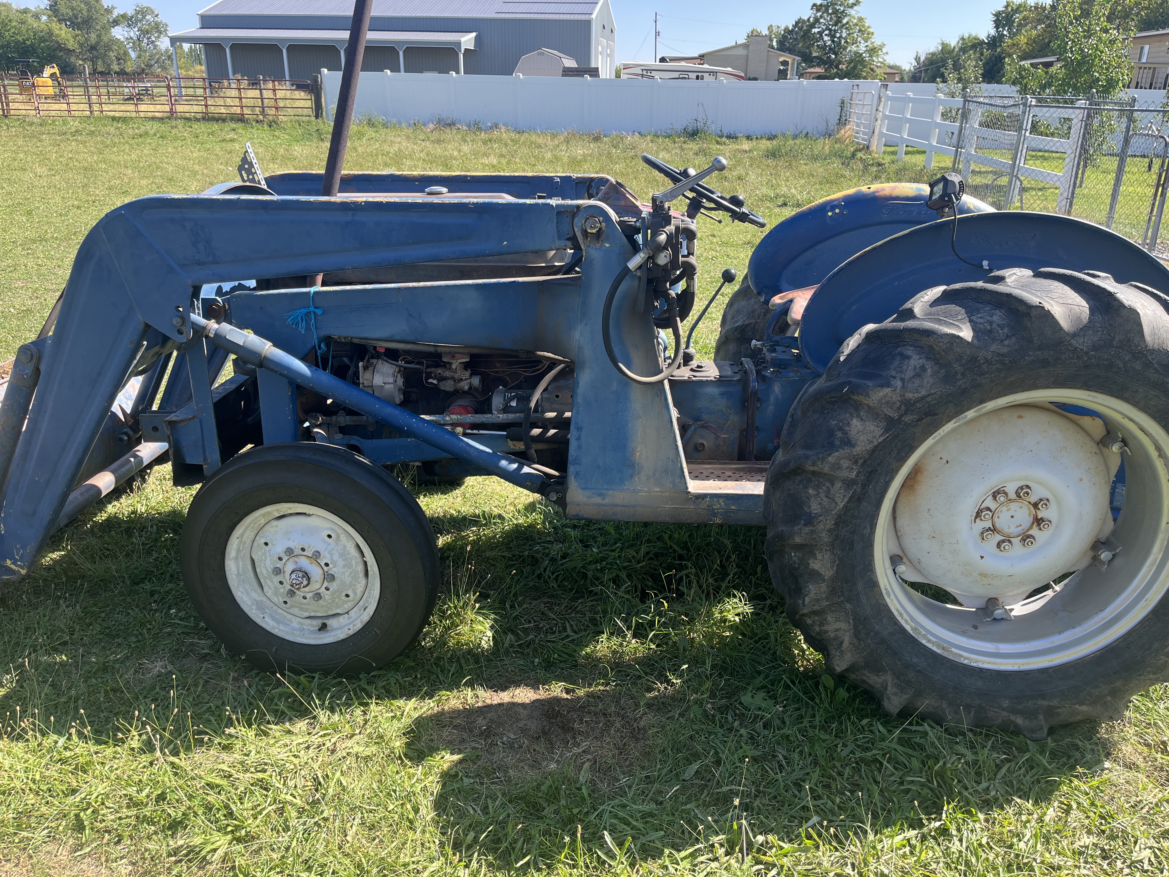

I have had this tractor for a few years and never had any problems with it. Now that a few things are going bad I feel the need to at least identify what model of tractor it is. I have attached a few pictures. There is a stamped “841” on the flat spot next to the starter. I know it’s a Ford. Please help me identify the model. Thank you!

If it is stamped 841 and then below that number is a longer number that will be the serial number. 841 say it is a Model 841 made from 1958 to 1962, it is painted wrong by the way as it should be gray and red in color. I own an 841S and the S indicates it has th factory installed Sherman Combo aux transmission
Upvote 0
I appreciate your quick reply. Yes it has a longer number: 11633. Since it’s a model 841 this would be an 8n tractor. Sorry for the stupid question. I just want to make sure I understand. Thanks again.

9N made from 1939 to 1942, 2N made from 1942 to 1947, 8N made from 1948 to 1952. Jubilee made in 1953. NAA made in 1954. In 1955 Ford came out with the 600/700/800 series which had the valve in head that the N series didn't have
SO NO and 841 isn't an 8N and about twice the HP of the 8N and has live hyds.
