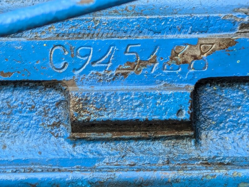

Hi all ! I'm glad I found this website. I have a Fordson 5000 major. I'm trying to find out the year it was manufactured. I have been able to get parts for restoring my tractor. However , still would like know if someone can help me determine the year it was built. I see it engraved in the head of the engine C945488 (Can't make any sense out of that) On the Engine Block " EIDDN-6050-J3167
Thanks and best regards
Looks like your tractor is a 1963 February serial number, built just before the New Performance tractors came out in July. The engine number/serial number has been stamped by Ford at the factory, they used that shape of script, but they have left off the "08" prefix. it should read "08C". If you find some of the casting codes from all the cast parts on the tractor they should start "3" and read something like "3B20" which would be "1963, February 20th". The easiest one to find is on the side of the gearbox where the clutch pedal pivots. Cast numbers like the E1DDN one you quote are moulding numbers and will be the same on every tractor with that block which could date back to 1952.

If it is the one next to the clutch. it has the following :E1ADKN 7007F
Thanks very much Majorman !I appreciate it

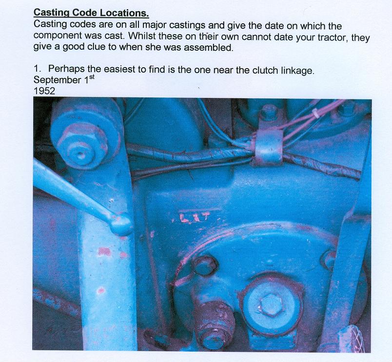

That is still a mould number and of no use when dating the tractor. This is what you need, this one is the earlier format but should give you an idea of where to find it, yours should stat with a 3 as my previous post.
Codes like this are on all cast parts and will indicate if the tractor is original if they all appear around a month apart.
That is still a mould number and of no use when dating the tractor. This is what you need, this one is the earlier format but should give you an idea of where to find it, yours should stat with a 3 as my previous post.View attachment 87281
