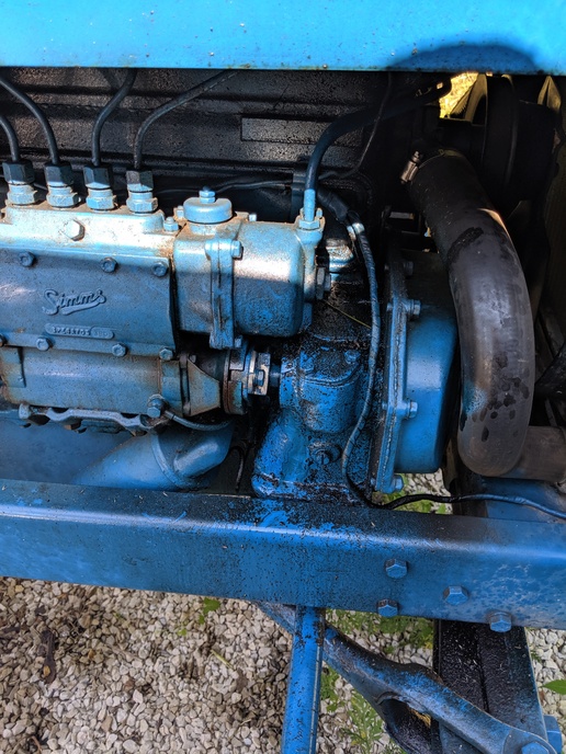

I have a 1954 Fordson Major which is leaking fuel. Appears to be around the injection pump. I am fairly certain it is also mixing with the oil. My oil pressure dropped down to 20 today while bush hogging. Checked the oil and it is slightly over full but also very thin. Fuel was also spraying out around the injection pump. It looked dirty, almost oily. Any help would be appreciated. I'm not sure where to start looking

There is no way that a leaking injection pump can put diesel in the sump, The pump has
no connection to the sump. What could happen however is the lift pump diaphragm can
fail and diesel will enter that way. Another possible cause is the leak off pipe from
the injectors under the valve cover, sometimes the soldered joints fail with old age.
On a 1954 Major an oil pressure of 20 psi when hot is pretty good, what oil are you
using? Should be 30W or 29/30W diesel engine oil.

Here's a picture of the leaking area
If you have diesel getting into the oil from the lift pump it could be thinning down
the oil and causing the injection pump auxiliary drive shaft seal to leak.
In my experience 15/40W oil contains additives which affect the gaskets and seals in
these older engines, not saying that it is a bad or poor quality oil just that it
can give problems of gasket and seal leakage in some of these older engines.
It looks like some of your problems are due to leaks on the front plate gasket. this
could also be caused by retaining bolts coming loose. On your age of tractor there
were no dowels to locate the front plate to the block so movement was a common
problem back in the day.

Hey MajorMan, I changed the crappy battery setup, replaced connections, starter solenoid, did SAE30 oil change, and it's running like a champ. Im not sure if there is actually a diesel leak. Might have just been thinned out motor oil. But the injector pump auxiliary shaft does seem to drip some oil out of it.
Did some bush hogging got her hot and under a load the oil pressure was 35-40PSI. At idle it was 15-20PSI. Are those decent numbers? I am fairly new to this tractor. I've had it for 4 years but never missed with it a whole lot. Trying to get it running like it should.
