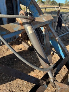

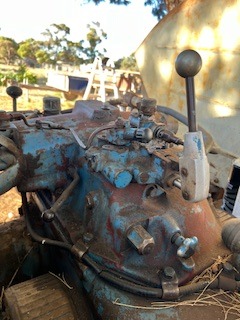

Hello all, this my first post. Recently had a leaking seal on the front in loader ram repaired. I have reinstalled the ram and reconnected the hoses, but the hydraulics will not lift the front in loader now. The rear hydraulics where not working when I bought the tractor. I have included a couple of photos of the controls and ram I reinstalled.
I have recently changed the Hydraulic oil.
regards Stephen.

IF there is a filter or screen was it cleaned /changed at this time or no? IF not it might be your problem the oil flows to slow to let the pump prime again. IF was then probably need to ad a bit of air pressure to it so the oil gets to the pump to prime. Otherwise can't say on this. How cold and how thick is the oil that will affect priming also.
No the filter screen was not cleaned or replaced.
I take it that's what I could feel above the drain plug.
The main return hose is screwed into the filler cap. So not easy to pump air through the filler cap as is not airtight.
Is there any other place that some air could be pumped into the circuit,
thanks Stephen.
The temperature here is mostly above 25 degrees so the oil viscosity should not be a problem.

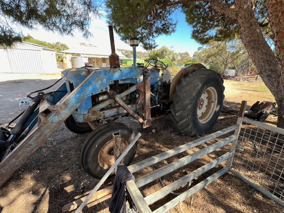

You may need to make a sketch of your hydraulic lines to and from the loader valve so where both ends are connected can be seen.
Back away a bit and take/post a couple pictures of the entire tractor and loader.

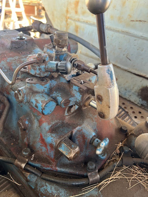

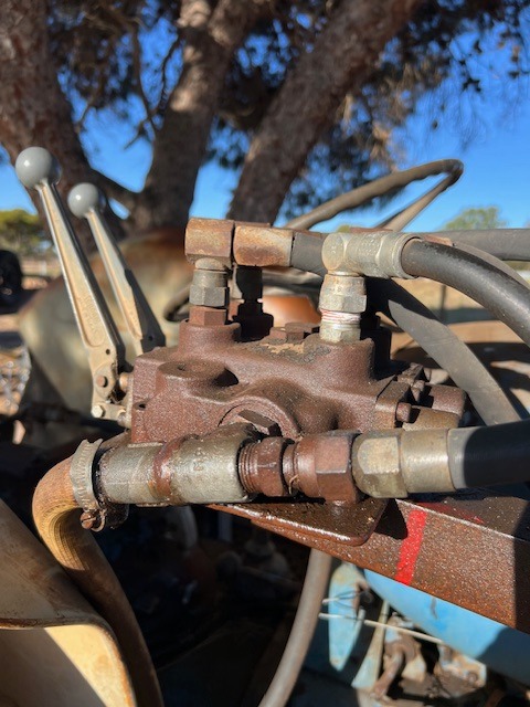

Bought the tractor about 12 months ago, to this time I have only used the front in loader which was working well until I took off the ram. The previous owner said that the rear hydraulics where not working. The setup with the lever directly behind the gear stick has a plate which says MOORE 2895, to this time I have been unable to find any information or a diagram of this setup so I have no idea how this unit works. I have not done any other work to the tractor hydraulics other than to drain the old fluid out and refill it with the prescribed 20W-40. The loader uses the tractor's internal hydraulics which would power the rear hydraulics? No, the tractor was never fitted with a back hoe. Let me know if you need more diagrams of the hydraulic setup, regards Stephen.

Are you in Australia? Moore tends to indicate a Malcolm Moore valve and loader. The valve itself is a diverter valve, it takes the oil from the main pump to lift cylinder feed internally. Some of the valves used did not have the porting to feed the hydraulics on the tractor, unlike the proper Fordson Valve but these are like hens teeth. Seen a lot of the valves like in your picture over there.
The oil flow is possibly not going anywhere near the tractor internal systems so your problem could be in the valve itself, the "O" ring on the pipe from the pump to the top cover or from the pump itself. Perhaps the easiet method of trouble shooting would be to remove the Moore valve and put an original Auxiliary Service Chest on in its place, you might be able to borrow one to try, one from any Super Major or Fordson Dexta will fit. This would eliminate pump and any internal faults.

Due know what the two position on the Moore Valve are for?
I have taken it to pieces. It has a tension screw assembly behind the lever attached to a spring mechanism which allows the lever to be moved in two positions either forward or backward. Not sure if this pertains to the front in loader or controls the oil flow to the hydraulics, regards Stephen.

Regarding the valve, I have no experience of the Moore valve but can explain how it works, the two positions are because it is a valve for a double acting cylinder, one that both pushes and pulls. The oil comes out of one port when the lever is moved and returns through the other. When the lever goes the other way, the oil flow is reversed and the return line becomes the pressure line and the pressure line becomes the return. Be careful how you handle the parts as the valve works on around 2000 psi and any damage like a burr or scratch will make the valve scrap.
Do you use the valve to work the loader?
Whilst you have the valve off, you have a flat area where it fits on the top of the lift. Pull the engine stop and operate the starter, oiul should come out of one of the holes on the left side of the plate (if you are looking from the front, right side from the rear). Put your thumb over the hole and see if the pressure will lift it off. This is a very basic test to see if the pump is pressurising. If not or if you see no oil, your problem is the pump or pipes in the rear axle.
There is a flow control valve in your Moore valve similar to the one in the original ASC on the Super. This can stick and give you problems as you have. You may have to find a hydraulics shop to check that out for you.
