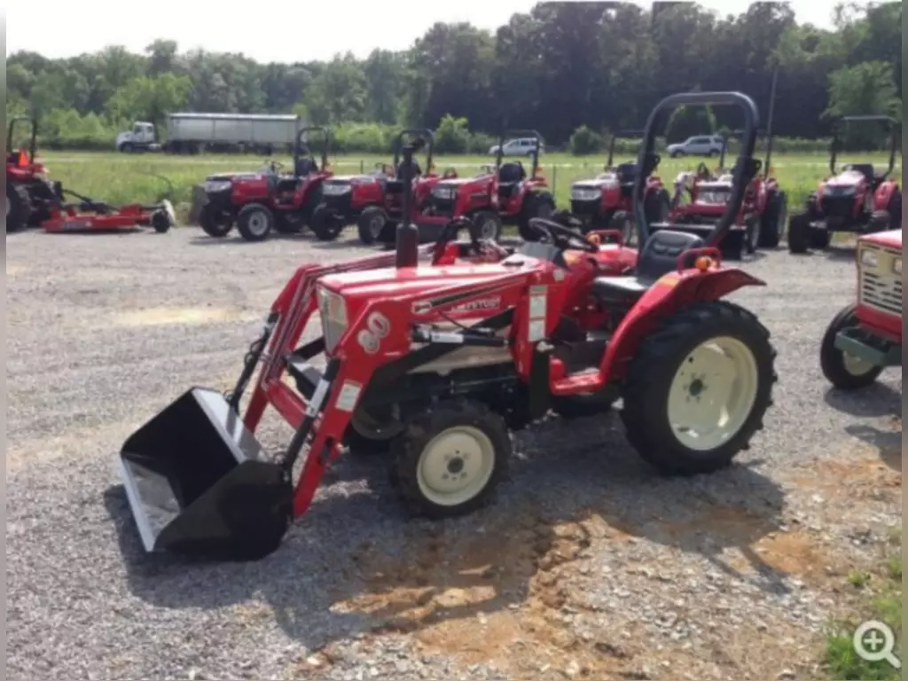

I am looking to purchase a front loader kit for my YM 1601D tractor.
Can anyone suggest a retailer where I can purchase a kit?
What Winston said,
https://coldwaterloaders.simplesite.com
Also Yanmars use the Koyker loaders too. The YM1610D takes the Koyker 80 per Fredricks info.
See the attached Koyker 80 manual.
Price both places and depending on location the shipping costs.
Loaders to avoid are,
VTek made in Vietnam. There is no information on how to repair them.
BullDog is made in China. There is some info, but not much.
Some of the Mitsubishi, Kubota and Shibuara loaders fit too.
Depending on loader size, your machine may need a sub-frame, else the frame will twist snapping the tractor in half.
