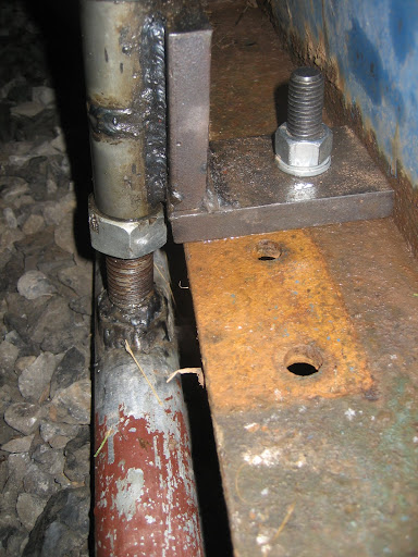

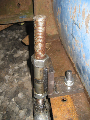

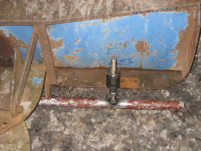

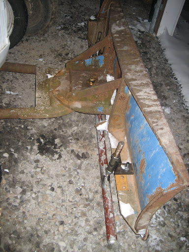

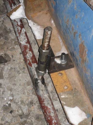

I have a front mount dearborn plow rig on my 9n. It works great on my 250 foot stone driveway. I welded a pipe on the bottom instead of using the plow skids. Works so much better for me on the stone driveway. I have good chains and loaded tires.
Plowing this way takes a little more time, but it beats being inside!

Any chance you could post a pic of the blade? Thanks.

Hope these help Popster.
Pretty simple stuff. The all thread is nice because I can lift up the plow and set the depth in a minute or two. I had the pipe set so about an inch of snow was left for a base on my driveway. I was able to push snow into good size banks across my lawn. No tear up on the grass either.
Good luck.
TB
Awesome! I am located in Spencer, NY. South of Ithaca. I did buy the front blade. It is rusty but seems solid...sure was heavy getting it into my truck. I will post a pic soon. I am going to tear it apart and paint it before I install it. Bring on the snow...easy to say since it is 91 here today!
