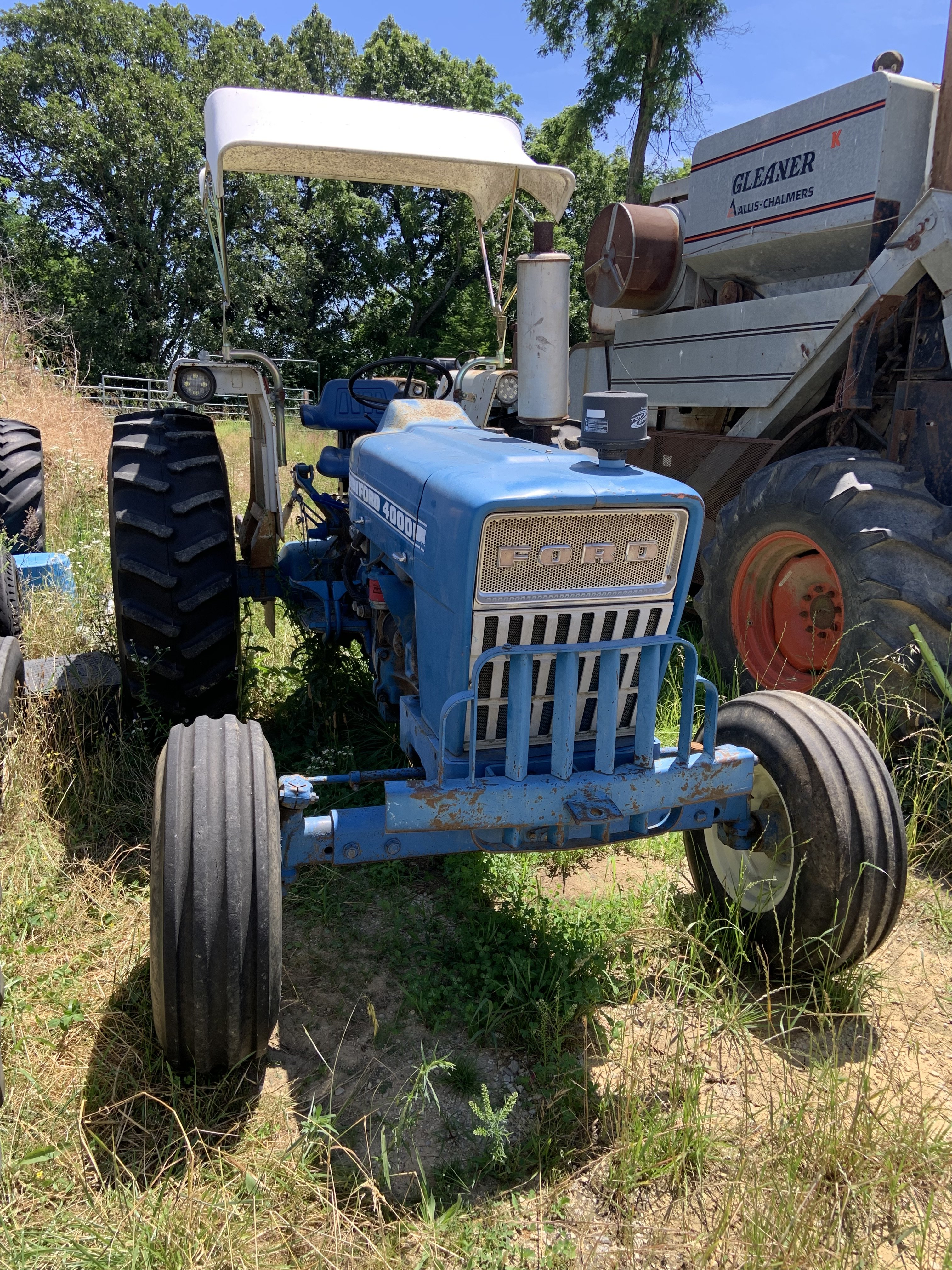

I run 9.5L-15’s on my Ford 4000 and Farmtrac 555

9.5L-15 on the 555
9.5L-15 on the 4000

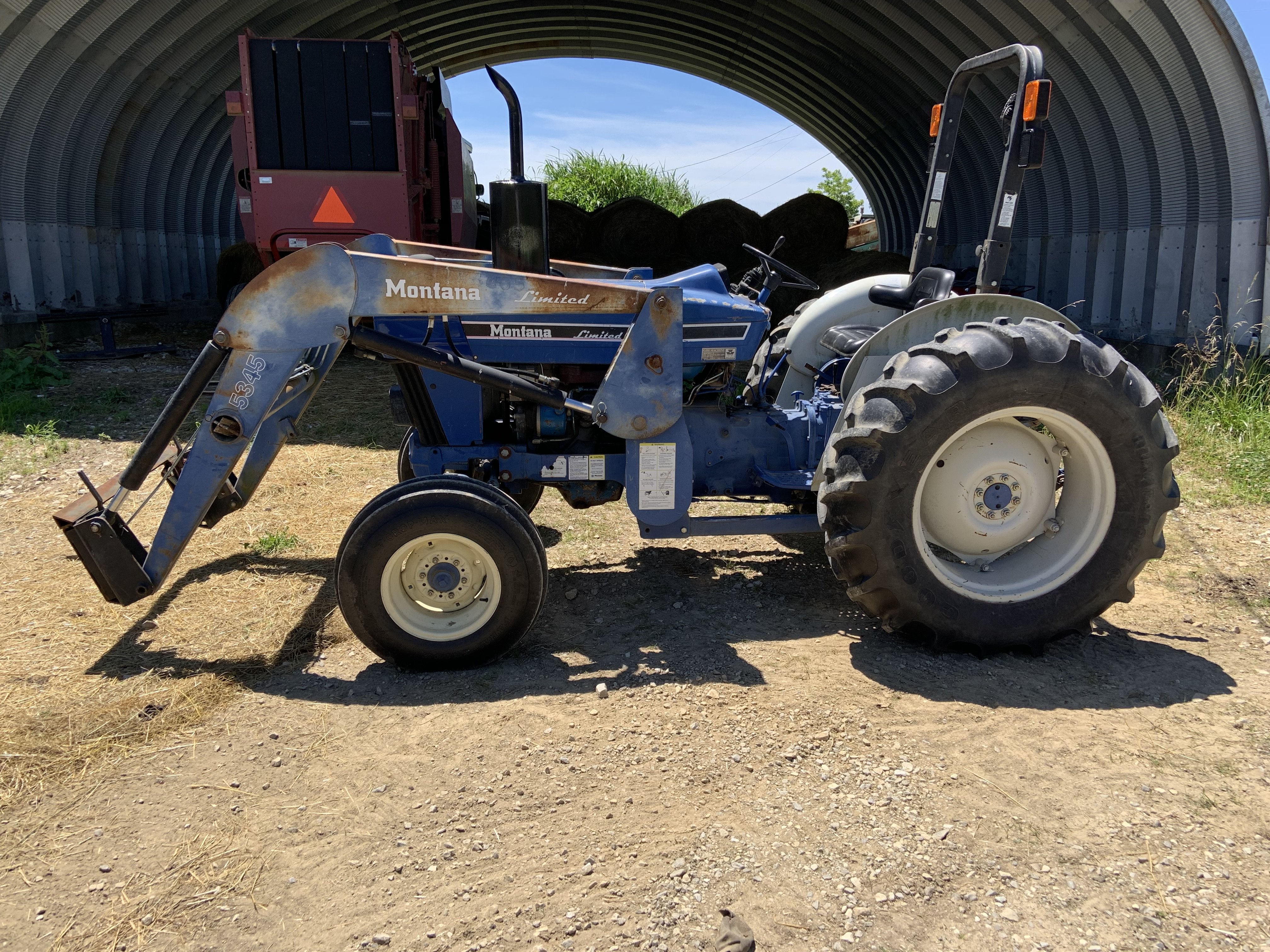

My loader tractors do not use rib tires.
