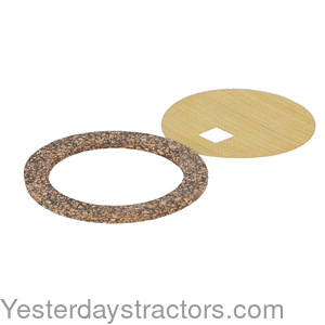

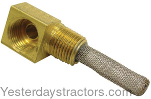

Also the sediment bowl shows an inlet strainer. Would suggest getting one after when you have that the tank flushed .
YT offer these for 8 n as example
