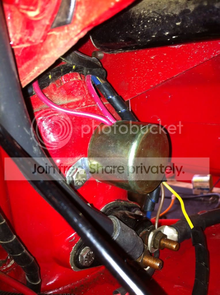

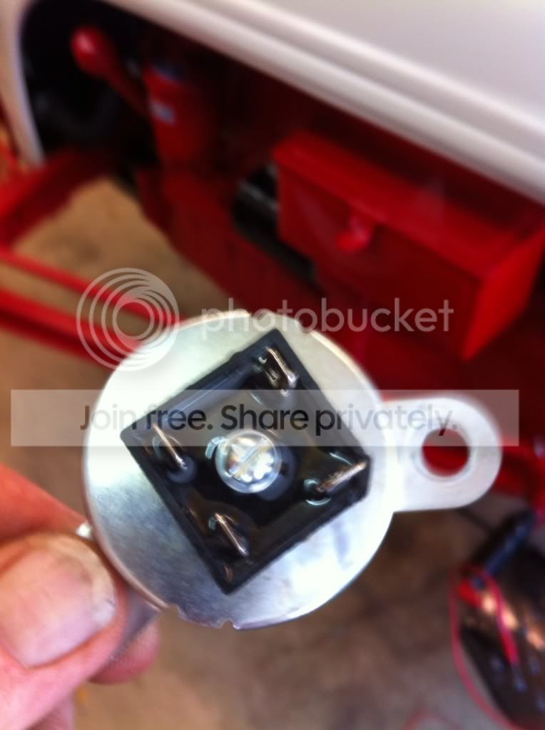

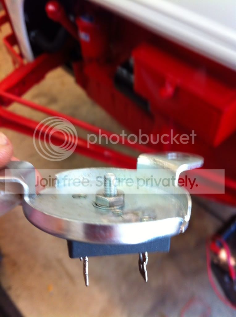

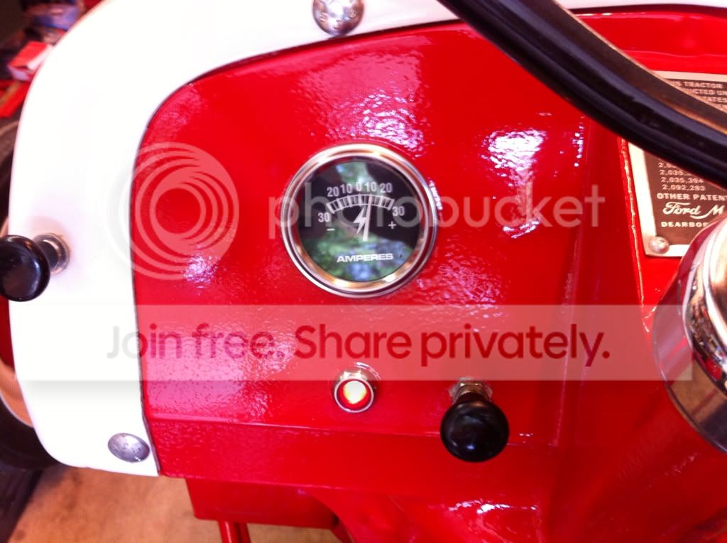

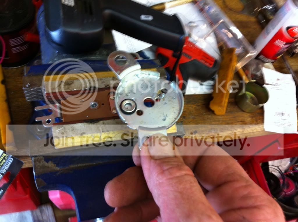

Full Wave Bridge rectifier conversion pictures
I got side tracked with an air compressor but did install the
Radio Shack Full wave bridge rectifier part#275-1185 25 amp, 50 volts
a

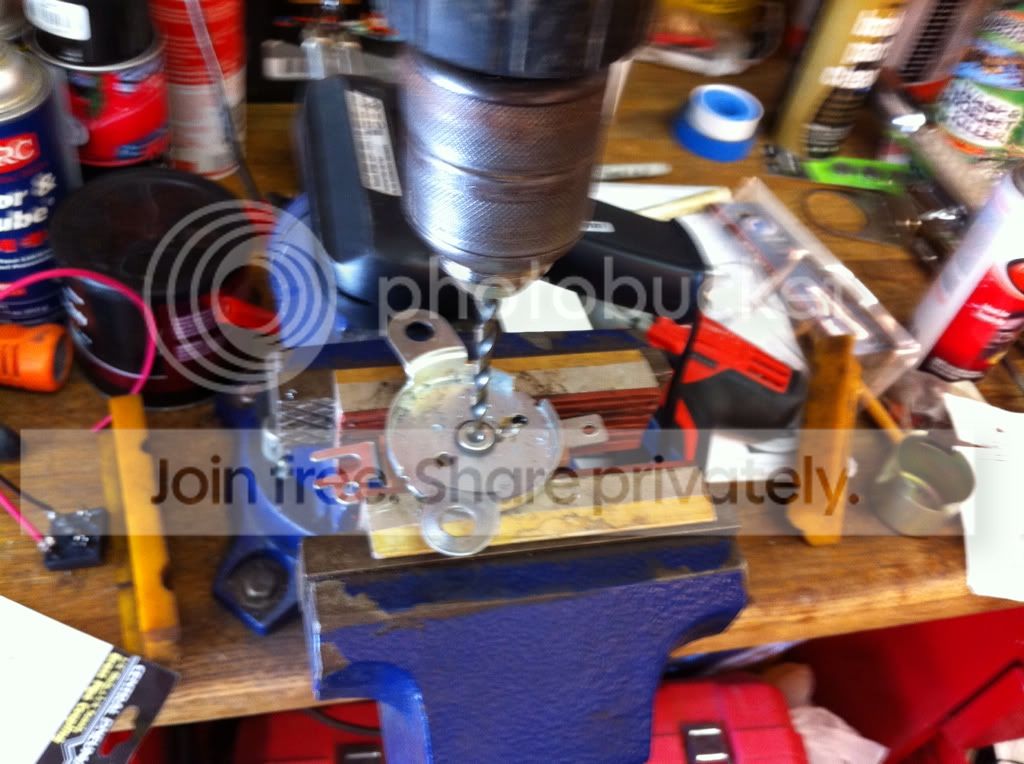

Drill out the 2 wire cut out relay remove guts, file off the small knub on plate.
Installed heat shrink and spade terminals.
[/img]

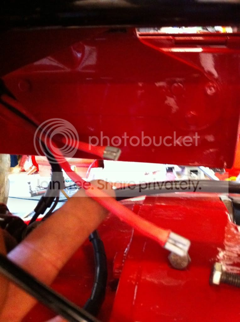

Generator wire gos to the positive terminal AKA the one opposite of the other three, used a volt meter to determine which terminal to put the battery on chose the one with 6.5 volts DC
Cable ends look awful close on the starter switch.Dont forget the diode has a.7 volt drop that produces heat.
you have really got to stop loosing sleep about that pitifull forward voltage drop.
you do realize you are sweating about less than 8w on a case that is designed to dissipate many times that???

t is just 4 diodes in a common package, wired to provide rectification of 2 wire AC input & yield 2 wire DC output, which has nothing to do with the application in the tractor. People use it to replace the electromechanical cut out on 9N/2N tractors. It is just a readily available diode from the omni-present Radio Shack Stores. They don't sell a single high current diode, but do sell the 4 diode bridge package for high current, so people buy it, connect one of the 4 diodes & let the other 3 sit idle. The 1 connected diode acts like a check valve in that it lets current flow from generator into battery, but prevents the reverse, i.e., prevents the battery from discharging into the generator.
Are you not aware that only 1 of the 4 diodes in a bridge rectifier package is being used?
A single diode is all you need to prevent the battery from discharging back through the generator due to a bad cut out relay.

f you leave a bit more of the original cut out base, then it will look virtually stock, like this:
https://photos.yesterdaystractors.c...=5&Parameter=cutout&w=pieces&cc=0
https://photos.yesterdaystractors.c...=5&Parameter=cutout&w=pieces&cc=1
Humph I may go dig in the trash can and change it looks better should only take a half hour or so.
