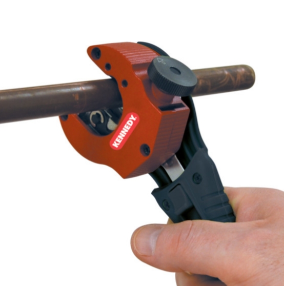

Cutting the pipe straight in a tight place is not a problem with the right tool..
Ridgid makes a good ratcheting pipe cutter..
I think those ratcheting cutters are great, but based on the original picture I'm not even sure there's enough room for one of them (or a ratchetting threader) against that wall on the back.
