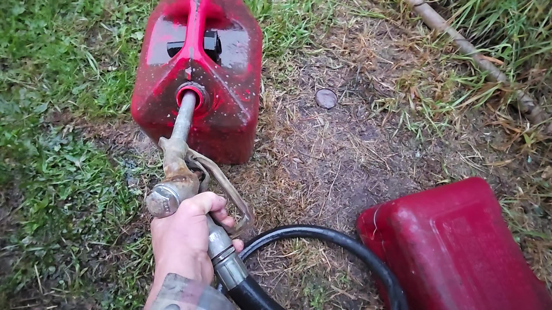

I have a gas barrel on a stand for tractor gas.
I've had trouble ever since I got this tank, when it sits there for a few days and you go to get gas the hose is air locked. If you stick the nozzle in the tractor tank no gas will come out. To get gas you need to lower the hose to near ground level and run some gas into a can. When you do that some gas comes out, then some bubbly gas, then good gas again. After that it runs freely into the tractor. The tractor tank is below the level of the bottom of the tank. Here is a short video of what happens. It's not great because it's was hard to do.
If you watch closely you can see that at the hight of the tractor tank nothing comes out even tho it's lower than the bottom of the tank. And the tank is full now. Then when I lower it gas comes out, clear first, then foamy for a bit, then clear again. After that you can fill the tractor tank.
Judging by the amount of clear gas that comes out first the air must be caught at the bottom of the hose when it's hanging. I have replaced the hose, filter and filter base and nozzle trying to solve the issue. What I can't figure out is how air is trapped at the bottom of the loop. If you leave the nozzle on the ground so there is no loop there is no air lock. I hung the hose over the valve so there was 2 loops and I got 2 air locks. This is not a huge issue, I'm just completely puzzled by how it happens. Any ideas?

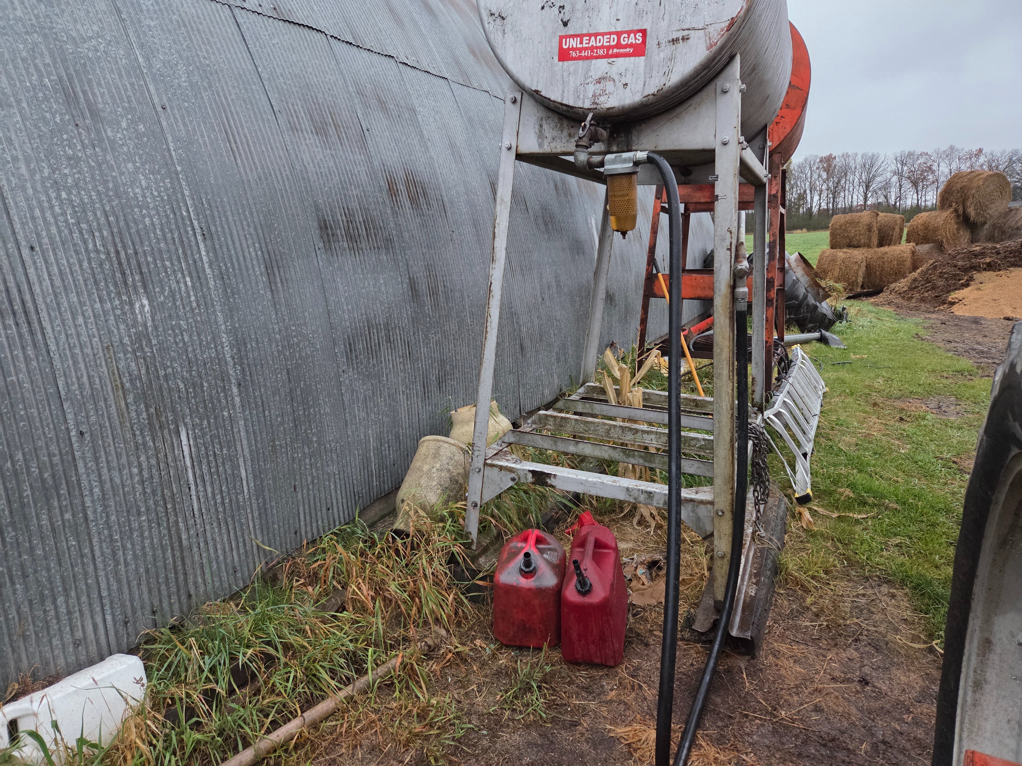

I see Line coming from filter is kinked , is that correct in photo ? Suggest hard piping vertical down , don’t know if this the issue ,worth look see .
There is no kink in the hose, but an elbo there would be good. I'll put it on the list.
