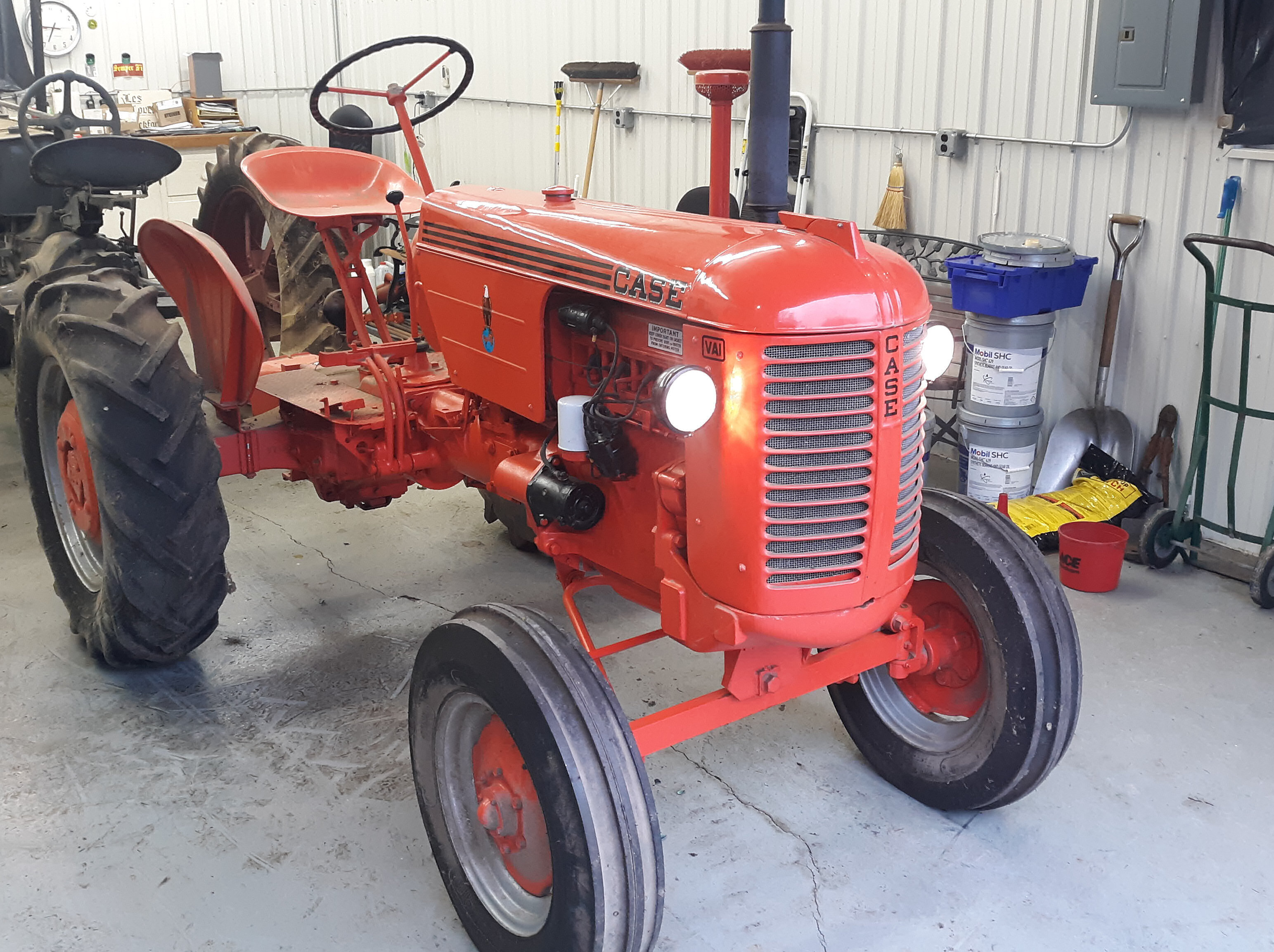

Would this oil be good to use in the letter series transmission/rear end? I know this is fairly thick oil, it is an ISO VG 220. And these tractors are not used in cold temps, mainly temps between about 70-100F
Is the 220 the weight of the oil like 80/90 is the weight of the oil used in DC rear ends? Seems to me it would be quite heavy...and more expensive. But you probably lucked out and stumbled into some free oil, lol!
Yes I did, 30 gallons of it for free! New in sealed buckets. They switched to a food grade oil at work and said this needs to go away. Lol
ISO 220 is the same as 90 weight gear oil.

Perfect! I thought it might have been a 220 weight oil or something. But sounds like this will be just fine. Thanks 👍

If you look in the background, you might get a hint at what I've found is effective, if not a little bit costly.
