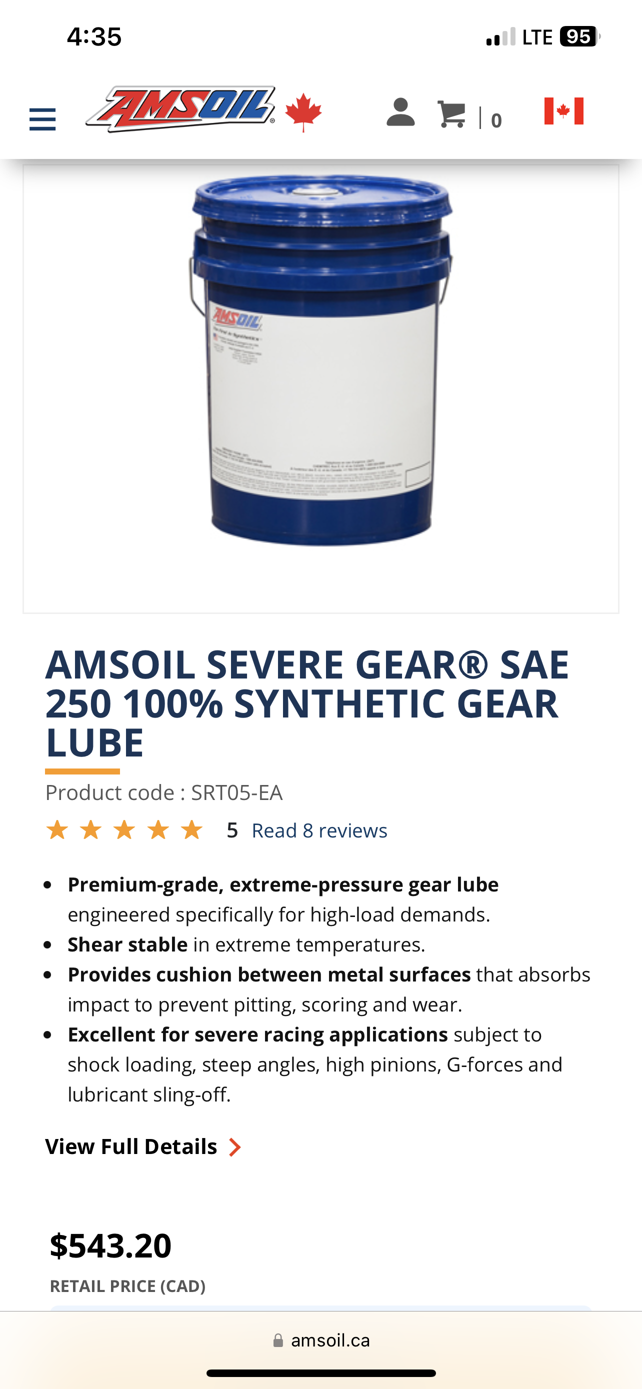

Amsoil. It will turn that rototiller into a Caterpillar D11.
While moms had lasted 50 years I would think a 5 gallon pail should be enough for 500 years and be more than what was originally paid for it.
A quart or 2 should do we drained it once in the 2000s. I can’t remember the capacity
Those little things are bullet proof a d11 is a closer comparison than one would think 😊
