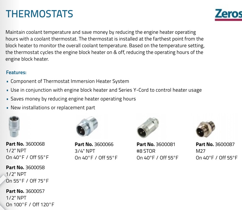

How about this heat lamp 2 pack available on Amazon. Advertised as having a life of up to 5000 hrs. Thermostatically controlled it might get you through a season. Higher wattages available. I have some and they seem to work well.

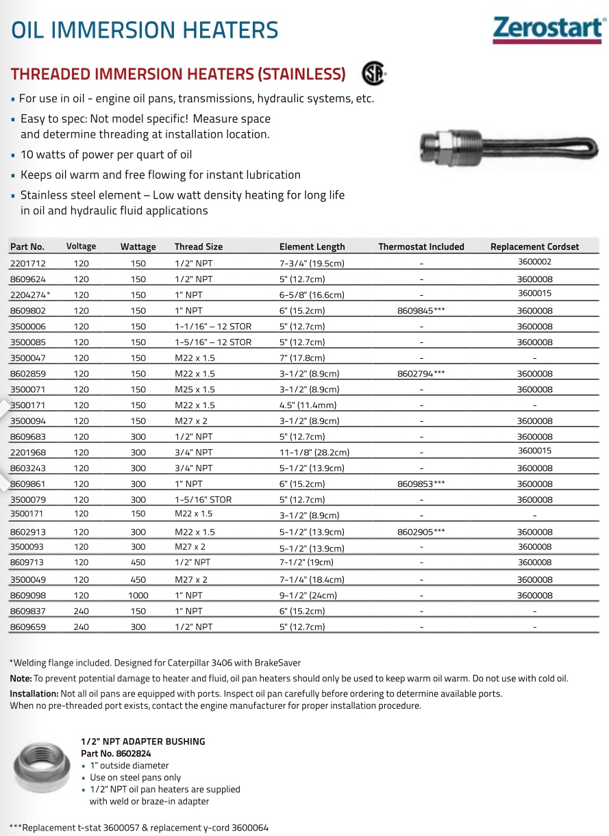

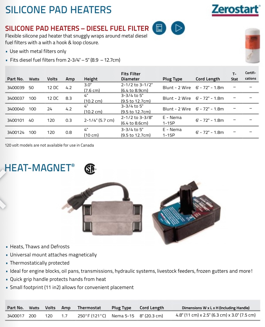

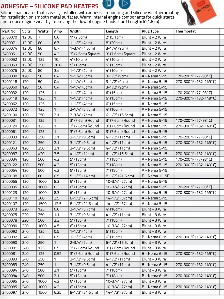

The silicon pads work fine but you have to be sure they are stuck and no parts lift off of the pan. I stuck mine on and then sealed the edges with high temp silicon. If the pad isn't in full contact it will burn up. They also make magnetic heaters that you can stick on the oil pan.
If you go the heat tape route use self regulating stainless sheathed. It can be crossed over itself where the plastic style will burn itself up if you cross it on itself, don't ask how I know. The self regulating doesn't require a thermostat and can be bought by the foot at many electrical supplies, you just put the ends on yourself.

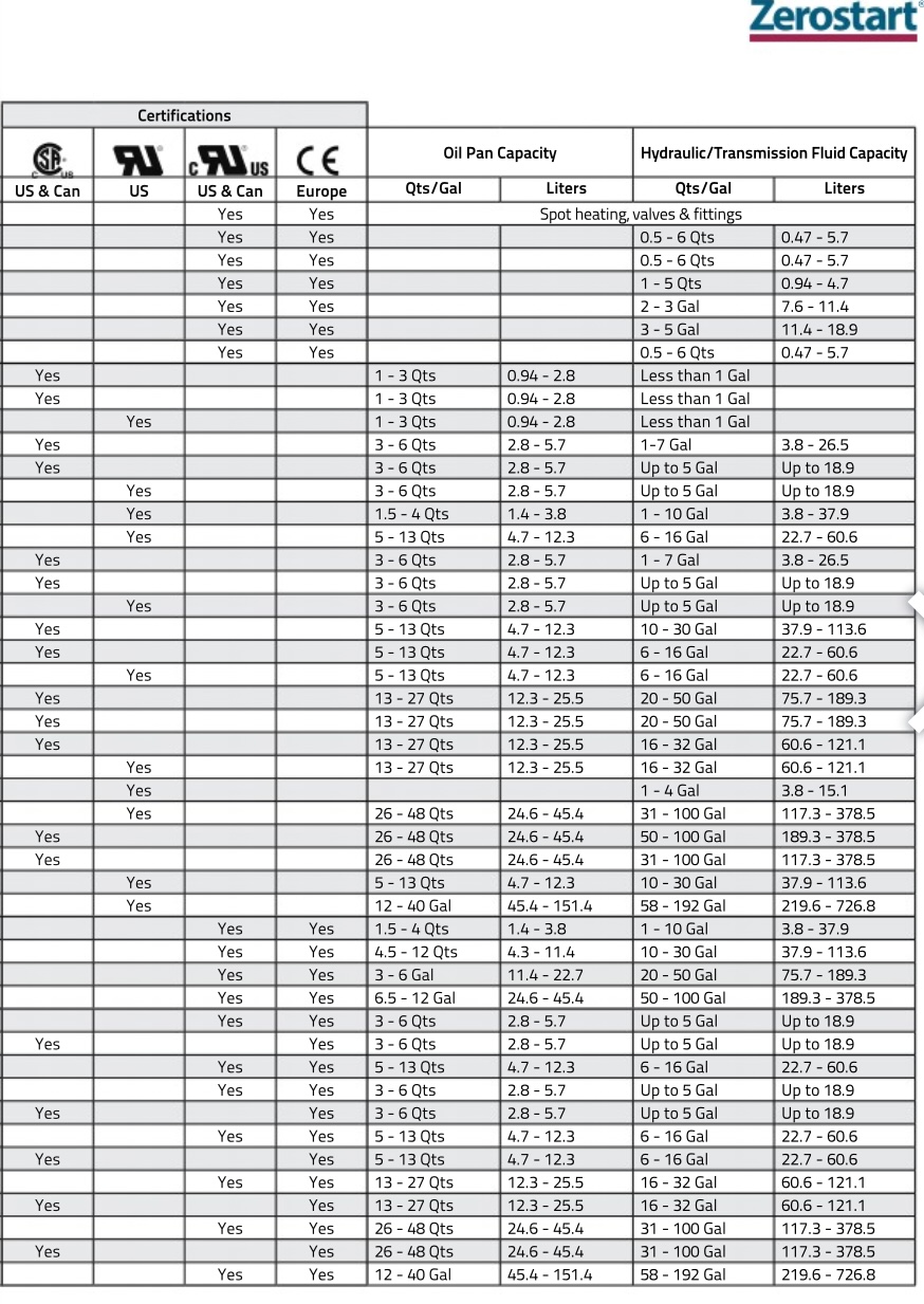

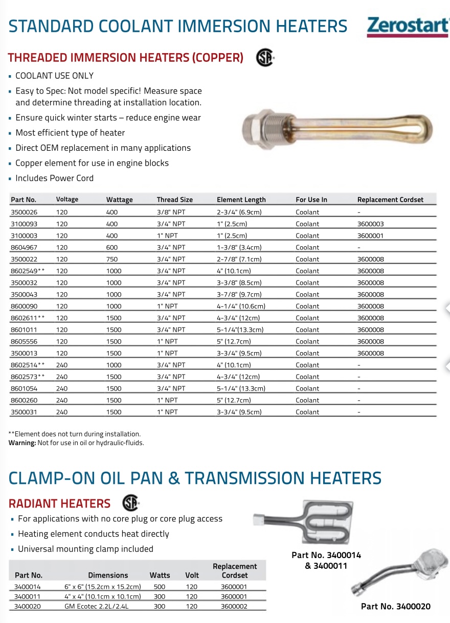

I don't know how much oil is in the pan you're looking to warm up? I have two 200 Watt magnetic heaters that I consider useless for use on oil pans.. They seem to get very hot but not the oil. When I had an inline 671 Detroit diesel I had a 300 Watt heater, brazed in on the side of the pan, that would heat the whole engine. In moderately cold winter weather I didn't even need to use the block heater for good cold start up, the oil would be very warm.
I'm GUESSING his little aluminum v-twin doesn't have an actual (steel) oilpan beneath it's aluminum block, rendering a magnetic device useless.
You got it. But under the aluminum bottom, there is a steel motor mount that covers the entire bottom of the engine. I found last year that the heat would go through the steel plate to the engine bottom. This was how I heated the engine oil. It worked flawlessly. I'm going to clean off the bottom plate and stick the silicone pad directly to the plate and try to seal the edges with high temp silicone as previously mentioned. I also shoved glass wool insulation to block off any heat loss and provide support to the stuck on pad. Hopefully it will last another year. Thanks
