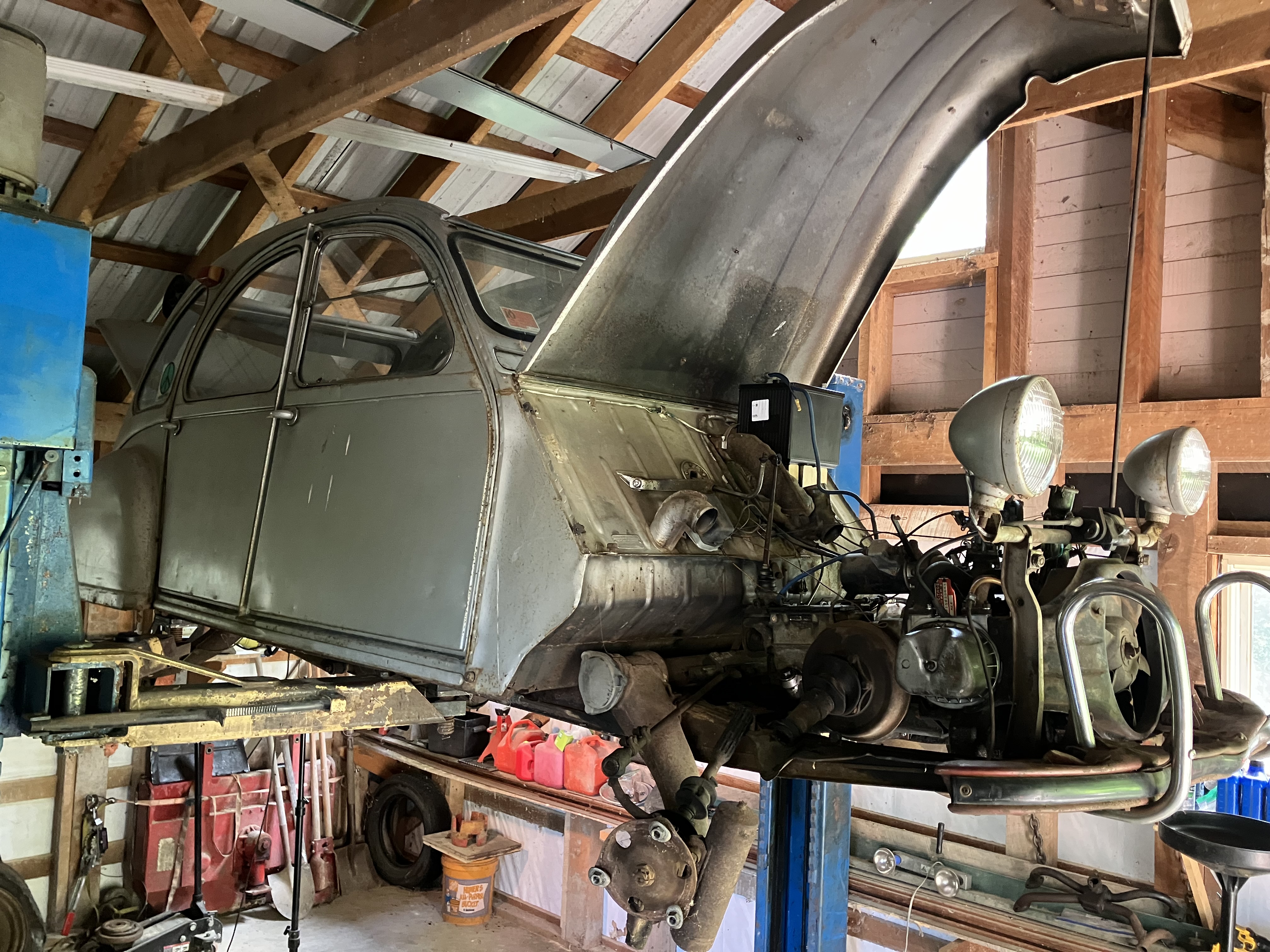

I’m working on my ‘66 Citroën and need to get the brakes working. It was parked for at least 20 years before I purchased.
I pulled both rear drums. Brakes and related parts look new.
I opened both bleeders, not even a dribble. Pedal feels very hard. Master is full of fluid and actually looks clean.
I understand how the system works, it’s a typical old car with drum brakes. But I don’t know the things I should check now to get brake pressure. Attached is a photo I grabbed from the web because it looks much better than my car. Thanks in advance for any suggestions.

Is it possible a line is blocked with rust or other debris? Don't know much about French made automobiles.
Vito
Could be. The setup looks like any other old car with hydraulic brakes. Some hoses and some rigid steel lines. Maybe disconnect the master and see if I can get any action when I press the pedal.
I’m not there to look at it or get any clues, but with the car at 60 years old, I’d be very leery of the brake lines and especially the rubber lines internally flaking off and acting as a one way valve. Loosening a few selected brake lines should help investigate this thought.

Hmm. A '66 model, if made to pass US specs, would have dual braking systems. If that's the case, then there should be a proportioning valve somewhere. Those are prone to sticking; I'd check and see if you can get anything out the front bleeders.

I agree with you. Those flex lines are very likely shot.
It is also possible that incompatible fluids have been added years ago.
No. 1966 was single pot master cylinder. I have a couple 66 cars, couple 65,s also. Also, no disks equal no prop vlv. At 11 or less horse power this guy is free to adapt go cart parts.
If you are serious about this thing sugest... find out what, if any rebuild kits exist. Mast cyl, wheel cylinders, etc. Confirm fluid type. If not dot3, assume contaminated. Vintage and europe sugests mineral oil.. Check master cyl. Old, non French, had bleaders. Start at mast cyl. Blead, leak check, rebuild as reqd. Remove and easily bench bleed if reqd. . NO. 3 PHILIPS driver and a vice all ya really need. Then leak check all. Then repair each stuck or leaking wheel cyl. Basic stuff. Lube each pedal pivot and shoe pin.
It appears that some new brake lines are in your future. I replaced most of them in an old car a few years ago. I used copper nickle. It is very good to work with compared to steel. You will need a flaring tool. You will want early on to determine what thread the fittings are.
