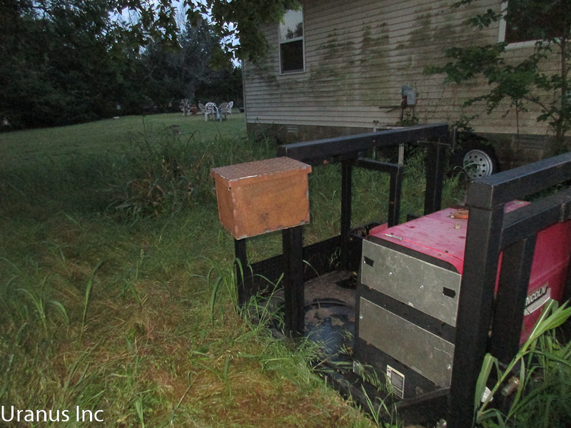

Pull the rat/mouse shields off, and fire it up. Started promptly (whew)

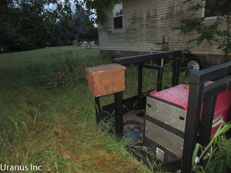

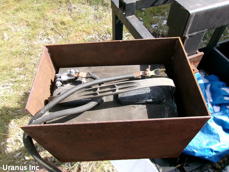

If you noticed the "outside" battery box...................... I can't reach the battery on the welder when it's on the skid. So I decided to make a box for the battery that is attached to the skid. This allows me to run any size battery I want. Regular car battery, commercial truck battery, and the stupid batteries they put in Fords. We can take a battery out of anything if the battery in the box fails. Redundancy is king when it's push-come-to-shove time. You don't want to be messing around when the power goes out in the middle of the night.
I use old "failed" tractor, and truck, batteries. They won't crank a large engine anymore, but do fine for quite a long time on the welder. It's a real money saver.
i'm sure you've seen these pics before................but you know how old guys are. We tend to tell the same story over, and over..........because we don't have a lot of new stories at our age.

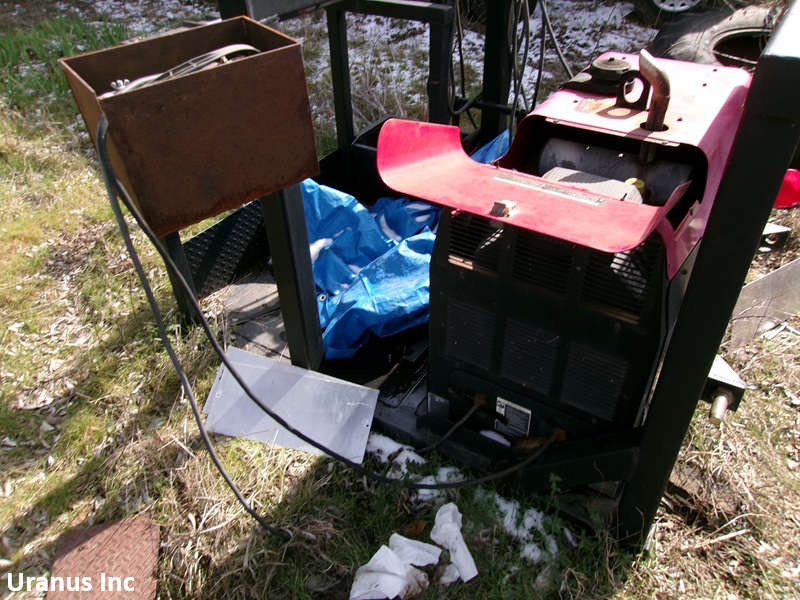

The box is hinged to swing out of the way when I open the motor compartment on the welder. The welder is fully shielded against rodents. I had a very bad experience with rats making a home in the welder.

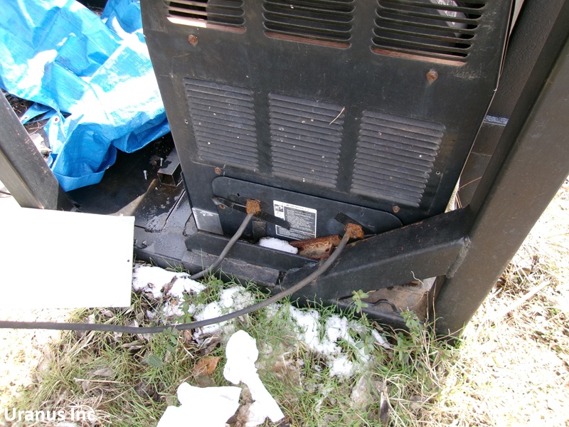

Where the cables run inside the welder, the holes are stuffed with steel wool. Critters don't like steel wool.
