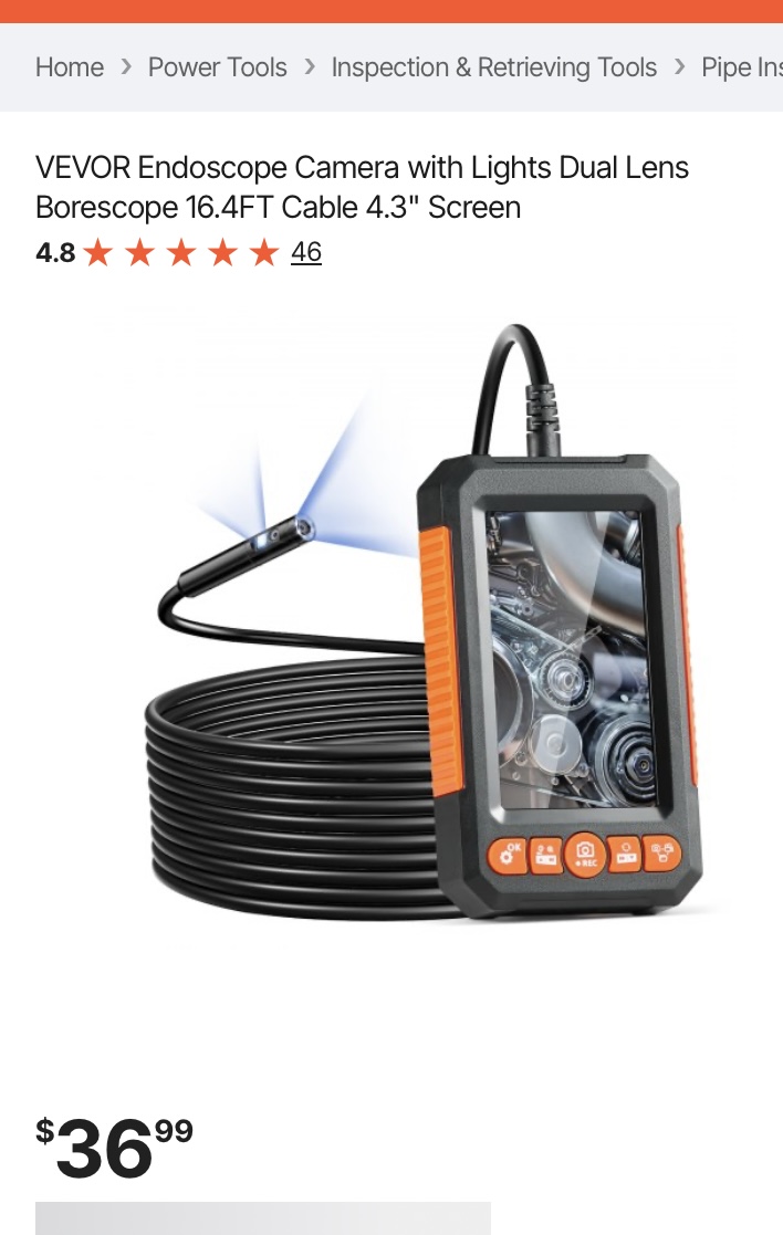

Yes. You can try those things but a basic borescope will quickly let you know what’s going on inside the engine. I see Vevor has one for $36. If your tractor is a pushrod motor then you can look inside the cylinders through the spark plug holes. If not, you can still look at the bottom end and cyl walls from the oil drain plug. You should drain the oil anyway to see if only oil comes out or also water. A borescope is a handy tool for assessing the condition of dead machines.
