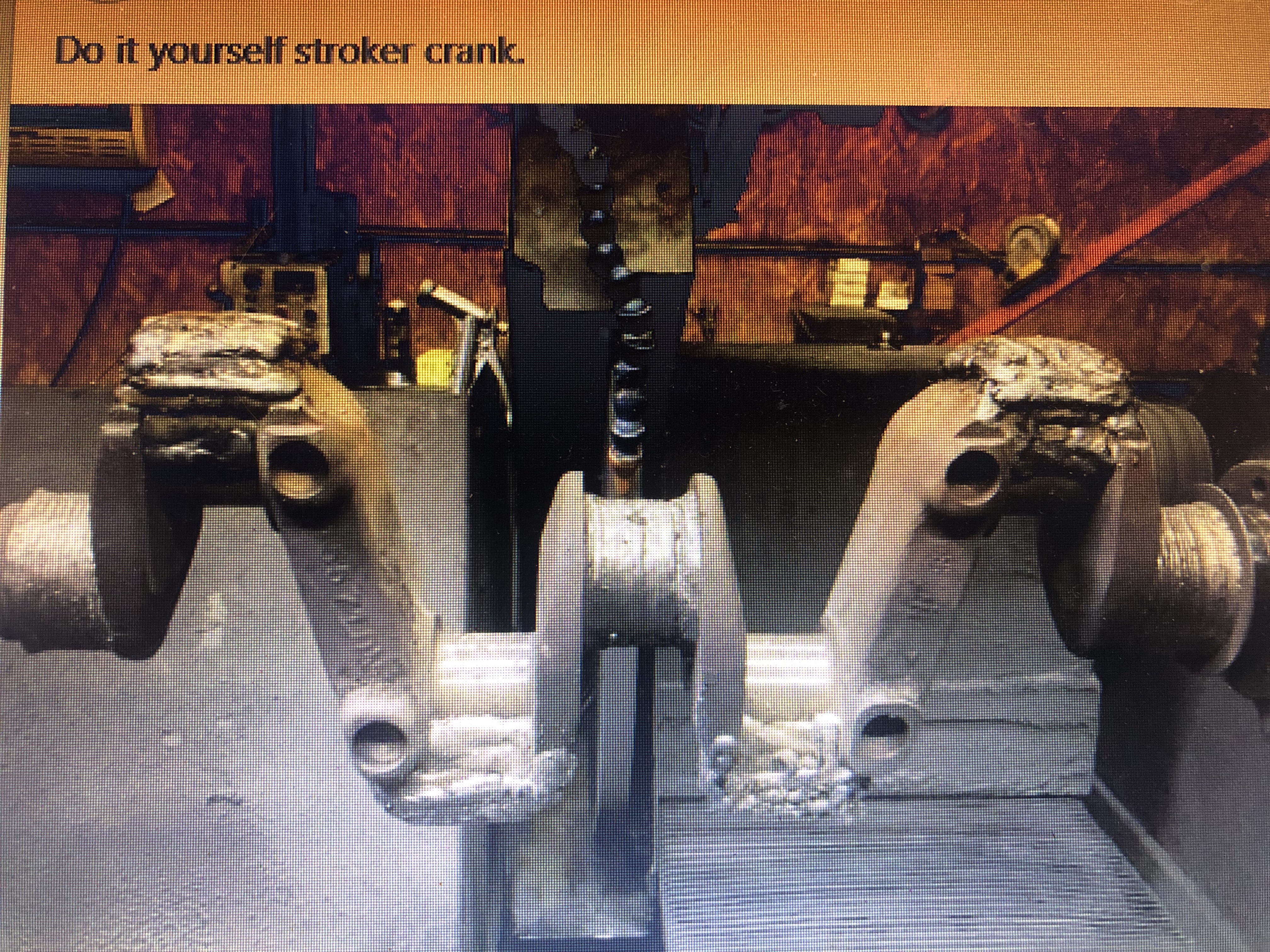

gonna build a stroker crank.
rustred
Well-known Member
is this a good start?
The root of the rewelded areas might be shallow in that the image does not show how the intended journal would meet the existing journal. It will take both machining and grind/polish to get it shaped correctly, then heat treatment and straightening. Start? depends on the massive skill needed to get the crank back to usable and strong. Jim
Stevie, he is pulling your leg he found that picture elsewhere and reposted it. I agree with AMF, the RMS is not quite there.
I looked at the background in the picture, and decided the shop may not be quite up to the task of taking that back down to a useable piece of machinery. It did look like a setup for some laughs though. But who knows. Your results may vary. steve
Seen some Oliver stroked ones that didn't look much better than that when done outside of the journals being smooth. They all look pretty rough when getting welded up.
I think the welder was a lot better when he did the center/left crank pin than he was when he did the other 3.
Looks like a good way to practice building up things like that.
