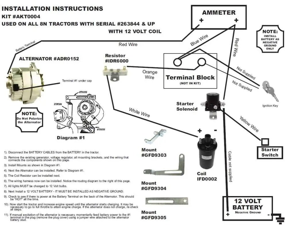

Got 12V kit, lost docs, anyone recognize this?
Years ago, I bought a 12V conversion kit. Somewhere along the way, the docs went elsewhere.
Does anyone recognize this kit, and maybe have the instruction sheet?
It came with alternator, resistor, brackets, hardware and this wiring harness.
Also, it looks like this converts to NEG ground -- won't that make the starter turn the wrong way???

Guessing this is a N series, but which Ford N tractor? If 8N, is it front mount or side mount distributor? The 9N and 2N are just front mount.
Looks like a Delco 10SI one wire type alternator.
Yes, you will need to convert to 12-volt negative ground. Changing the ground does not change the direction of starter rotation, wipe that off your list of concerns.
For now, here is a picture found online for mounting on an 8N side mount distributor tractor.

Yes, I saw that diagram, but it doesn't match the wiring harness that I have.

Hi 1,
The wire diagram Jim posted is what came in kits I've bought before for 8n sidemounts.
Your 6 volt coil will likely run for weeks or months on 12 volts.
If want to use your new resistor, best to check its ohms. If ohms are too high, it will have a weak spark when starter is engaged...
Here is where the 12v conversion wires connect
The orange wire goes to the resistor if using a six volt coil. (This is a one wire 10si, with a 3.0 ohm coil)
When hanging the alt, may have to enlarge a hole to 5/16" on the top bracket to "T" bracket connection,
IIRC.😀😀

I think I have the harness psyched out, it has:
Red1 (Alt to Ammeter)
White (coil to Term1)
Red2 (solenoid to Term2)
Yellow (solenoid pull-in to start switch)
Blue (ammeter to Term2 providing 12V to Term2)
The ignition switch connects Term1 and Term2
The resistor is 3.3 Ohms
HOWEVER, the short Orange wire seems to be on the wrong end to go to the coil. One end has a ring and the other a spade lug (for the resistor). Does this connect to the White lead somehow?
There is also no other lead with a spade lug for the other end of the resistor. The diagram that got posted indicates that a wire not supplied goes to the other end of the resistor, but what does it connect to?
If your gonna run the resistor, the white wire needs a tiny nut and bolt to hook the u shaped terminal to the spade connector on the resistor.( took white off the terminal from the middle pic on post #4 above)
The orange goes to the switched terminal, like this, and to one end of the resistor.
It may start with a 3.3 ohm resistor, it may not. Coil pirmary ohms + 3.3 resistor ohms may not have enough spark to fire up...
I thought this might be how to do the wiring, thanks!

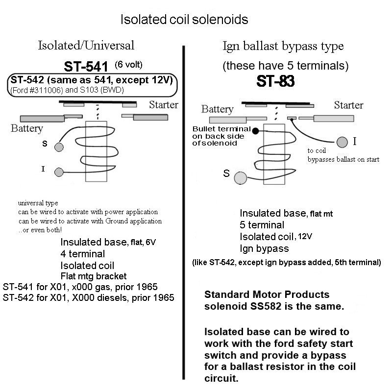

Also, I've had cars which had a straight lead to the coil from the starter switch, bypassing the resistor while getting it going -- releasing the switch brought the resistor into line to keep the coil cool while driving.
